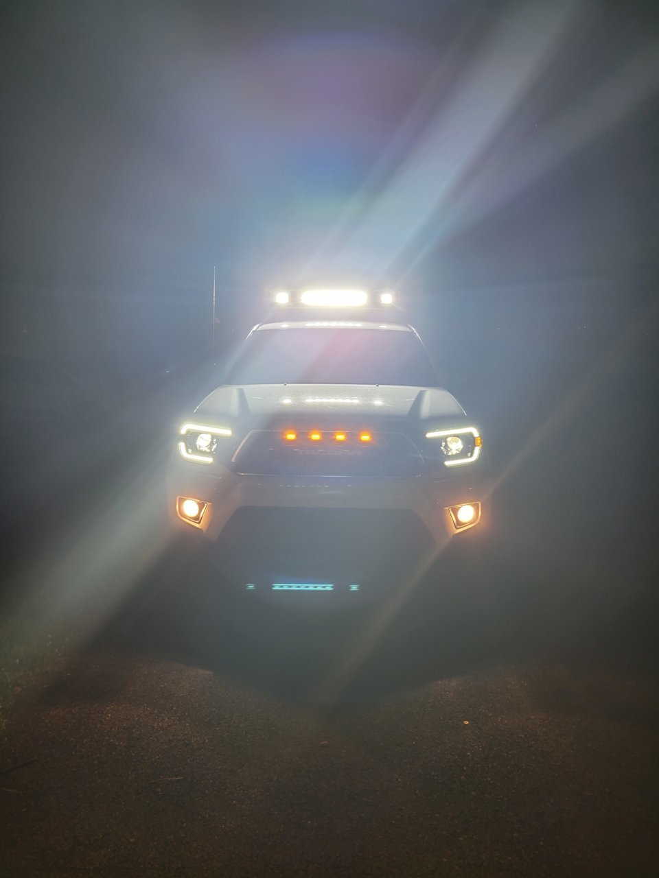

    Got my new Alpharex Lux series headlights installed wirh no problems thanks to the short repin video you guys provided :thumbsup: Love them so far. Can't wait until tonight to try them out in the dark
