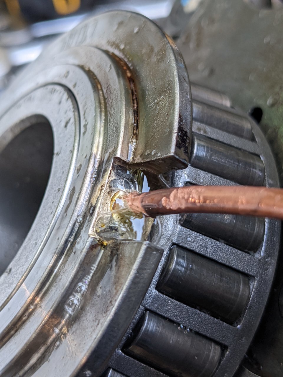

    Ordered new parts to fix my locker from East Coast Gear Supply and..... I'm not happy... I'm starting to see a common denominator..
    I'm not dicking around with ECGS(who would probably send me another part) and just sent ARB Tech an email. They can either send me a new part or have me get one from ECGS, either way it will be documented and I will have it on file if other issues come up.
