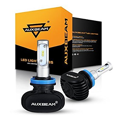

    Put in h11 LEDs in my fog light housing's about a month ago and last night they cut out. Has anyone else came across this problem? Any help would be greatly appreciated! Thanks

    No driver. Just some cheap auxbeam.

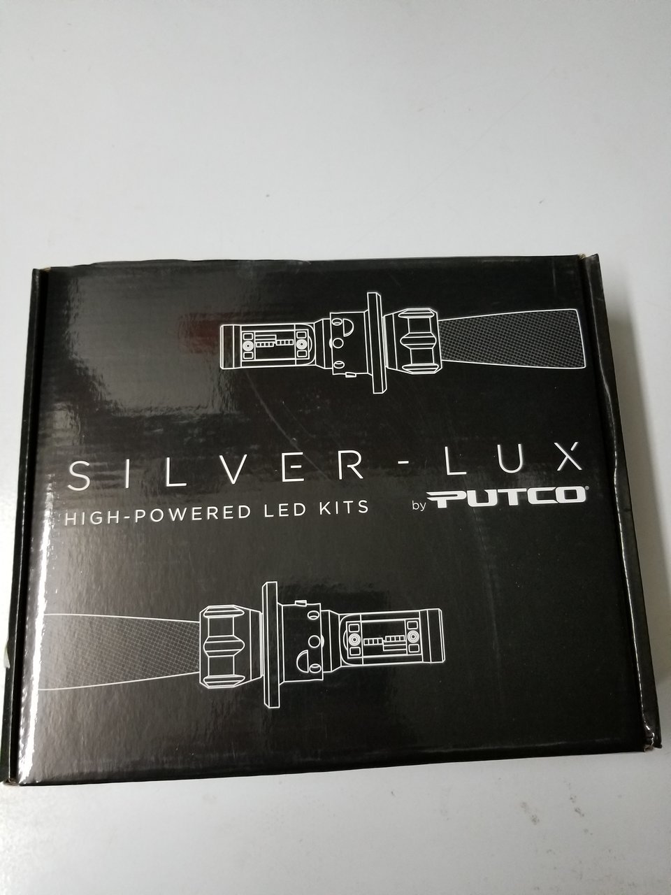

    I ended up buying these for my fogs, kinda pricey ($200) but I can't get myself to go cheap on auto parts.
    Connaghan[OP] likes this.

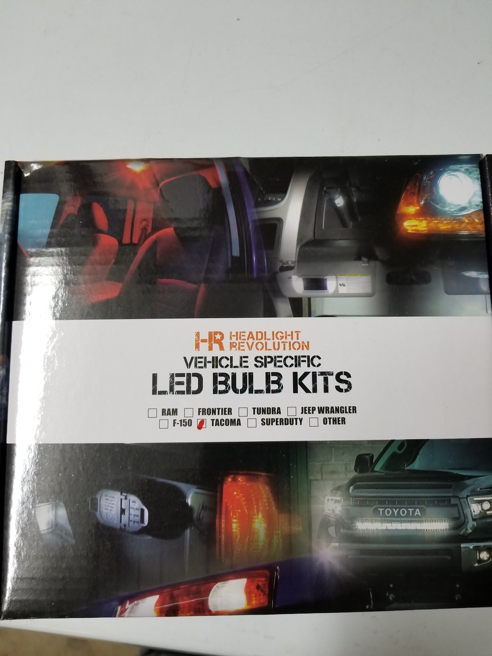

    And these ($139) for my low beams. They tested all the popular brands in a 3rd gen housing for light displacement etc. They have (now) didn't when I bought my low beams a ($200) set that I will put in my low beams and put current low beams in the high beam housing when I buy them.
