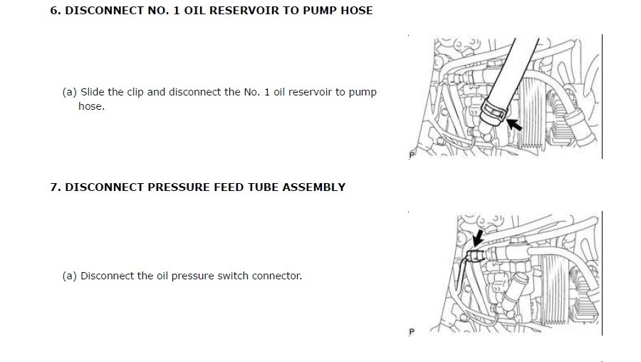

    Here's a pic of that switch...might just be a loose connection.
    Thanks Splitbolt, I will give this a shot when I get out of work.
