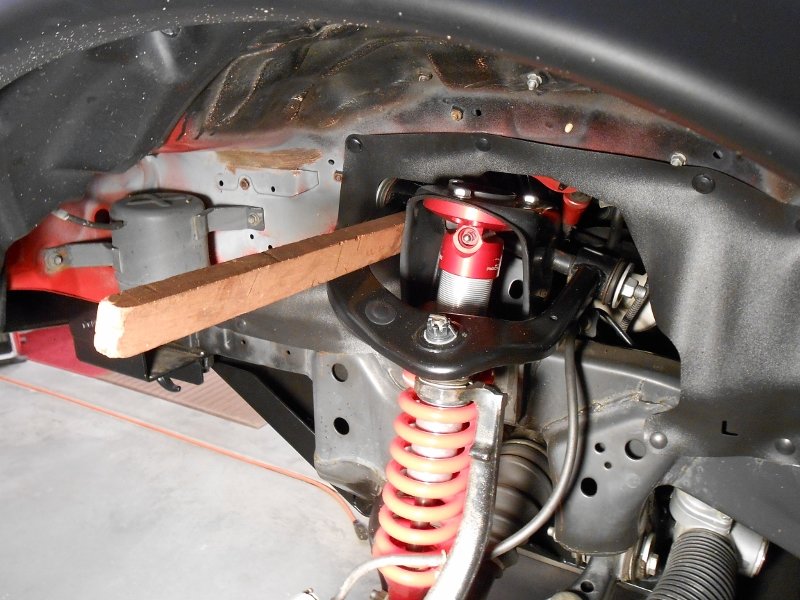

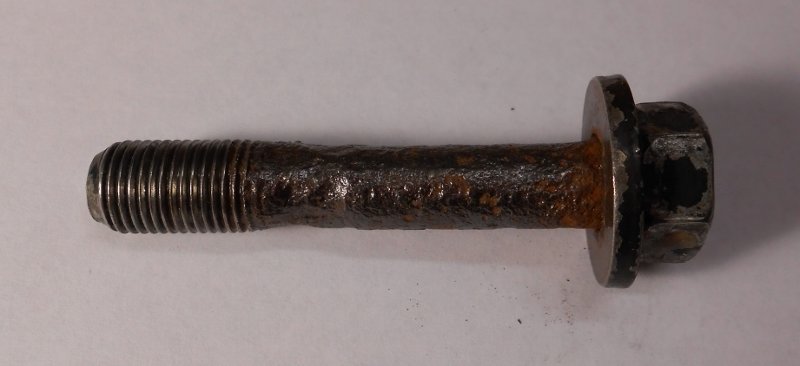

    All that's needed is to disconnect the sway bar and pry the control arm down. Done this a hundred times if I've done it once, on the trail and off. The only resistance is from twisting the rubber in the upper and lower control arm bushings
    If you are spending more than half an hour to R+R both front shocks your goofing off or doing something wrong.
    Unless the lower mount bolt looks like this (cleaned up).

    Removing the LBJ is the absolute longest, most complicated and completely unnecessary method out there once the SB is disconnected.
    I just happened to be doing some seasonal inspection this morning and stuck the "special tool" in place. It's plenty at 18" in length.
    Lean in and drape your arm pit over the end of the "tool" leaving both your arms dangling down to remove/install the lower bolt. Takes about ten seconds unless your ticklish.
