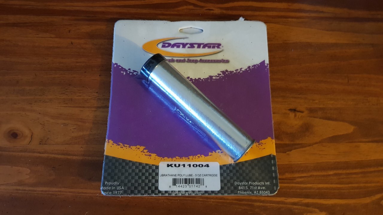

    I ended up going with the Daystar Poly Lube (KU11004) and a mini grease gun for a good deal on summit. One tube was plenty to coat both sides liberally with grease. No more squeaks yet. I can definitely tell the Daystar lube is stickier with much better adhesion than the SuperLube. I believe this was the fix. Thank you guys!

    How does the Daystar grease work with the grease gun? Thin enough to flow through the flutes in the bushings?
