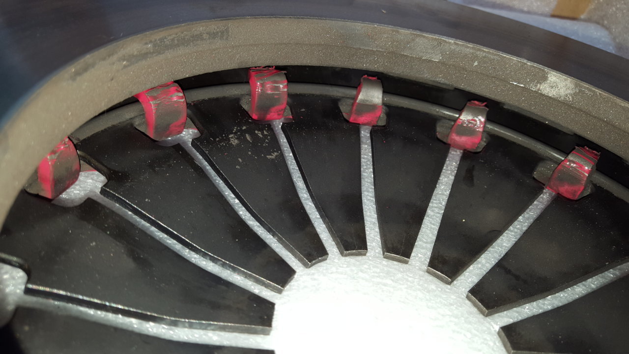

    Welp, truck is scheduled for a second tranny drop at the end of the month (wont go into gear anymore). Between the shops testing and my own we've ruled out a hydraulic issue. We're completely baffled at this point that it could fail in exactly the same way, IE, I think there's a very low chance that two pressure plates from two MFRs could have both slowly failed with the only symptom being that the clutch won't disengage. Right up to the point that it doesn't work anymore, I had no slipping (even at 6 pounds of boost) and smooth engagement.
    I've posted a pic below of the URD Stage 2 pressure plate that came out the first time - The only thing of note is the paint flaking around the retainer springs. URD says this is normal, the shop that pulled it out says it's not. I'm reluctant to even send this back to URD for testing since it costs $100+ to ship anything from AK.
    Have any of the taco gurus out there seen anything like this?
    tempted to go back to stock at this point, but from what I've heard an OEM clutch doesn't last more than 10k on a supercharged rig.

    Just got the truck back... Turns out all of the pressure plate bolts backed out. So that explains the disengagement issues *facepalm* A little embarrassing that I didn't even check those this time around.
    They are ARP bolts and the shop says they were torqued to factory spec when they did the clutch install - What are the chances that all of these bolts backed out if they were indeed torqued to spec? it seems unlikely. This time they're overtorqued to 18lbs and loctited, so hopefully this is a done deal.

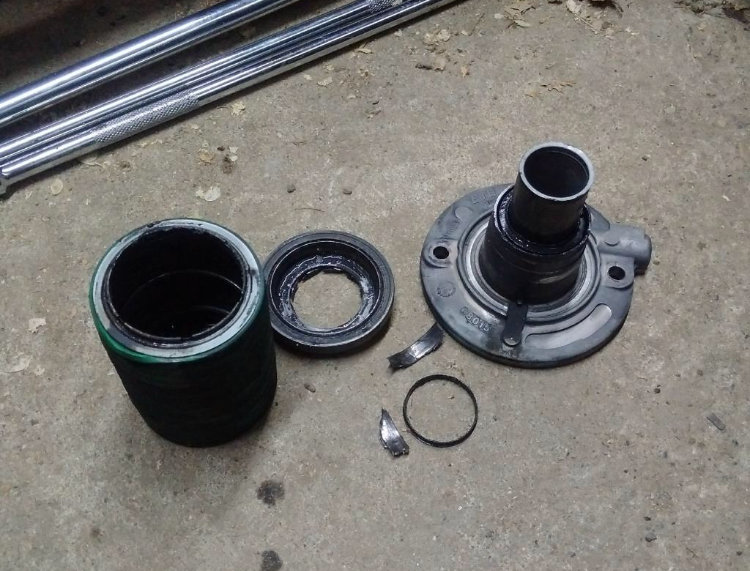

    Just had the exact same thing happen to me.
    My pressure plate bolts backed out as well. Now locktited to 24ftlbs. And look what it did to my TOB...

    The paint peel looks like it jut got a little warm to me cvonhuene.

    Hah! yeah, same shop. They seem honest and knowledgeable and the clutch has worked excellent (at least immediately after installation) both times. Unfortunately there's just not many options up here for reputable mechanics that are willing to work with aftermarket parts :/
    All I know for sure at this point though is that the URD pressure plate (in the image above) worked great for 6 months, at which point the clutch would not disengage. The shop replaced JUST the pressure plate, and it worked after that. I'll be keeping an eye on the bolts for sure though. Now that everything is up and running I'll finally send that pressure plate back to URD and we can find out if something failed.

    I asked URD if the reason they don’t offer it any more is because there were issues, and they didn’t have an answer, at least not one they wanted to give. They didn’t even say yes or no if it would be available in the future. I am stuck with it now because I cut off the quill of the transmission. I replaced the bearing when mine failed due to backing out pressure plate bolts and it’s been fine since... although now only a few days.
    Given that the pressure plate issue was the cause of the failure, I don’t think there’s anything wrong with the hydro bearing kit itself from a design standpoint.

    Thanks. It’s been working great since I replaced the bearing!
