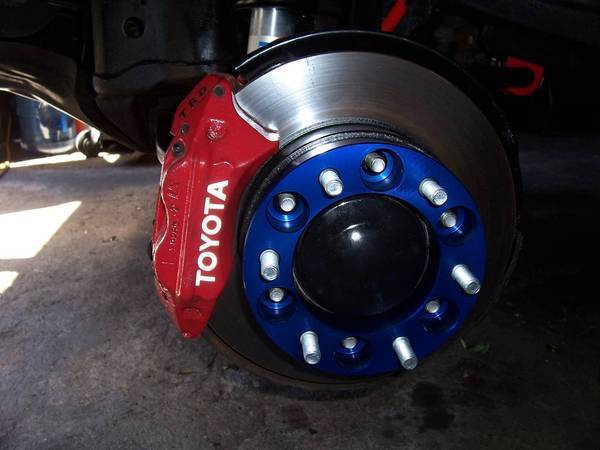

    I had those spacers nothing like these
    • [​IMG]

    these are the way to go if your gonna run spacers!
