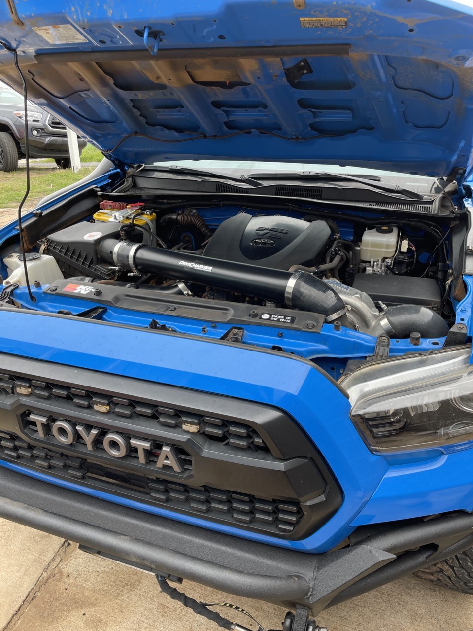

    image.jpg Anyways back story, ordered a Procharger kit. Weeks till I got my OVtune software, kit installed and OVtune software is out of date and will not flash the tune provided by Procharger. Kit partially removed just to daily until software is either updated or replaced with a new one.
    Would have been probably another week or so till I get updates from either Procharger and the company they are dealing with for the software.
    BUT!
    A little Tacomaworld magic put in touch with @RedLantern who put me in touch with @PapaRee. What would’ve been another week in an already frustrating/disappointing week was solved in about a 20 min phone call.
    Now I’m officially boosting around in a Procharged Tacoma.

    Procharger claims about 35%to 40% over stock but I have yet to go play on a dyno. Luckily out here in Maui Hawaii we just got a shop set up with a dyno so I may just make an appointment so I can get some numbers on paper.

    A little know how and some basic tools and you got installed. The only “specialty” tool you need if you don’t have access to an air compressor is and 18v Milwaukee 1/2 impact and a 22mm socket.

    Give u an idea from another member in colorado who went on the dyno
    tune was great I’m in Colorado so I went with a 3.40 pulley instead of the 3.60.
    Runs at 7.5 psi
    Put down 341RWHP/303torque
    It’s also the procharger off the self tuned through OV
    You definitely will be limited by the fuel pump to be putting down more power but im sure over 300+ to the wheels will be fun enough, also depending on how the curve goes too! Im sure it will be great! Sick setup
