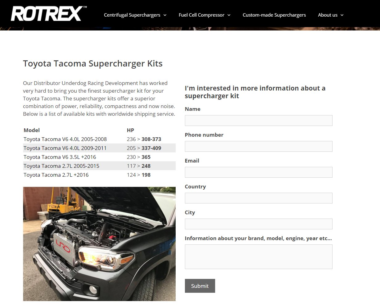

    Awesome man thanks for the answers, I'm also wondering what happened to URD lol they claimed some impressive numbers but centrifugal efficiency seems to be outperforming magnusson by a longshot. The more competition the better!

    That 4cyl one never see v6 one on the site yet
