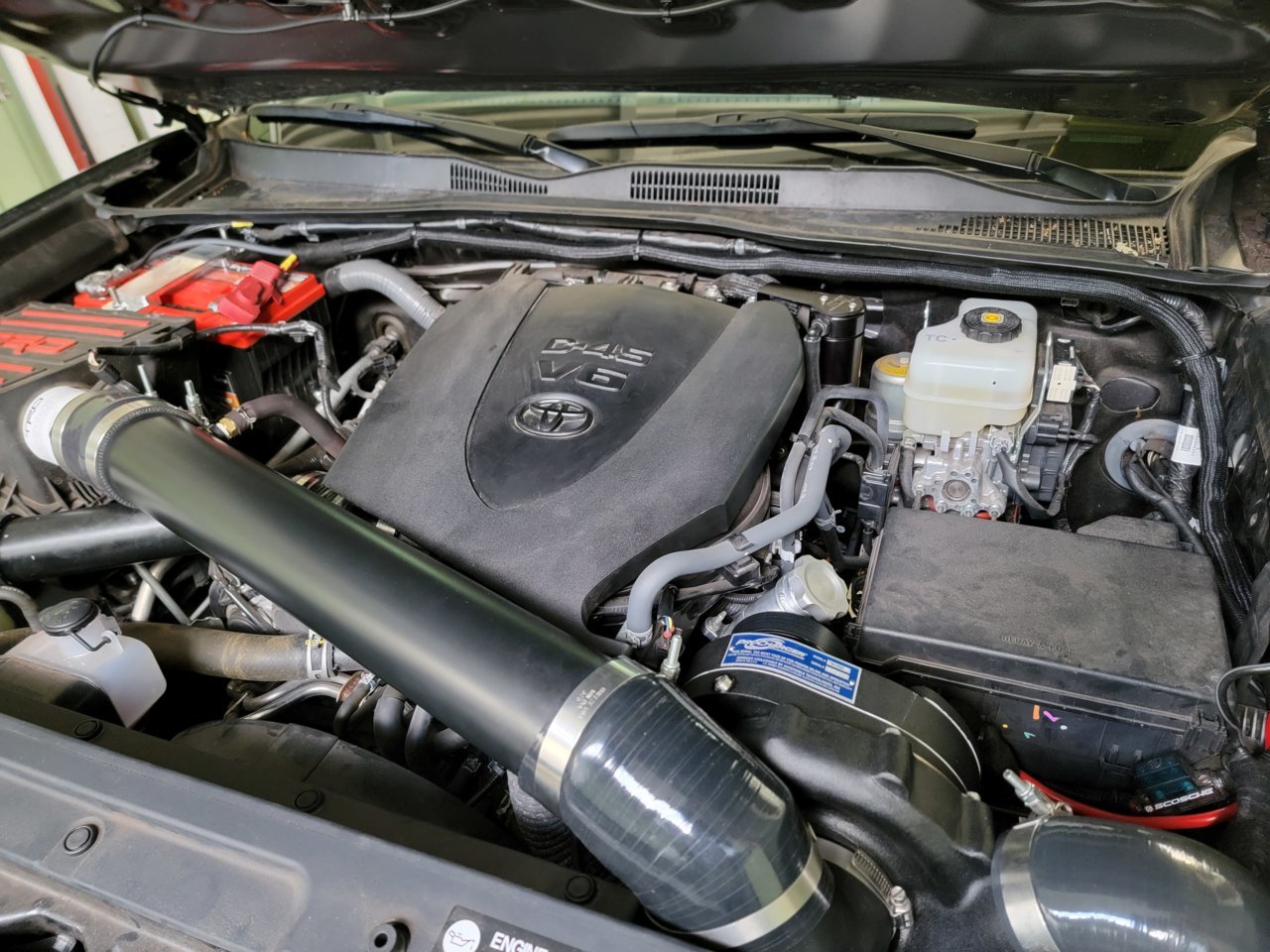

    Just got my procharger installed too, feels a LOT better than stock!
