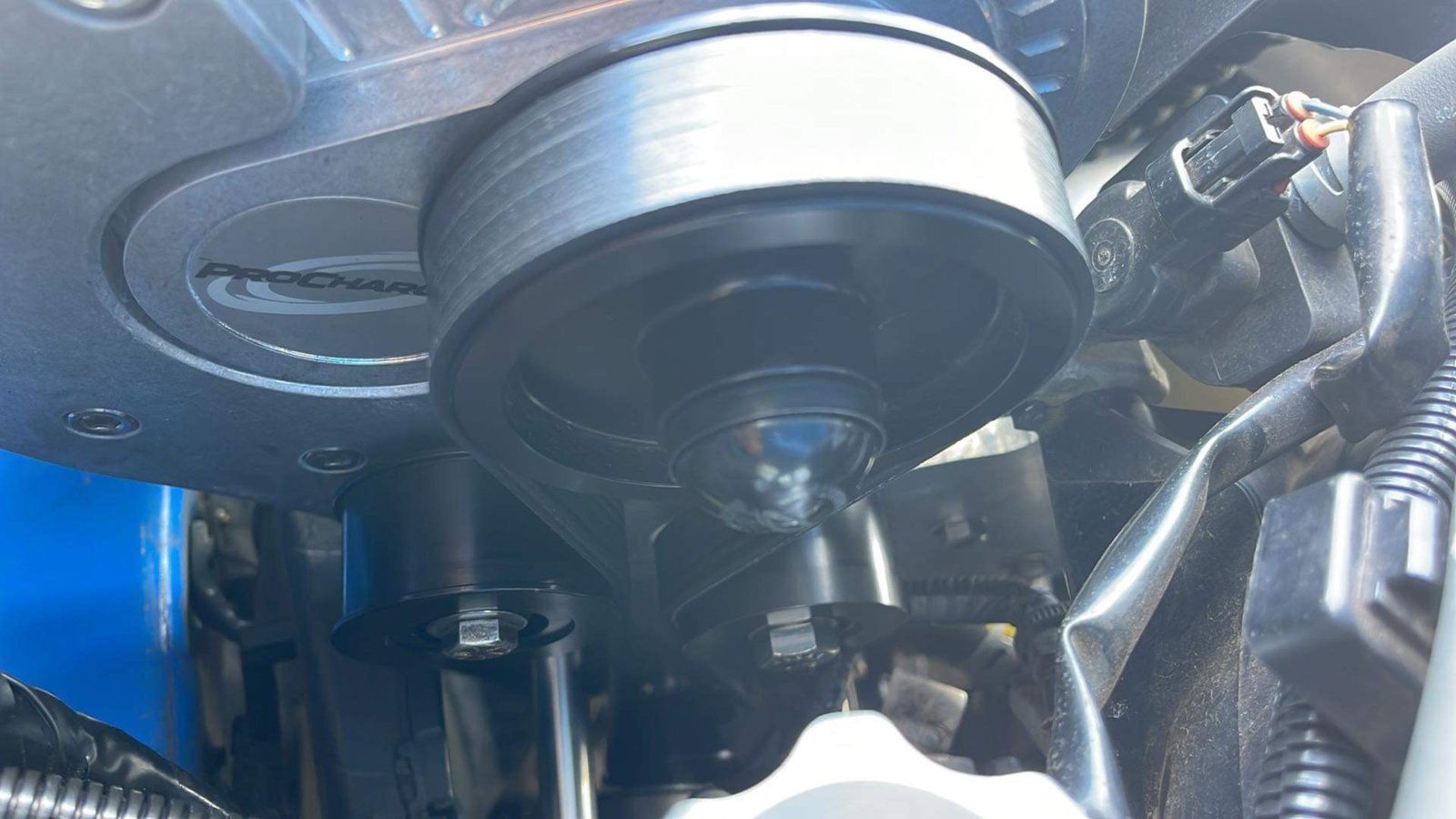

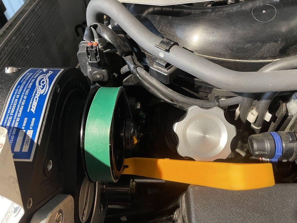

    Just finished installing the Procharger kit. I wish I saw this video before installing the belt: ProCharger 101 - How to Choose and Tension Your Belt
    I'm running the k060658HD belt. Here's the gap between the idler and tensioner on day of install. I'll compare the gap when it hits 500 miles. It's going to stretch but I'm not concerned. Next time I'll try removing the idler below the SC pulley during install.
    The k060658HD belt was a b!tch to install with the idler in place.
    With the fan out, I was able lock the tensioner out of way with a 1/2" breaker bar and a rachet strap hooked to the sway bar. This allowed enough slack to get a few ribs hooked onto the far side of the SC pulley. Finished seating the belt by applying pressure on the belt with a plastic trim tool while rotating the crank pulley counterclockwise.
    Note: It took less than 70 lb·ft to rotate the crank CCW with plugs in and the trans in neutral.

    I had to trim quite a bit to make it fit with the LED headlight. As for the belt if you take off the idler pulley and the pulley from the tensioner it makes it was easier to get it on. You can throw a socket on the crank pulley and just turn it until the belt goes on instead of trying to pry it onto the supercharger pulley
