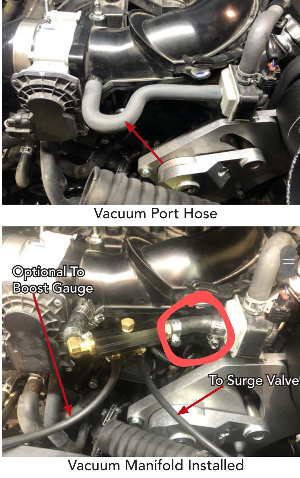

    Well for those who want an update here we go:
    If anyone with has a procharger and is experiencing these issues or has fixed this type of issue please reach out to me! :bananadead:
    about 7 months ago my truck was having codes for cylinder 6 air fuel mix issues. My thought was valve issues. Had a shop do a compression test and cyl 6 showing about 100 - the rest were a bit higher so decided to just go ahead and get the valves "upgraded" to better ones since I have read people having issues with stock valves. Well...took 7 months due to the head builder "waiting on the valves to be machined". Picked the truck up yesterday and headed home, drives perfectly fine casual. No boost or even just gradually letting the boost climb it seems to drive and pull fine. The moment I introduce fast boost in about 3rd gear the truck throws misfire code and that cyl 6 air fuel mix code and goes into limp mode. I have to pull over and restart the truck to get it out of limp. I proceed to drive it normal and casual with no issues, shift down to throw the boost into it and I can began to feel the truck want to bog down and stutter so I back off the boost and engine goes back to driving fine. I'm at a loss, honestly just feels like a possible tune issue? I just purchased VFTuner to get in and see what's happening. Never done any tuning so looking at some guides around here to see what to look at. My assumption is my tune is really close but maybe timing gets off once there's too much air coming in to fast or a lack of gas when that happens. Maybe just not shock it with boost but what's the fun in that? I've replaced most things, just dropped a bunch of money on that valve rebuild...so at this point I'm frustrated and hoping its something that can be tuned out.
    The head scratcher for me is the first tune I got from Yotawerx back when procharger was fairly new and not many tunes were done yet ran for about 5k miles fine - Huge difference over the tune that came from procharger. Yotawerx guys are awesome too! Then I started to have cyl 6 air fuel mix issues. I saw that the Yotawerx guys had recently got a truck with the procharger on dyno and my hopes was that the tune that was done for him would fix my issues. They sent me the tune and even though it felt much better the air fuel mix issue popped up again however it never caused limp mode. After discussion with them we all decided it probably needed a compression test. So here I am 7 months later with the same issue except now its rougher idle, throwing a misfire code which is causing limp mode and still having cyl 6 air fuel issues. I've replaced most sensors related to these types of issues. Seems completely boost related. I would assume IF there was an actual issue with the cylinders it would misfire/bog with casual driving too.
    Update:
    Might be unrelated...but I noticed that the purge canister hose was kinked to the point where I'm pretty sure it was pinched off. Don't know if this could cause all the problems but I fixed it and have yet to drive it.
    Update:
    No change with the hose fix. Looks like getting to the injectors is a pain. Just dropped the truck off with the shop again to have all injectors cleaned and to replace cyl 6 injector. With the code consistently being tied to cyl 6 this is my last resort before setting the truck on fire in the woods.
