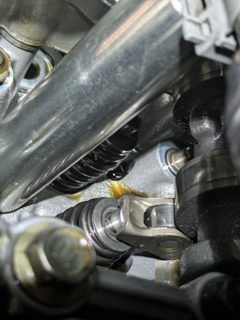

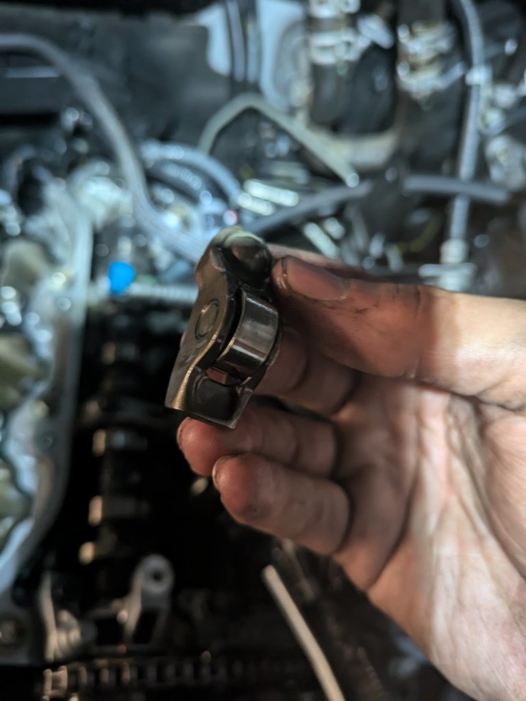

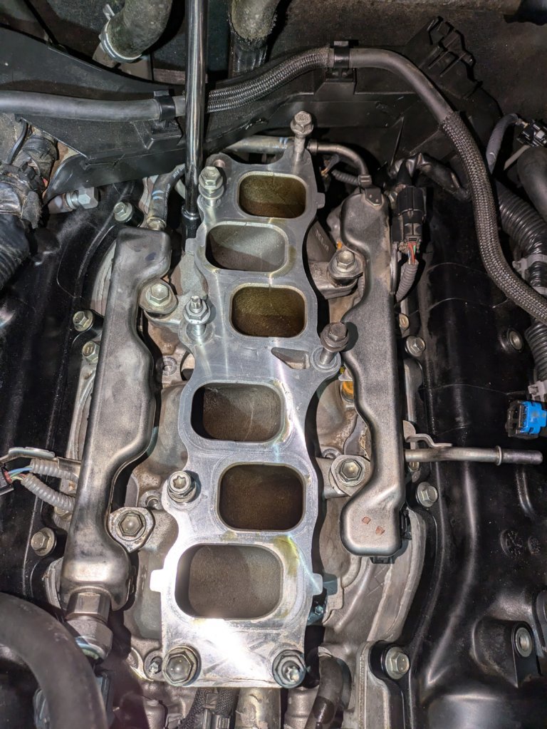

    PXL_20240929_161548203.jpg PXL_20240929_183505273.jpg PXL_20240929_183440334.jpg
    I've been trying to locate a bottom end. My heads had work done to them so trying to salvage those. I think there's some crossover engines like out of a Lexus that I can swap all the fks assemblies and heads over to and open my options more but still researching that.
    I also had cyl 4 rocker arm thrown.
    Whole right side looked weird too. Intake on those cylinders had oil stains.
