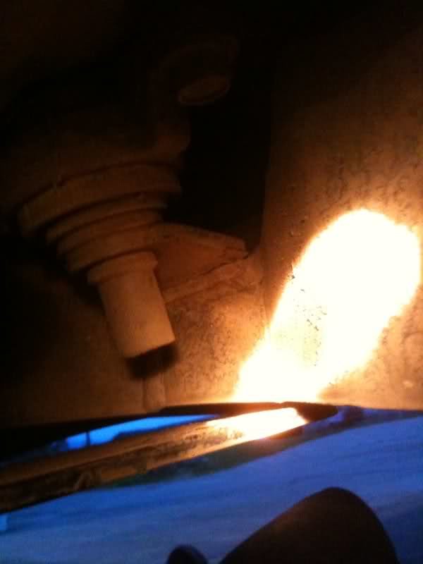

    I will take a pic in a few minutes, meanwhile, here is the carnage from an ungusseted
    one.
    This:
    Led to this:
