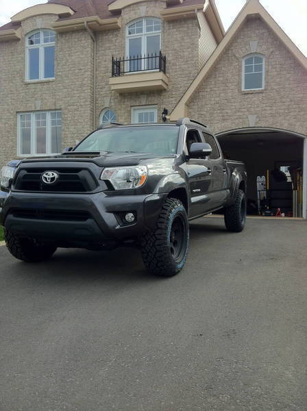

    I searched a lot for a clear photo and information about Procomp's 7069.
    Since I don't see OP's photos I am going to go ahead and post mine:
    These are Procomp 7069 17x9 -6mm offset. You WILL need tuner wheel nuts for this. I am pretty happy with the result.
    Tires are Duratracs 265/70/17. My suspension is bone stock, and I had to remove the front tab and the mudflaps on the front because it was rubbing.
    Hope it helps others like me who searched a ton without finding too much.

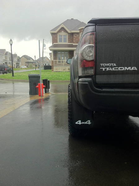

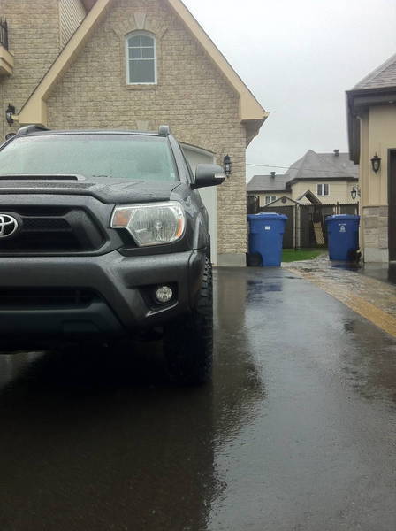

    624
    Looks good. I got a different brand on the way with -12. How far would you say it sticks out? Do you have a straight shot from the front?
    Thanks.

    Here you go!

    Very nice. I got my rims yesterday. Tested fit the rims only and it was sticking out more than I would like (17x9 -12).

    I don't know what 6mm more would look like! I think this is the perfect fit for me!
    Glad it helps! Post some pics when you are done :)
