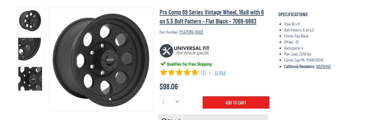

    I’ve got these in the 16x8 variation and THEY DO CLEAR THE CALIPERS. Got them from 4wheel parts and they were helpful in showing me service logs of them clearing calipers since they can access there company logs.
    I wanted to avoid spacers as well and was hesitant on them but they are working out well!

    What is your offset for the 16x8 version?

    -12 is what ive got with 4in of backspacing

    Sweet, i prefer sticking with 16's and am looking into this wheel for my DC 4x4 - was concerned with clearing calipers and\or rubbing though, especially for offroad use.

    I would hold 4wheel part's feet to the fire and make them put one on your truck to assure that they clear the caliper. Seems every truck is different, here's mine with them on with 33in bfgs. Went on a big wheeling trip in east texas and they held up great. Ive got about 2 credit cards distance between the wheel and the caliper. If you are about to get new tires, you could get the 17in ones for a little more clearance.
