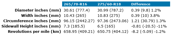

    I want 18 in wheels, 18x9 with -12mm or 0mm offset but I can settle with 18x8 or 8.5, and I want 275/60/18 or 275/65/18 tires. The 275/60/18's are very close in size to stock,
    from the online tire size calculator
    Am I off my rocker to put this tire/wheel combo on a stock suspension with a 5100 level on the front?

    they dont mention wheel size cause most people stick with their 16's. if the diameter of the tire is the same and your not changing the width the rim size makes no difference if all the other parameters are the same or = to the max allowable diameter

    I'm running 18x9's with +10 offset (approx 5.4" bs) on 265/65/18's with no issues.

    I have the billy's at 1.75" and TSB rear. Doesn't look weird at all....
