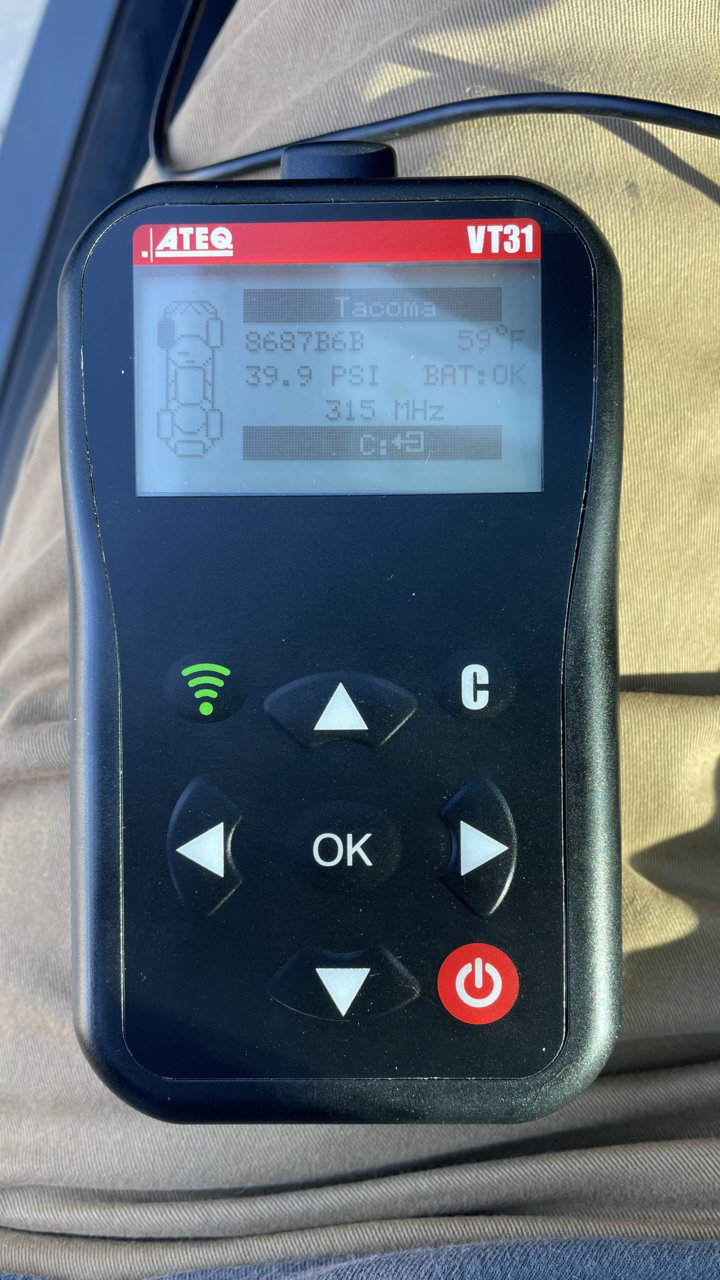

    I installed a new set of wheels today with new tpms sensors. I have added the sensor IDs into techstream and drove around probably 20-30 minutes but my tpms light is on solid. The sensors are BH Sens, the same ones that Discount Tire uses. I noticed my OEM sensors were 7 digits and the new ones are 8 digits with two leading zeros. Techstream will not accept an 8 digit ID so I dropped the leading zeros, is this correct?

    After doing some more research I think the sensor ID that is on the sensor is not the actual ID. The BH sensors are universal and ship "blank". The place I bought them from 'pre-programs" them before shipping and that process is what created the IDs. I ordered an ATEQ tool so I can see the actual sensor ID they are broadcasting, once I have that I believe I can get it to work.

    Just wanted to update the thread that I did get it working. My theory was correct. My ATEQ tool came today and I was able to read the actual sensor IDs and then program them in techstream and the light went off and pressures showed up.
