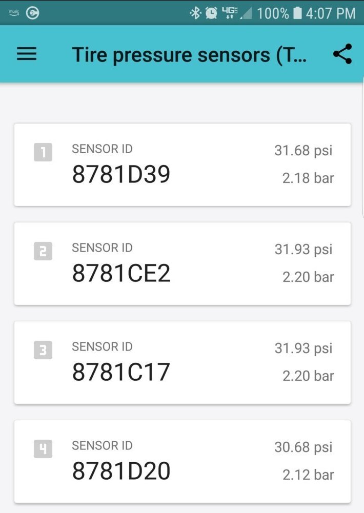

  13. Oct 20, 2020 at 5:31 AM
    tonered
    tonered bartheloni
    Sep 25, 2017
    #231055
    31,156
    tony
    Lynnwood, WA
    You need the sensor IDs. The wheel / sensor location is unimportant as the system figures that out. The Carista app or TechStream can program the new sensors. Be sure to write down the old sensor IDs before you overwrite them!
    Everest[QUOTED][OP] and pinochle like this.

    If you sold your original wheels, with the TPMS in them, and want to get TPMS for a new set of wheels... What needs to be done? Anything different since you don't know the codes off of the original TPMS?
  17. Oct 20, 2020 at 7:12 AM
    #17
    tonered
    tonered bartheloni
    Sep 25, 2017
    #231055
    31,156
    tony
    Lynnwood, WA
    If you don't have your old sensors, it is no big deal. You just need to enter the new senor IDs:
    Stigman[QUOTED] likes this.
