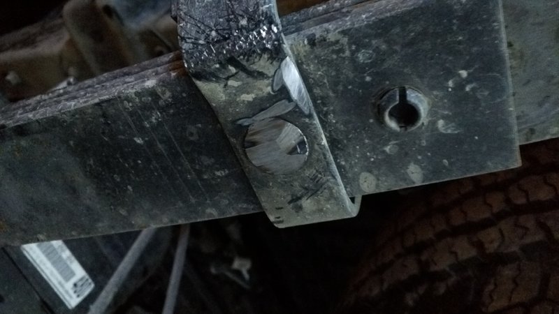

    Trying to remove the clamp that's in the way of the 3 leaf AAL. I'm grinding down the rivet but not sure what it should look like when completed? Do I need to grind more or? Can't seem to find any pictures of the actual process. Just "grind off the rivet."

    You need to grind that clamp off from the leaf springs and the rest of the rivet until it's flush on the leaf springs. Spray the bare metal with some black paint. That's it!

    13 TRD Sport Double Cab Long Bed
