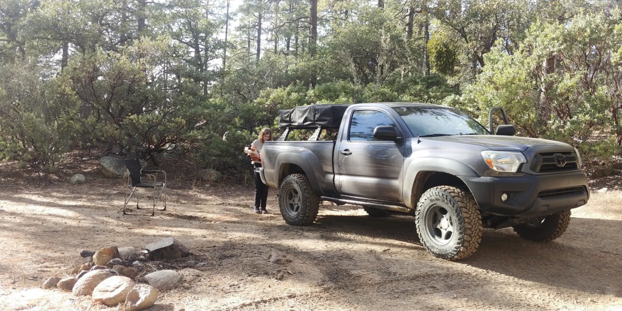

    When I bought my truck it had a single AAL. I was forced to change them.
    Then I went with a set of progressive leaves. They were good for about a year but couldn't take the abuse of where I was going with the weight I was running and started to sag.
    So I now I'm on a set of RXT springs. These are perfect for me and what I do.
    So the real issue is you need to be honest with yourself. Are you frequently going camping and carrying a load? Are you going to be mall crawling? Just don't waste your money either way...like I did.

    When you say towing I see new springs in your future. Watch for a good set of used ones here, or on CL. I paid WAY less than $1k for mine.
    Edit: I forgot to mention that the progressive AAL rides better than the single leaf. The RXT springs ride night and day better than either of the AALs, loaded or unloaded.

    I do camp with a pretty good load several times a month during the summer. When I camp it involves a lot of off road travel with the roads getting progressively worse, so I can be alone. I don't like Razors buzzing by me constantly. Generally I have 200 pounds in my truck all summer, with I'm guessing probably 800ish when I hit the road to camp. This my typical load, except the ice box and food is not in there yet.
    Edit: I feel the abuse comes into play with a fully loaded bed and a rough rocky trail that extends and then fully compresses the leaves to the bump stops.
