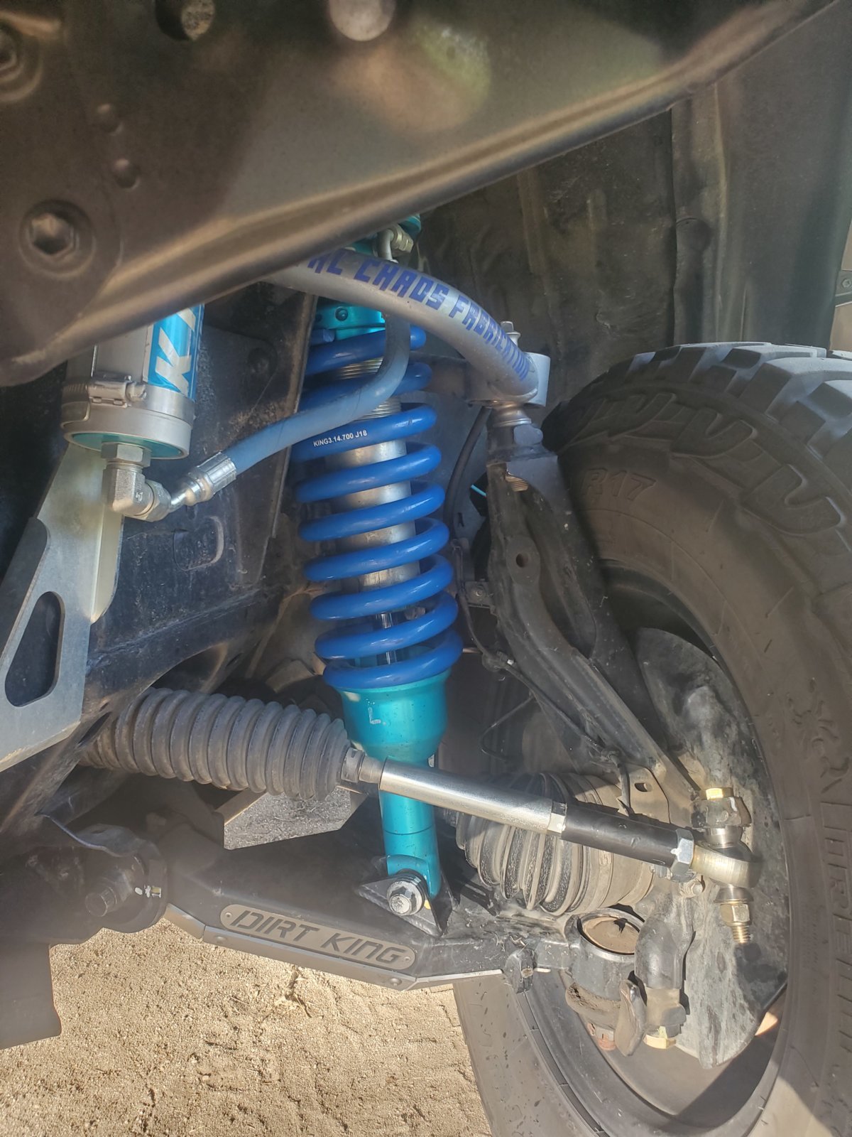

    what extra maintenance comes with high performance coilers? Considering getting Kings

    Depends on how you use them. Daily driver, crawler, or race truck.
    I got 30K on mine and plan on rebuilding them this year. Seals are still good, but could use an oil refresh, so since I will be tearing them down, might as well replace the seals and anything else they might need. Kings rock, truck rides like a dream.
    71tattooguy, TVH475 and bkhlrTaco's like this.

    There isn't any kind of extra maintenance outside of the need to rebuild? Your 2nd get looks amazing by the way! Super clean.

    Maybe a slight adjustment of the Coilspring when they are first new. Other than that, they are super flexy and you will definitely see a difference in ride and dampening.
