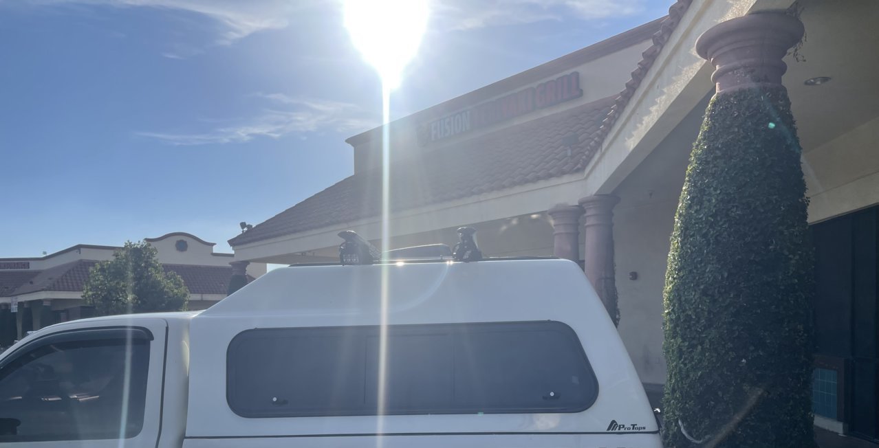

    @YotaGangYotaGang nice! I'll probably go with a high rise shell like that for 1st iteration.
