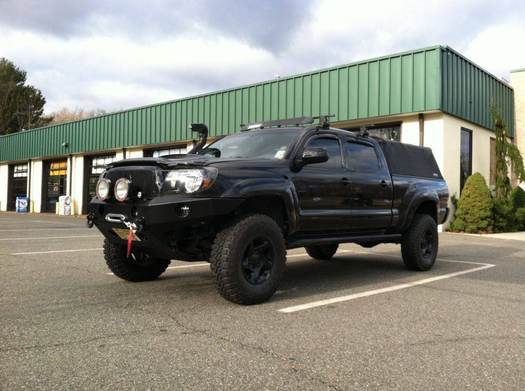

    Yep I love mine too.. Maxxis bighorns in 255/85/16. I get the same gas mileage as my 265/70/17 duratracs. The 255s definitely throw off the speedo and odometer though.
    This V. The number doesn't mean the height of it.
    And that's the truck that made me decide to find some 1st gen alloy wheels :D
    Can't link pics from my phone but if you look at the last page of my build thread there's a pic with the new tires.
    And as an added bonus they don't rub the cab mount like 285s do.

    Thanks for posting the pic!
    Yea those wheels are nice. Can usually be found pretty cheap too.. I've seen them for $100 a set. I got mine with some worn out stock size tires but I ran them for a month when I had a lca issue which threw out my alignment bad enough that it would've killed my good tires.
