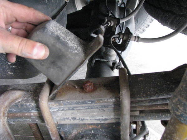

    i just ment the bumpstops i got......i may bolt them to frame instead of welding to flip kit

    I welded mine to the flip . No issues so far .

    i think the 4in bumps should be perfect to hit a touch of neg arch with shackle flip which is perfect

    Bolt to flip kit w shim. I'm thinkin I'm gonna go some sort of hdpe, maybe delrin about 1 1/2" riser

    with a shim???

    Shim up w (like I said I'm going to use) HDPE sheet or Delrin. Both have excellent crush resistance. You will never need to replace, unless bolt holes gouge out for some reason, like if someone were to run REDS... :rolleyes:

    But since they're 4 in, may just go 1/2"-1" (max) shim...

    i was looking at them.....dont think ill need them with 4in stops though

    you wont.

    what do you mean? for real. How do you weld rubber ? Not being a smart ass. Doing the flip kit on mine soon.

    The base of the bump stop is metal, the part that is held down by the u-bolts

    Gotcha, should have known. Did an add a leaf 7 months ago. Brainfart. I'll probly go that route

    still need to figure out my rear bumpstops
