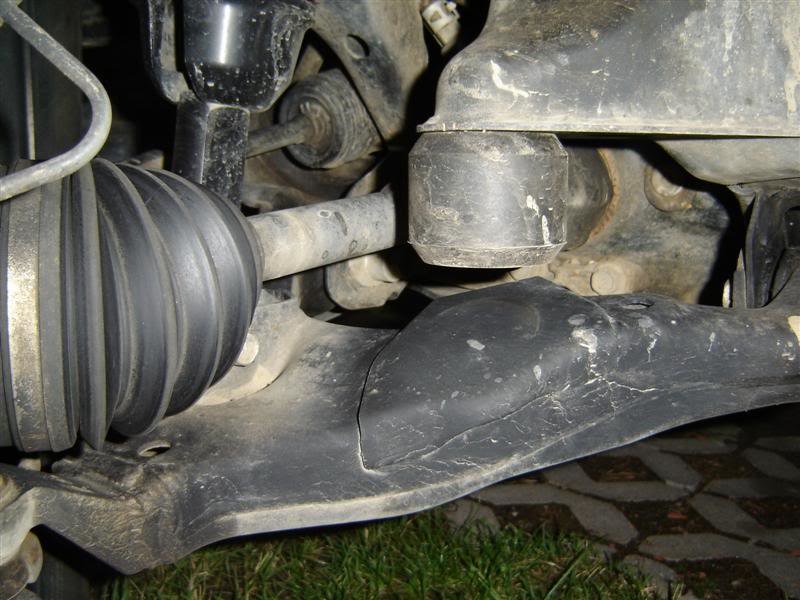

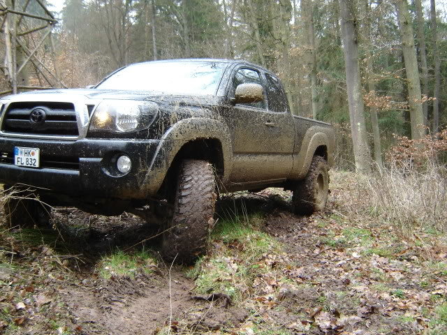

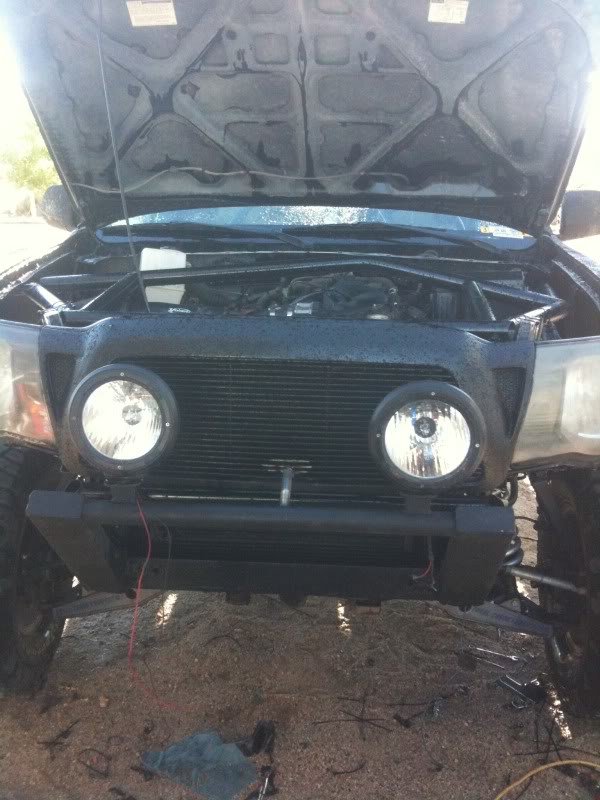

    So a bunch of you dudes asked for a build thread, so here it is as I can remember it. I bought it when I was stationed in Germany (Army) and before it got there I already had a pile of parts waiting for it. Initially, I had Icon coilovers and deaver AAL's with TC UCA's.
    Then I beat on it a little.

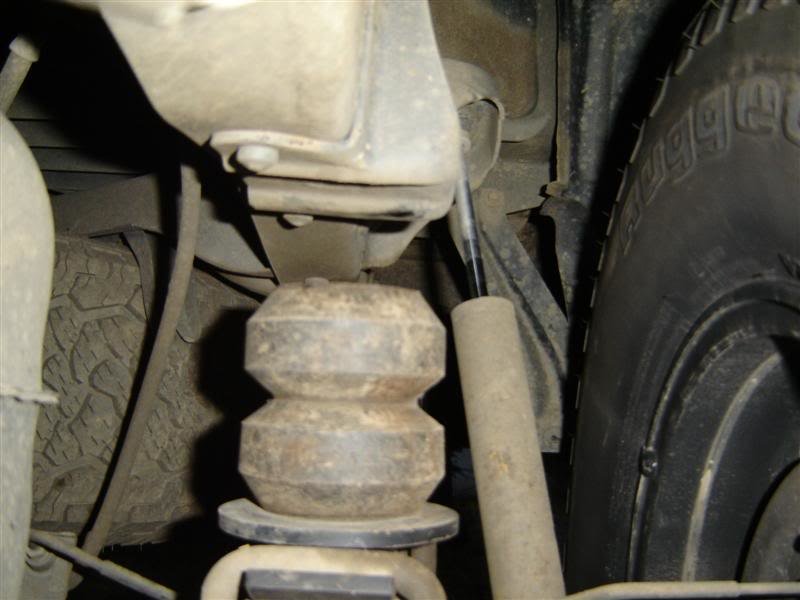

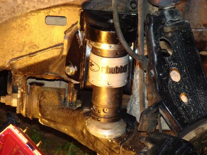

    Put on some Timbren bump stops all around.

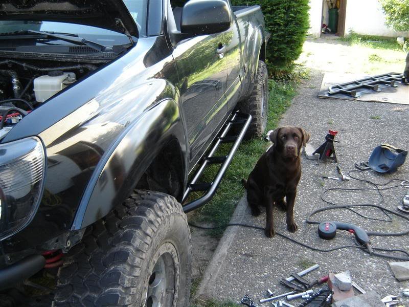

    Fried up some driveway sliders-
    Beat on it some and figured out timbrens are not real bump stops.
    Put on some chubbies aka lightracing jounce shocks--
    Beat on it some more.

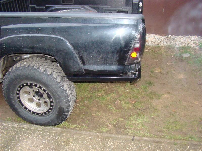

    Fried up a new rear bumper-
    It worked ok.
    Welded more crap to the front bumper-

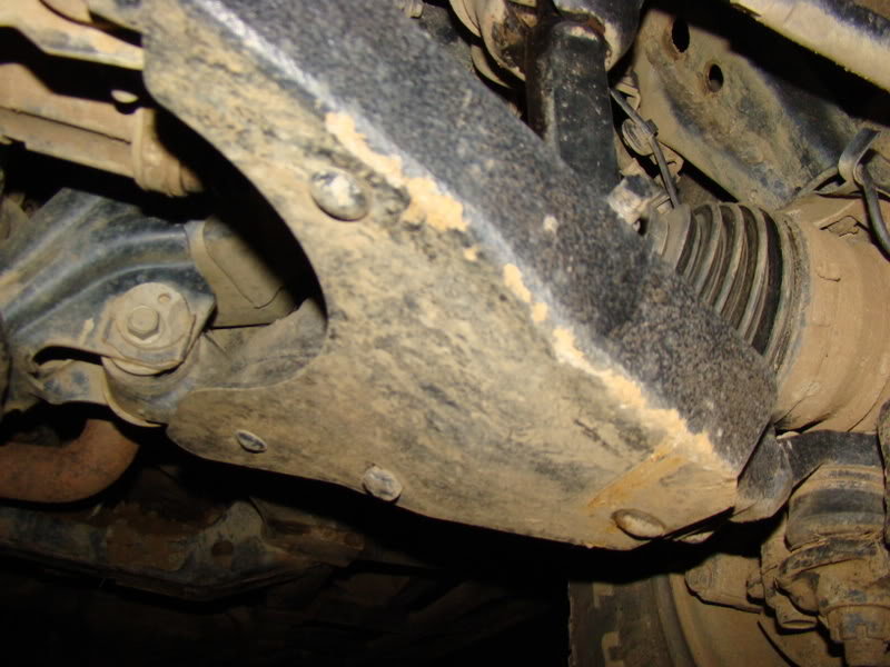

    LCA skids-

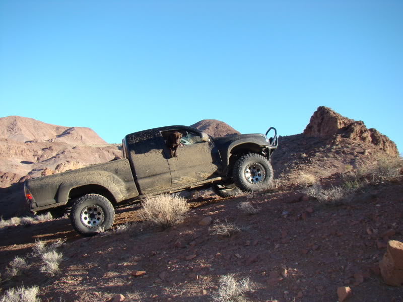

    After going on the Miller jeep trail run with an LT 4wd that was it, I started looking for parts after that weekend. That truck did very well in the rocks, and it was fast!

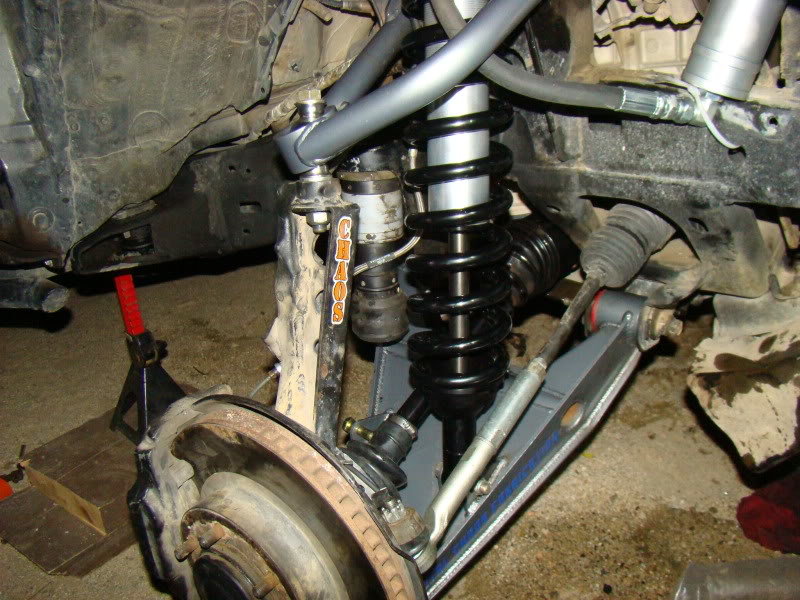

    Then I stumbled onto a used TC kit and snatched it up. The coilovers are LT Icons and one of the first sets out there.

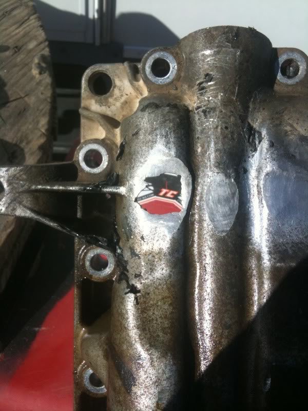

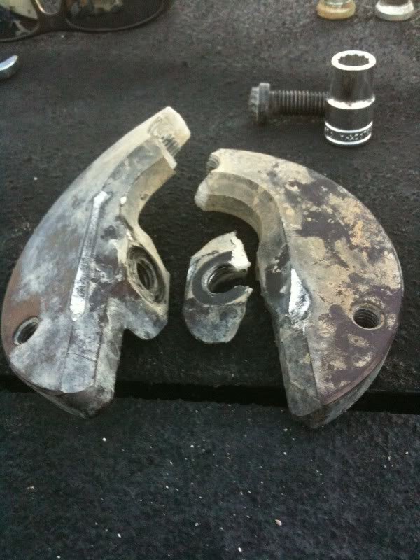

    The motor mounts broke somewhere in there-
    I think I just had a deaver 10 pack at that point.

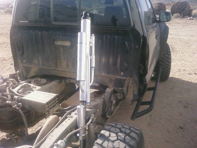

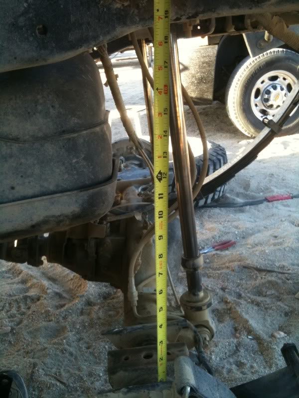

    Then I went to the offroad expo and talked to some dude's from Radflo who hooked up the rear with 18" stroke triple bypass 3.0's and some 4" stroke bumps.

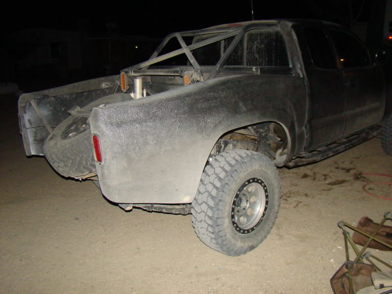

    I read in some racecar chassis design book that triangles are the strongest geometric shape, so I built some triangles.
    I also put on some deaver H70's spring under hung off of TC 12" shackles. I had to undovetail the frame, but I made it happen.
    Then it cornered like it was on rails.
    That bumper sure did look dorky, but it saved my arse a couple times.

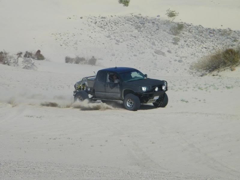

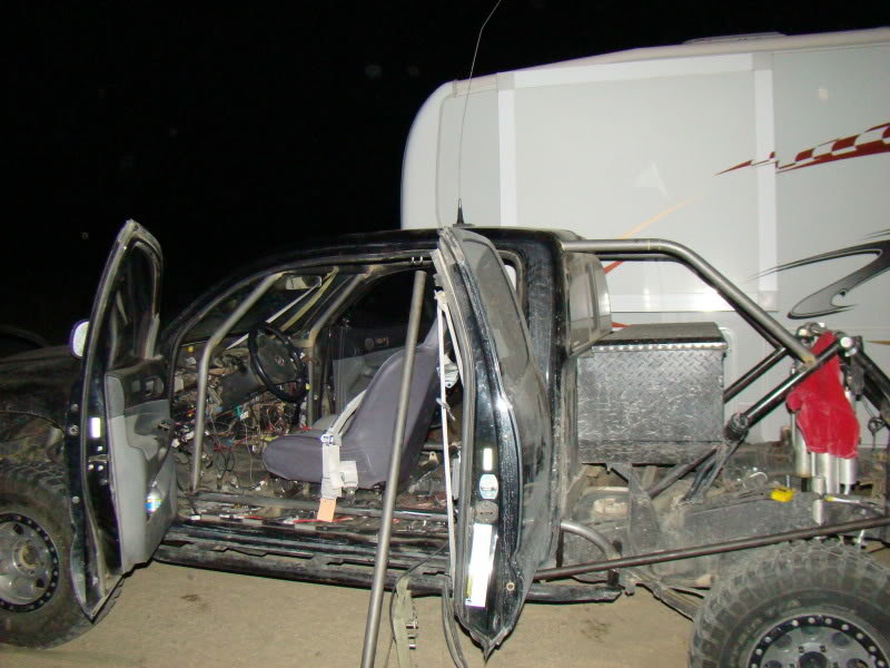

    I figured I better build a cage because I was starting to hit triple digit speeds in place that with my old setup I could only do 30.

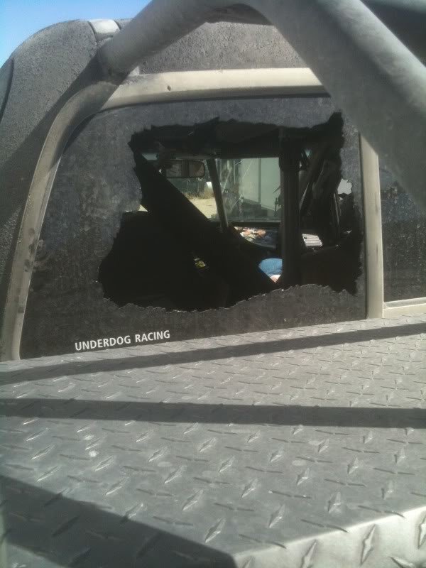

    Picked up some rear glass from Kartek-

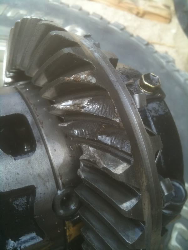

    Broke some stuff-

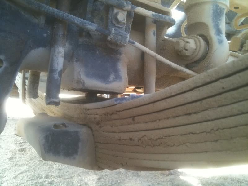

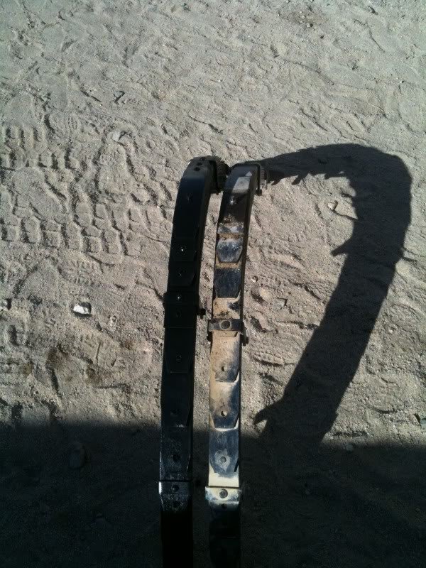

    I won some allpro baja leaves.
    They are way better than the deavers-
    Broke some more stuff.

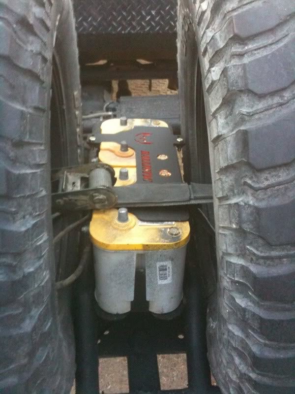

    Mounted a couple optima's between the spares-

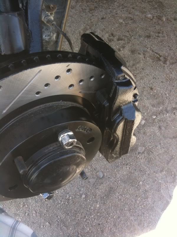

    Threw some fancy rotors on with Porterfield Racing carbon kevlar pads. They will stop you faster than a clean sliding glass door.
    I also installed 4.88 gears and an ARB locker up front.

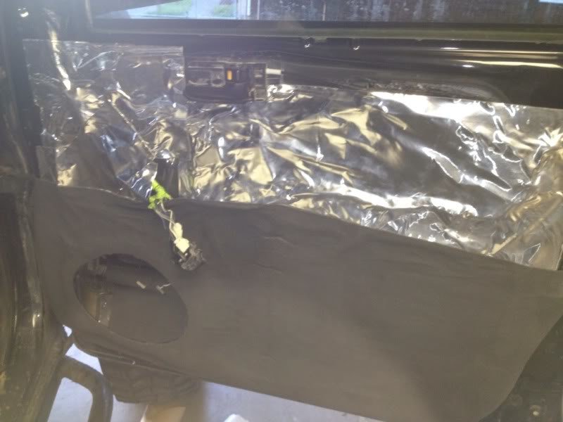

    Oh yeah, I prototyped some hand made ceramic plates wrapped in kevlar finished in carbon/kevlar and soundproofed the interior while I was at it.
