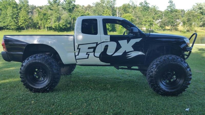

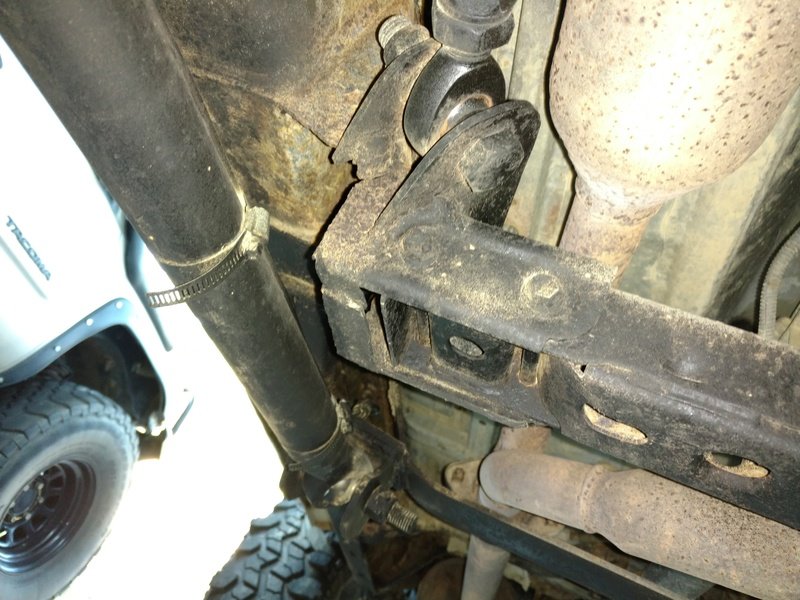

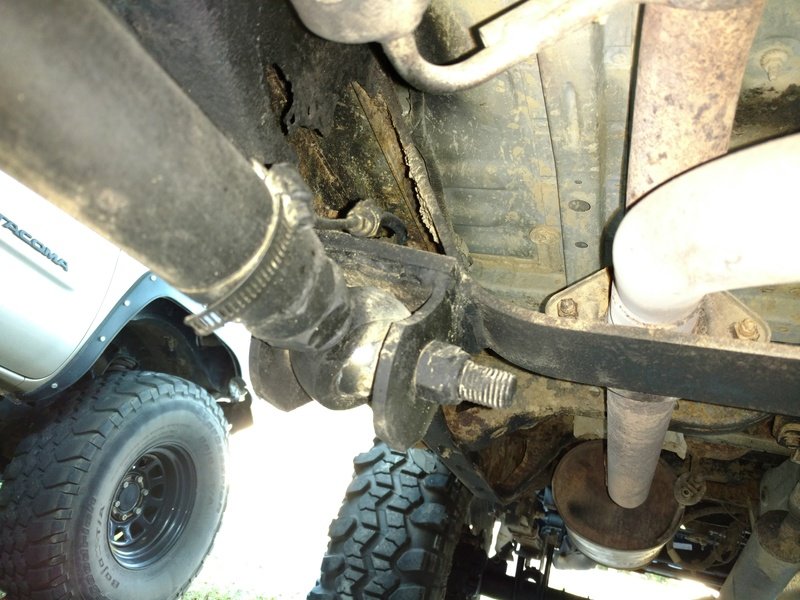

    A few weeks ago we finished the SAS on my buddies 09 DCSB Tacoma and I'd been chomping at the bit to do the same to my 05 Access cab. But there was a problem. The parts list alone for his build was close to $16k and I just couldn't swing it financially. So I was screwing around on Facebook a few nights after we wrapped up his project and I see this thing listed for sale in Tennessee, about 7hrs from me.
    Owner wanted $13,500 for it. 05 Access cab 6 speed (same as mine), 160k on the engine 200k on the rest. HP 79 Ford Dana 60 front, 14 bolt Rear from a Duramax. 3 linked on a brand new set of 42" TSLs. So I made arrangements and decided to buy it. The owner offered to trailer it down for me.
    He arivedd late on a Friday night after a few mishaps along the way with the trailer and ended up driving the truck the last 2 hrs to get it to me. I'd already decided to buy it and secured the financing (first truck payment in 5 years) so the transaction was pretty quick. He took the check, I took the keys. DONE.
    In the morning my buddy with the SAS 09 came over and we went over the truck.
    Now I was already planning to have to redo most of the work on the truck, because for that price something HAD to be wrong. So I really didn't have high expectations. Even those weren't met however.

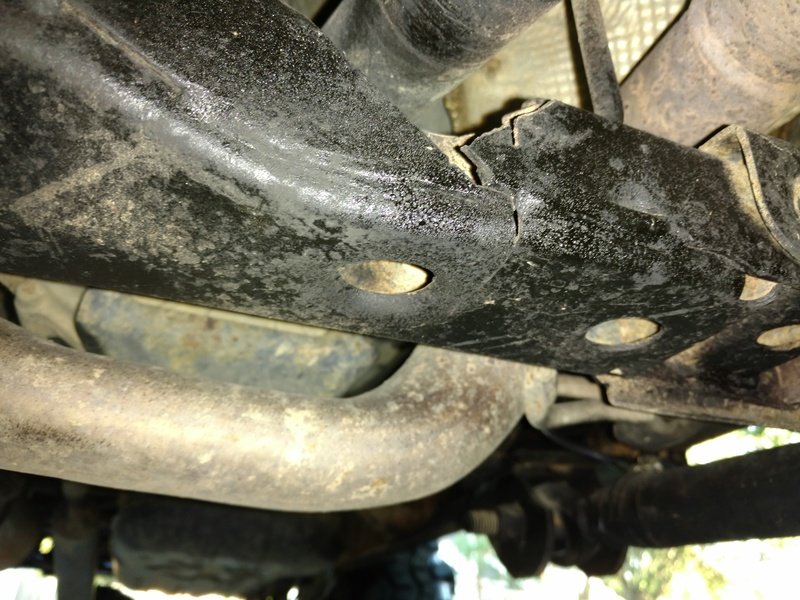

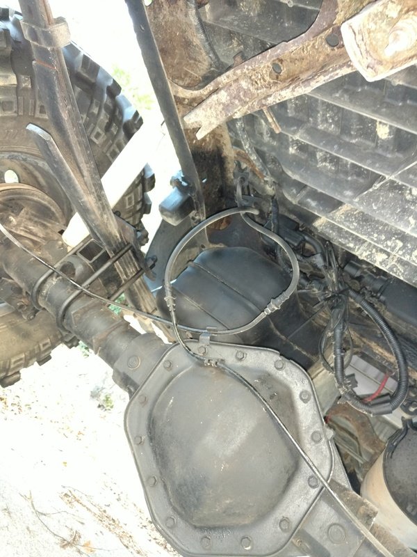

    Trans crossmember notched for the front driveshaft and links to clear. Not plated or reinforced. Crossmember is cracked

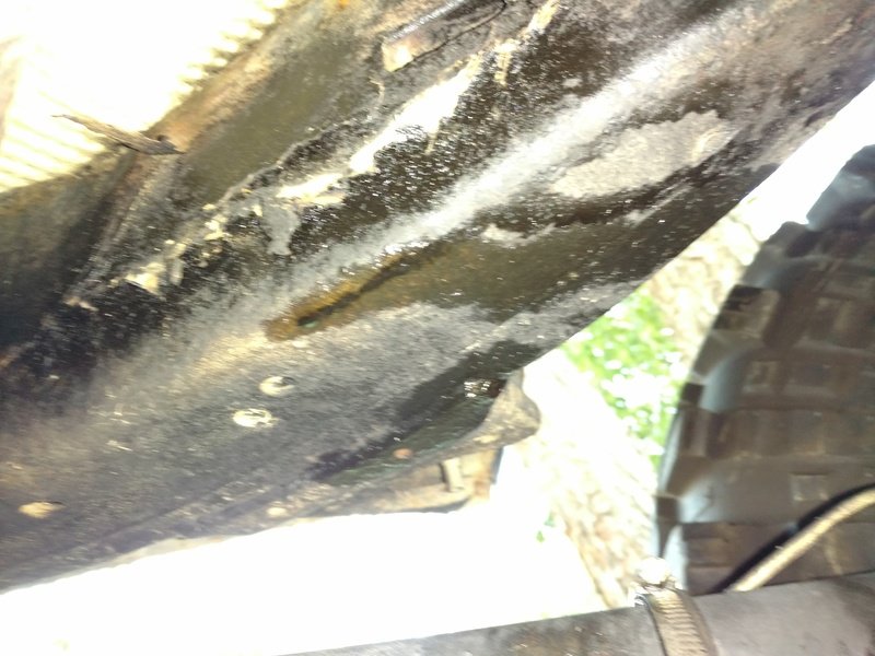

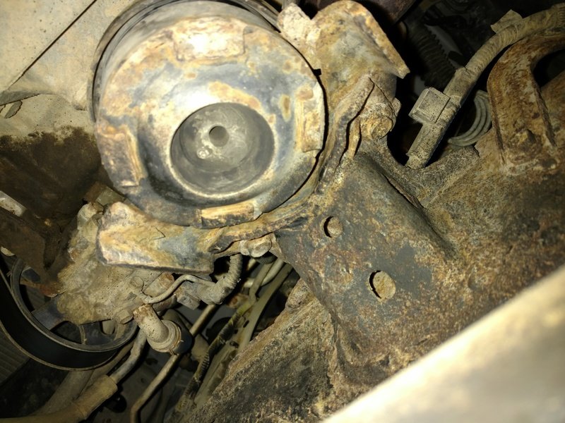

    Frame rust galore (actually looks worse in the pictures, but it is bad

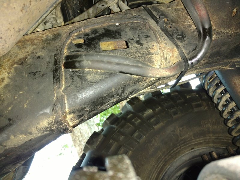

    Battery cables run through the frame. Was he trying to burn this bitch down?

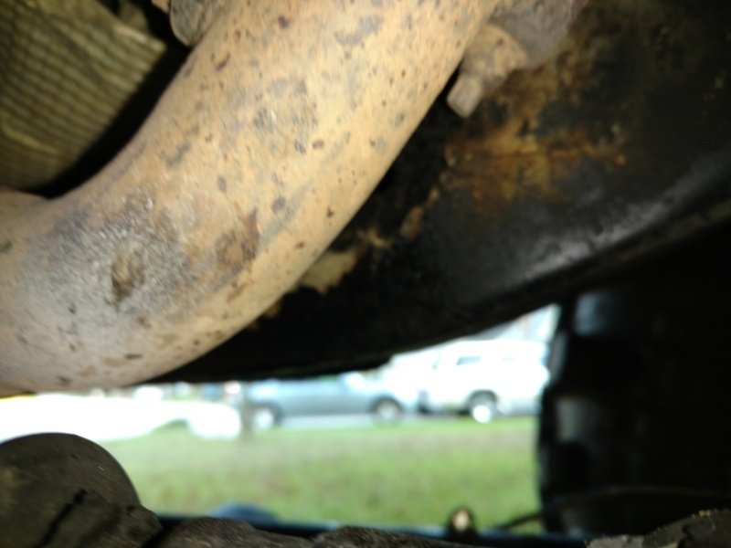

    More rust. I think the panhard bar hit the oilpan causing a crack.

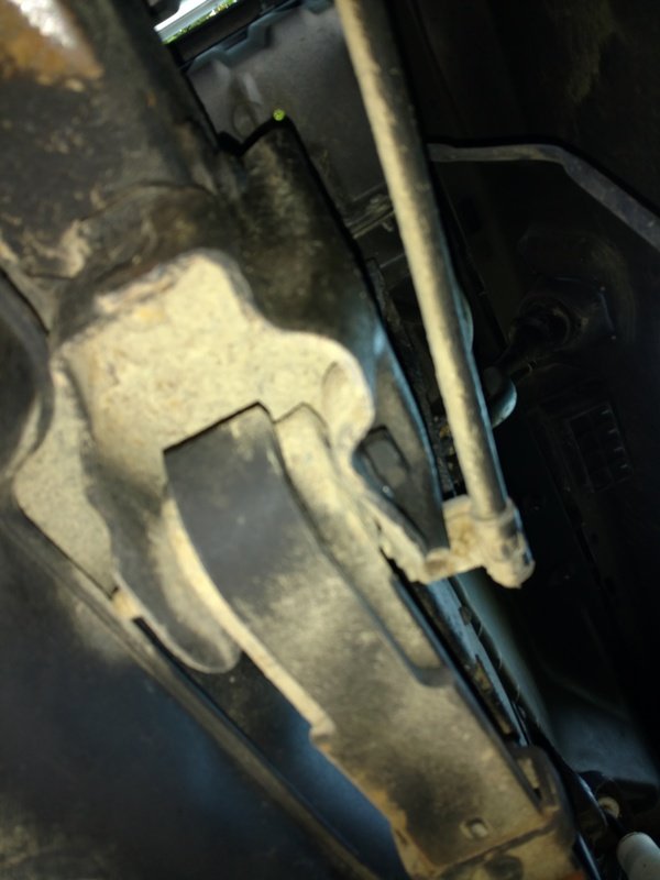

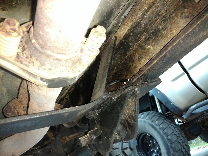

    Link mounts are welded to a piece of flat bar which is welded to rusty bits of nothing

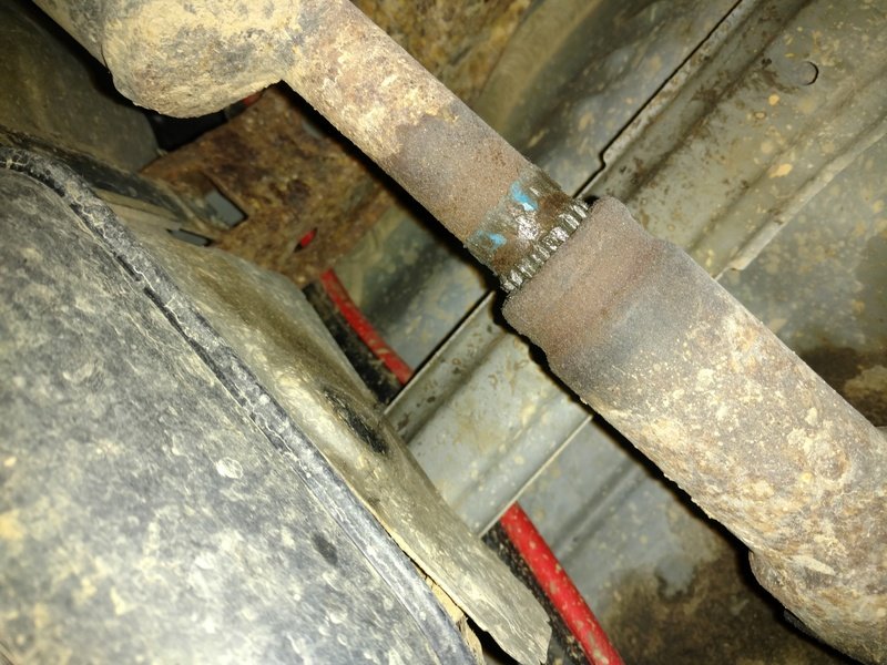

    Drive shaft is TOTALLY long enough
    If you can't figure out how to hook up the ebrake...just cut the cables

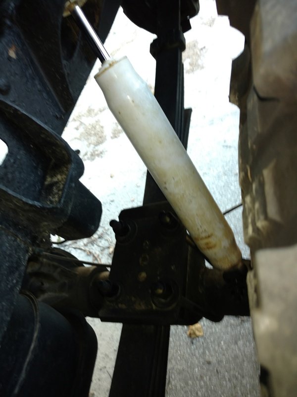

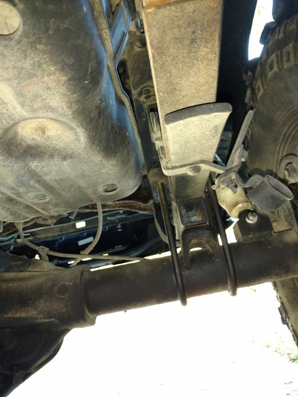

    Factory leaves, 2.5" "block" and some hacktastic shock mounting

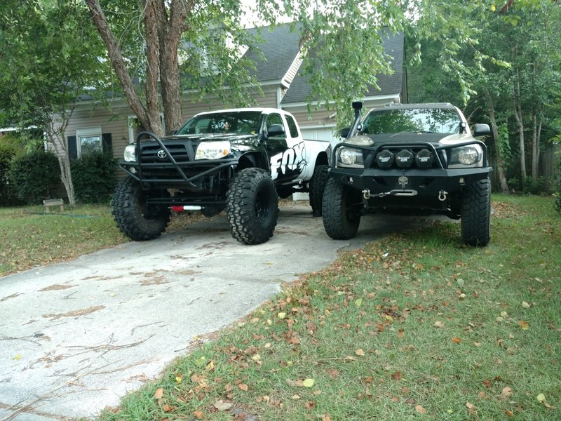

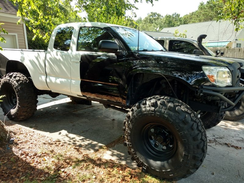

    Here it is next to my DD and some gratuitous pics of my DD
    Screenshot952016-03-23-21-45-112_zpsjqro_fd969322103e1d095bb0c2d5015ce392dc7769e5.jpg
    Took the stupid FOX decals off. Truck will be repainted sooner that later

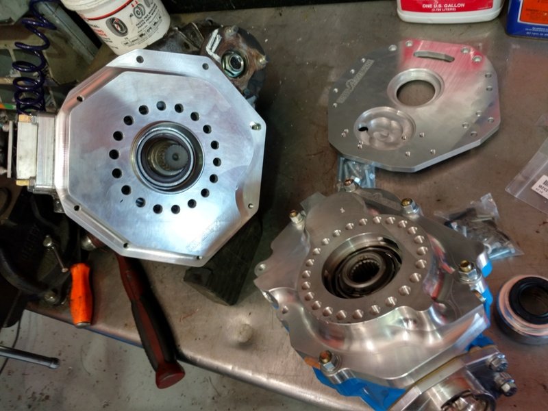

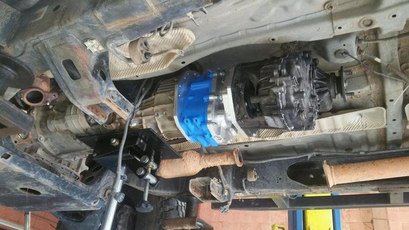

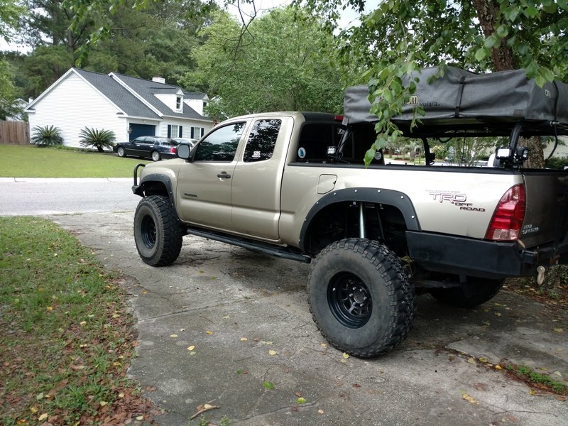

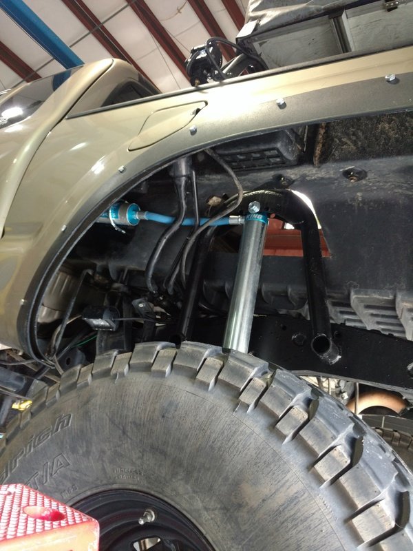

    More pictures from my truck's build so you can get a feel for whats gonna happen to Basketcase. The FJ Case and crawlbox were getting mocked up in my truck but were never installed. They will go in Basketcase now. The frame plate for the rear boxing job with be used again, this time to box the frame and also on the outside as frame plates to strengthen the entire structure. Most of the frame with be surrounded by fresh steel.

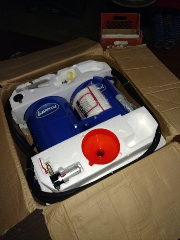

    So here's the plan. This is as much for my benefit as yours BTW. I gotta write this shit down anyhow. Might as well do it here. There will probably end up being a bunch of links to stuff I'm debating purchasing. Again, mostly for my benefit as I bounce between computers at work and home. I can reference back to this. But it may help someone else out later so win/win:
    First order of business: FRAME repair. This will be the the biggest and most important part
    I bought this this and 75lbs of media from Harbor Freight. No idea if that'll be enough, but we'll see.
    http://www.eastwood.com/dual-tank-b...e=&network=g&gclid=COPgguLR-s0CFVFZhgod5YQJaw
    So the plan is to remove the bed and lift the cab as high as I can get it without taking it off the truck laterally. I''' lift it with a couple big bottle jacks and cement blocks, the support it with jack stands. I just need to buy myself a foot or so to work and taking it completely off would create a ton of problems with how to actually move the bastard.
    Once its all blaster I will spray the whole thing down with a self etching primer to protect it until we can start patching, plating and boxing. The finished product should be completely boxed. Even if I have to move or redo brake and fuel lines.

    125CFM?!? The manual said 10CFM. If that's the case I'll end up having to rent a diesel compressor.
