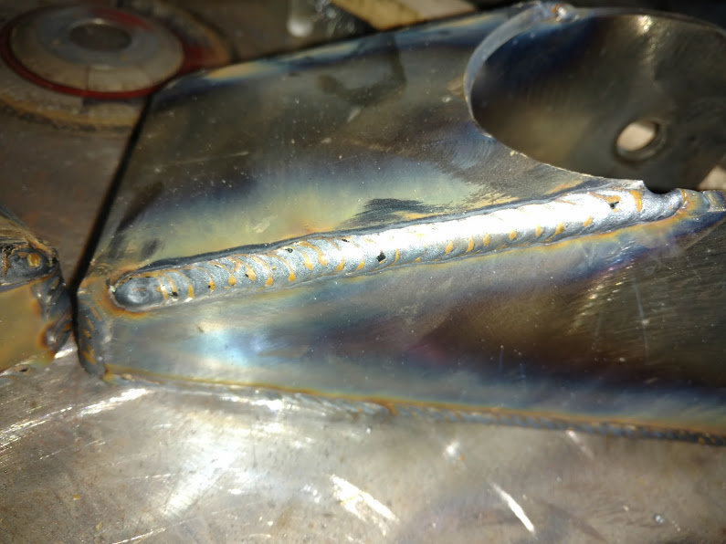

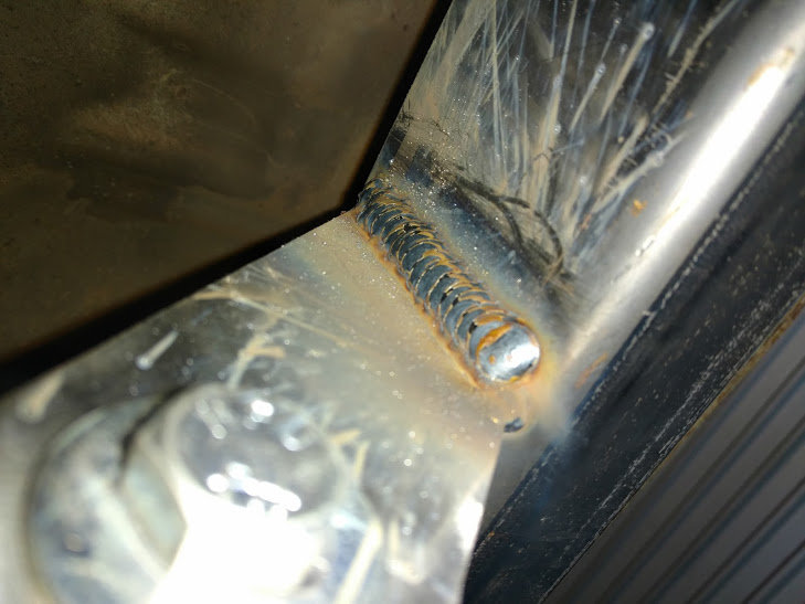

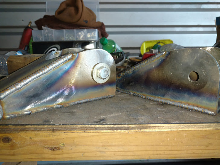

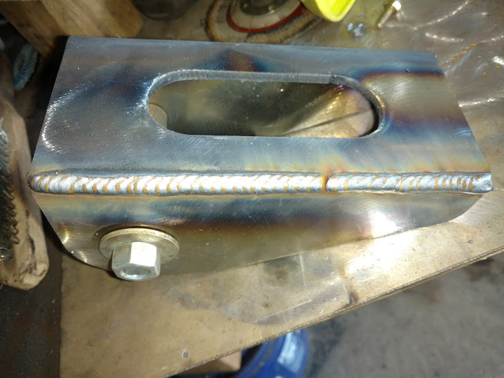

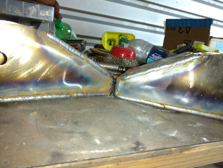

    Very nice, those welds are looking good.
    Bobcdn and scottalot like this.

    That would be Eddie's handy work. I can't take credit there. That son of a bitch can stack dimes on a 2x4 if you ask him to. If you ever look at a SOS Concepts bumper you'll see it. Until recently he did all his own welding. He still does 75%.
    I'm getting better, but when it needs to be pretty, Eddy comes and lays the bead.
    scottalot and Arcticelf[QUOTED] like this.

    Some of my welds from today
    IMG_20161231_130231626.jpg IMG_20161231_141741220.jpg IMG_20161231_144807527.jpg IMG_20161231_151107065.jpg IMG_20161231_151133328.jpg IMG_20161231_152112696.jpg
    Bobcdn, Neutral, deeezy and 6 others like this.

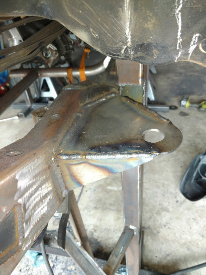

    Got a little more done this weekend. Got the passenger bed rail cut off and replaced. Just have the drivers side left to do. That frame rail is made already. Eddy is borrowing my torch right now. As soon as it's back friday I'll hack the drivers frame rail of and the new frame will be pretty much done.
    All the welding in this post is done by me, so it's not as pretty as as the engine section:
    IMG_20170102_165938095.jpg IMG_20170102_165943941.jpg IMG_20170102_170001380.jpg IMG_20170103_112537760.jpg IMG_20170103_112543376.jpg IMG_20170103_143206760.jpg IMG_20170103_143217313.jpg IMG_20170103_145650079_TOP.jpg IMG_20170103_155259857.jpg IMG_20170103_160011274.jpg IMG_20170103_161710587.jpg IMG_20170103_161715476.jpg
    deeezy, Acerwin, Nickel and 5 others like this.
