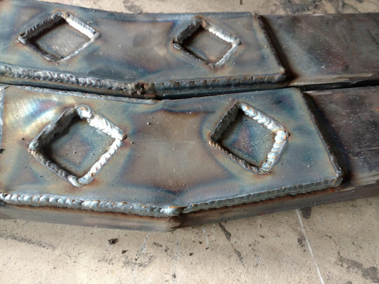

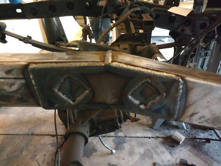

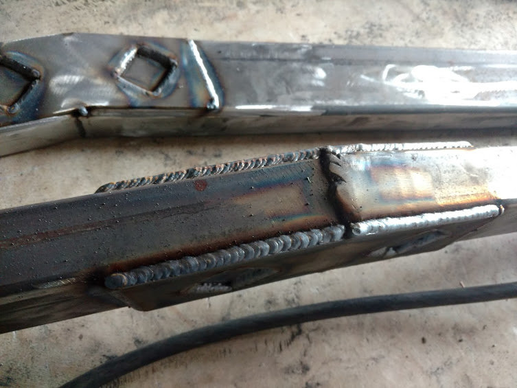

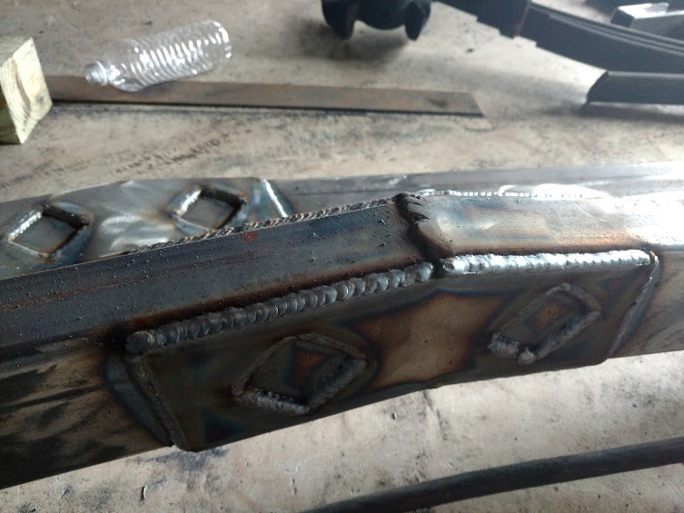

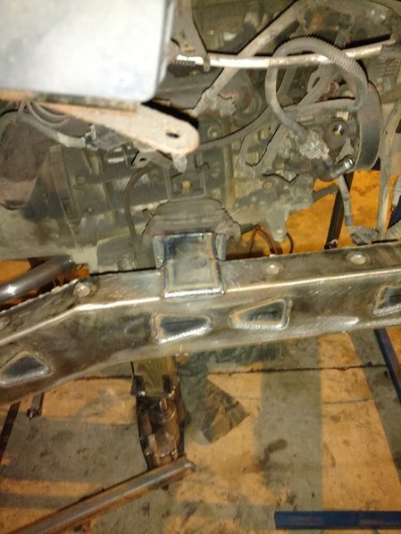

    How come you have the squares cut out on the joining plate? Just more area of penetration? I don't know anything about welding.

    Yep, it's called fishplating, and it's to make joined areas/frame rails stronger.

    This. More surface area to weld

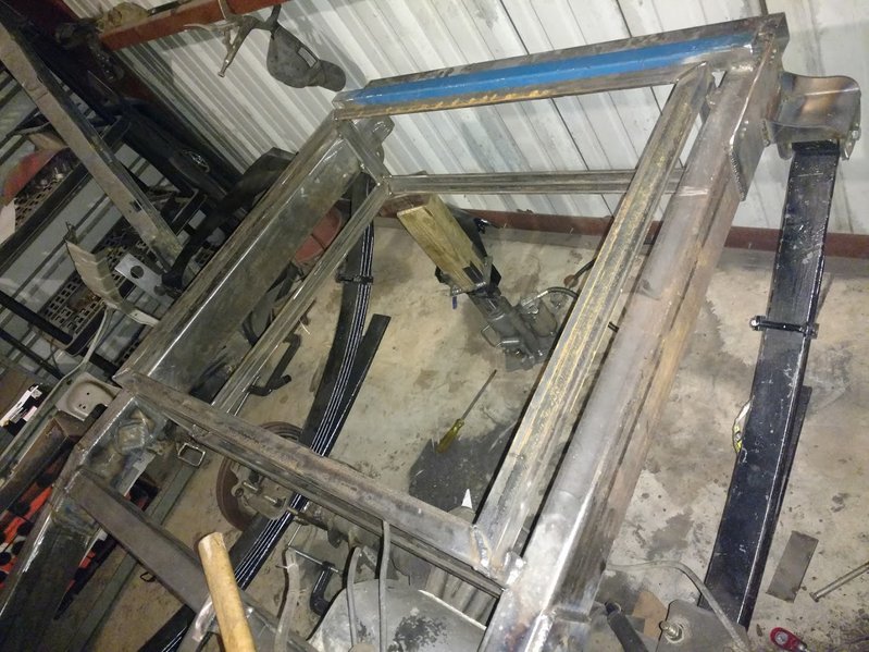

    Been a whiles since I posted and update. @EddyRRT helped me get a lot of the big stuff done in a day.
    First we got the rear springs mounted. These are lift Chevy 63s. Probably gonna pull out 2 leaves and throw a stock Tacoma shackle in. Then adjust from there

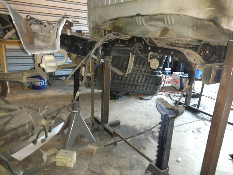

    Rear cab mounts are build and the cab is on them. Gonna have to jack it up at least once more but at least its there now. AWESOME.

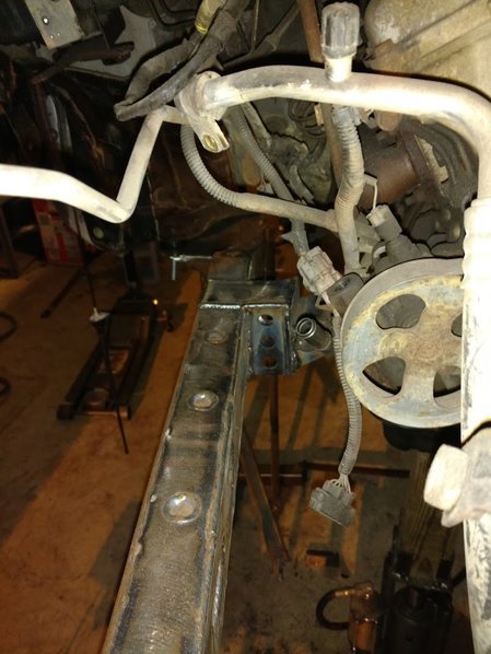

    Engine mounts are build and the engine and trans are now suspended from the frame. Passanger frame rail isn't straight at the engine bay, but oh well. Nothing connects there and something was bound to be screwed up in this deal

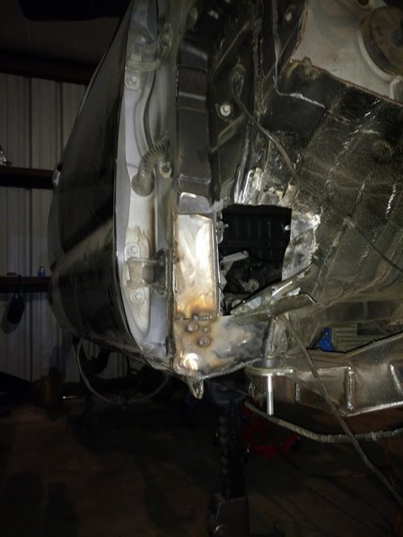

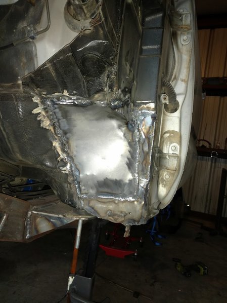

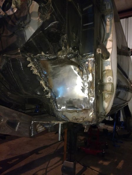

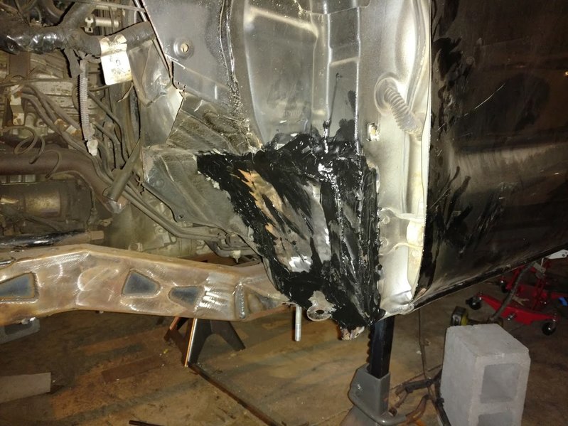

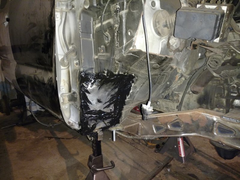

    Got the firewall tubbed. Major pain in the ass. Ran out of shielding gas and had to wait for the next weekend. I did nowhere near as clean a job as Eddy did on my other truck but its done. A lot of seal sealer to hide the mistakes.

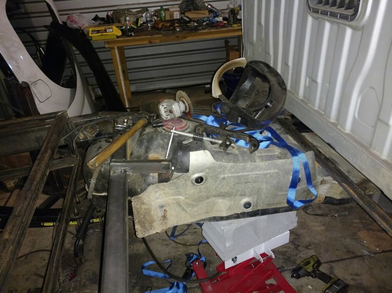

    Fuel tank is almost mounted. Just neep to go pick up a longer bolt and finish on last mount then drop the tank, paint and reinstall. Leaving the Evap crap out. There's no vehicle inspections in this state and the CEL is gonna be on no matter what I do. Along with pretty much every other light.

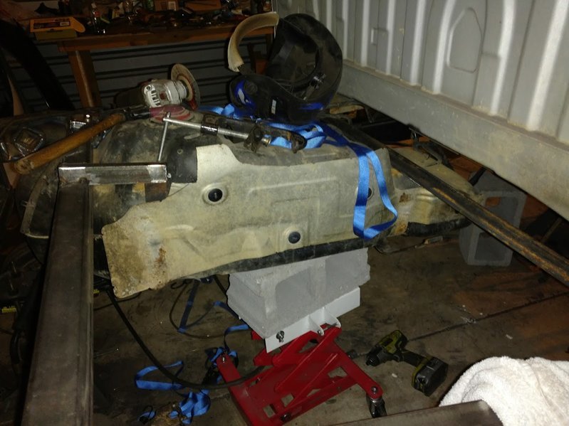

    Started the bed build. This will be a truck type storage area with a flip open lid. Probably raised and lowered with a 12" linear actuator for shits and giggles.
