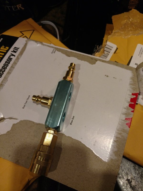

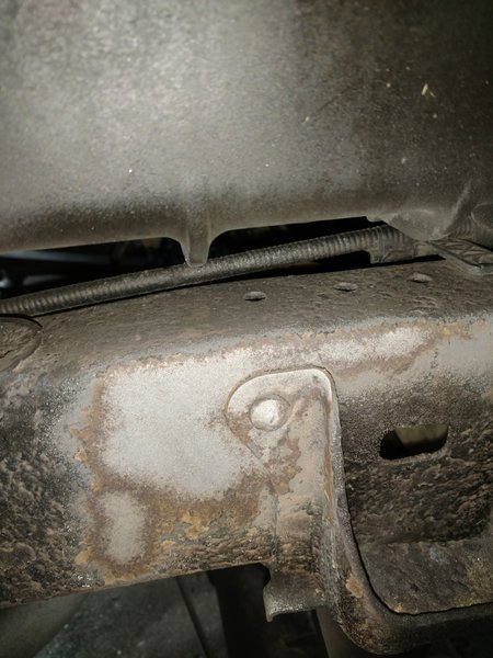

    So after reading that I had to go do a little test. Very quick cause I wasn't wearing any PPE or are the tires or body off the truck. Using my little compressor thats rated at 6CFM and the HF aluminum oxide this is what I got out of a couple second blast:
    I know my compressor is too small but my buddies is bigger, rated at about 11CFM, but its 300 FT away. So heres my redneck plan:
    I bought 300ft of hose. I'll run that line from his compressor to a manifold where I will also hook up my compressor. From that I'll run a line to the blaster.
    I know thats not ideal and it'll take a while but that's what I can do. I'm not really supposed to be blasting and painting in this unit so backing up a diesel compressor is kinda out. As it is I'll be doing this job in the middle of the night after everyone is gone.
    I'll pick up more media and look for the crushed glass. Think regular old Rustoleum will work for the blasted surface?
    Manifold, just needs 2 plugs:IMG_20160716_190815605_zps4gpmb5wp_6250102133d8f89284eddfb85a9c35737bd986fe.jpg

    Looks okay.
    Rustolium probably good, you can also get a weldable primer, that will prevent surface rust until you get ready to paint.

    Ya it should work it'll just take some time....I aluminium oxide is great just expensive but it's super hard and less dusty than glass.. it's kind of a trade off. The blast looks good you want more white metal than brown but some shadows here and there won't hurt anything. Ya ristoleum will be fine... I'm big on epoxy coatings but they're again expensive and suck balls to take off later and since you have lots of fab work ahead I wouldn't recommend that route. If your blast pot has a pressure regulator on it you can vary the pressure for sensitive areas but since you're running low cfm I down forsee too much trouble just remember to be mindful of the ricochet can end up blasting other thins you don't want blasted that way.

    If you start blowing holes in the frame spend some extra time on that section as well cause the media will eat up the rusty steel. Also stay away from organic based media such as walnut shells they leave a super greasy residue on everything and if you don't get it all out it'll start to smell as the organic material breaks down

    Makes sense just be sure not to spend too much time on one spot when doing body panels as they'll warp, cause they're tin. Also you'll wany finer grits to clean the metal vs putting too much profile you'll see from the frame that even after the primer there will be a profile on the metal which takes a few Coats to lessen. Soda isnt super abrasive so it shouldn't be an issue just keep it in the back of your mind.
