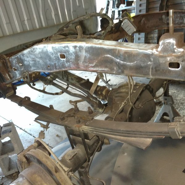

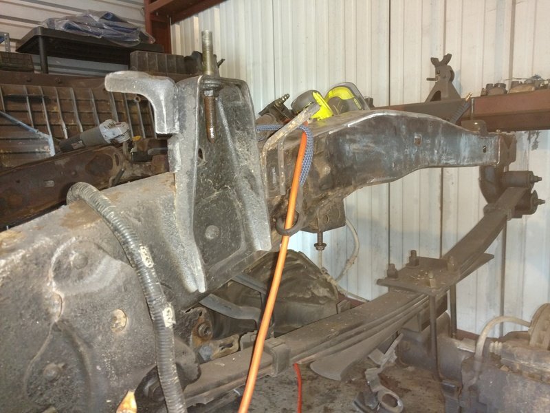

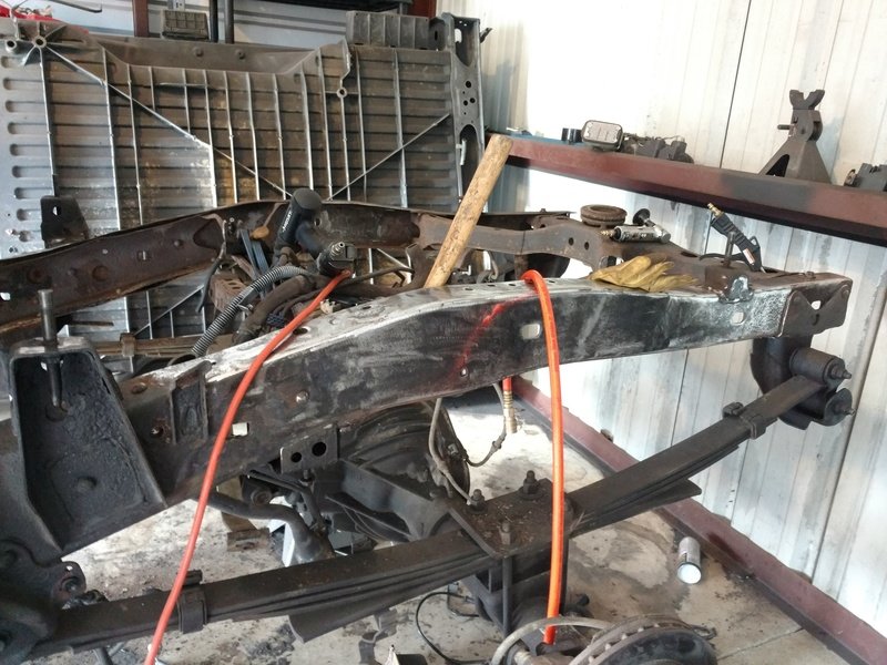

    Well media blasting was pretty much a failure. I probably had the wrong media. The stuff I bought was super fine, like dust. In that tiny enclosed space as soon as I started blasting there was an enormous dust cloud and I couldnt see shit. Between that and having to blast at night with nobody around so there was little light and 120degrees in that unit it pretty much sucked ass. Mostly I just sprayed 150lbs of dust around the storage unit, got dirtier than I've been in my life and cussed alot. So it was back to the drawing board.
    Now I'm attacking this thing manually. Bought a new grinder and a stack of flappers and cutting wheels.
    Friday was reasonably productive. Got all the brackets cut of the back of the frame for bump stops and shock mounts and get it ground down pretty well.
    A 2" air grinder and a stack of 36grit sanding discs plus a borrowed needle scaler are helping a lot on the inside of the frame.
    The hardest part was getting through the undercoat that was sprayed over EVERYTHING. Eddy gave me a good tip on that. He said to use a cutting wheel at an angle to lightly gring it away. Worked like a champ. Probably saved my a couple hours and a handful of gummed up flapper wheels.
    THis isn't where I ended for the day, but it was the last picture I took
    IMG_20160805_152151625_zps9k5x3pvb.jpg IMG_20160805_171610942_zpswaf44zk3.jpg

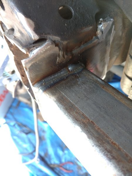

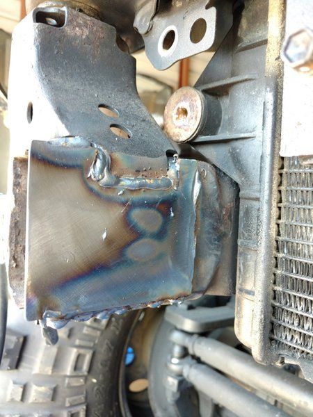

    Also got a brace welded in for the front of the frame. THe prior owner cut the lower crossmember of the front of the frame for som unknown reason (He was a complete dumbass) so I welded a couple plates in to strengthen the frame and put a piece of 2x2 box between the frame horns. I'll add new bumper mounts later with 1/2" bolts as the studs instead of the crap studs attached to tin that Toyota used.
    Keep in mind I have 0 welding experience. THis was the first attemp at welding, pretty much ever. Aint pretty but it'll stick. I cleaned it up with a grinder later

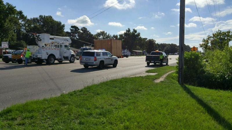

    Some dickhead decided to haul an oversize load down the street infront of the shop early Saturday morning. It snagged the power lines ripping it and 3 power poles down. So there was no power ALL DAY. And I got no work done. FUCKING SUCKS
    Now I'm back at work. I'll probably swing by after work to hit the bare metal with a wire wheel and weld though primer so it doesnt surface rust while I'm busy this week.

    That media blasting situation would have had me more than cussing and yelling. Not bad for your first weld at least it looks like solid penetration. You get some tips from your neighborhood welding gangster and you're set. Well done Cap.

    IMG_20160807_184332.jpg IMG_20160807_184332.jpg IMG_20160807_163744922.jpg IMG_20160807_163701537.jpg

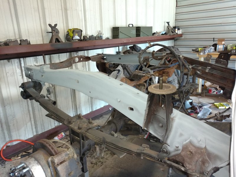

    Got a little more work done today. Finished grinding the rear of the frame inside and out till it was mostly bright then hit it with a high zinc weld through primer.
    I tried some 2" flapper wheels on my little IR 90degree die grinder today and they worked great. Damn nice for $12/10 of Amazon

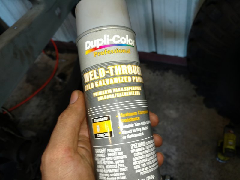

    Got some work done this weekend but forgot the picture taking. Rear of the frame where theres two layers of steel are is all seem welded together. Spent a full day getting all the delaminated rusty steel out of the gaps, clamping and beating it together then welded up. Only popped the circuit breaker once :)
    Got the cab jacked up high enough to clean the top of one frame rail and got it primed. Now I have to do the other side.
