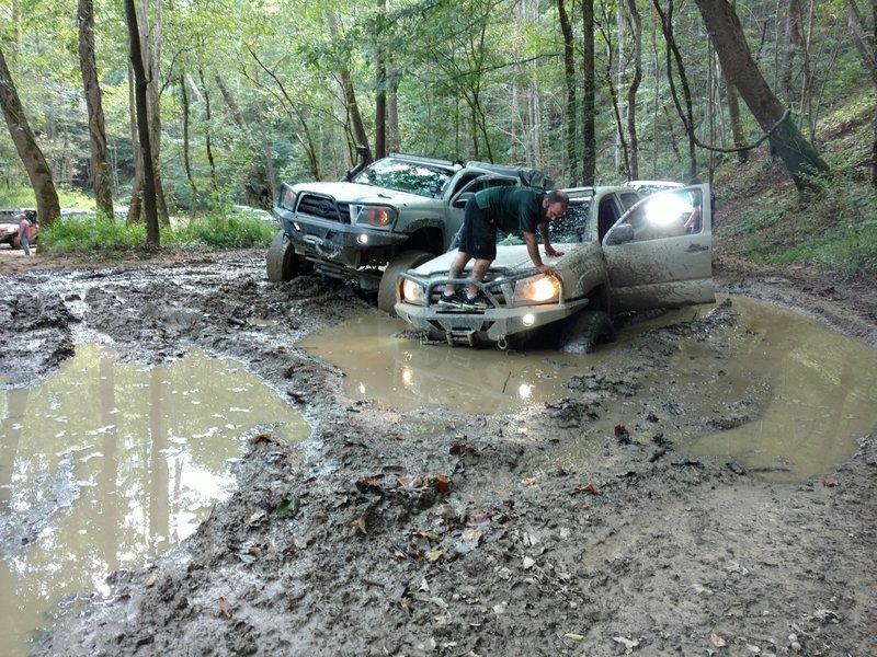

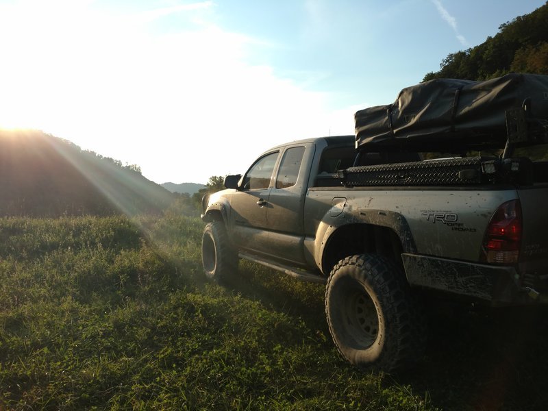

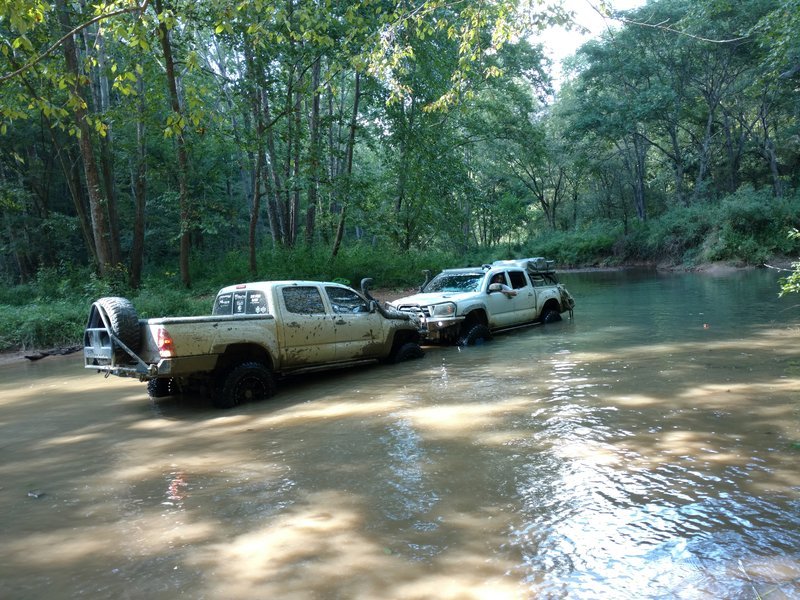

    Been a little while since I updayed, but I haven't been able to get much work done recently. Had a trip to Kentucky that I had to get the DD ready for and been working my ass of since I got back:
    Kentucky:IMG_20160903_163100738.jpg IMG_20160903_112208859.jpg IMG_20160903_163147069.jpg

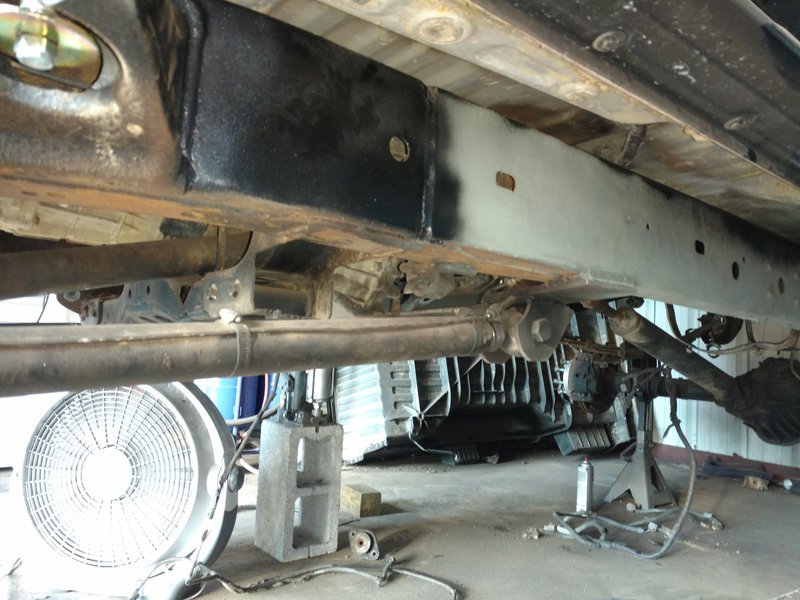

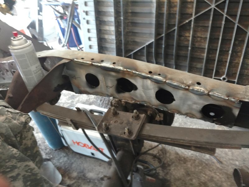

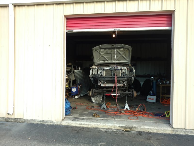

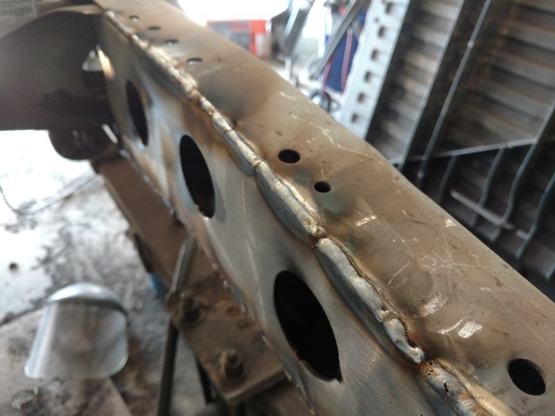

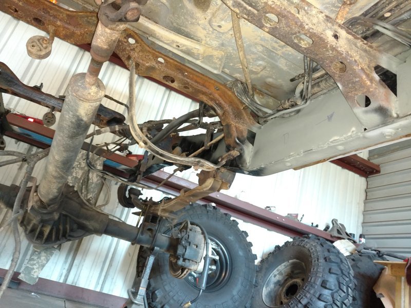

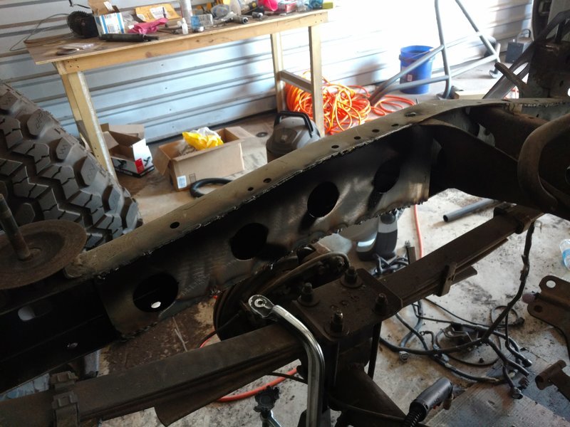

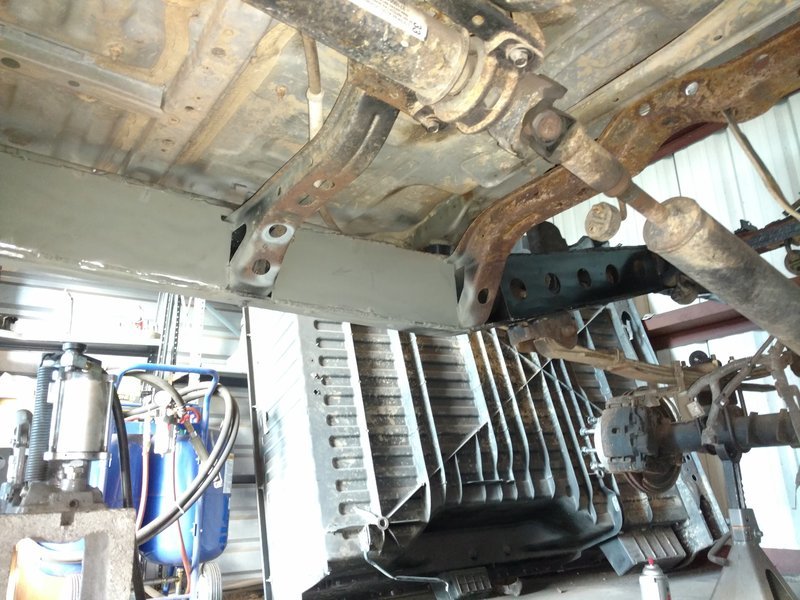

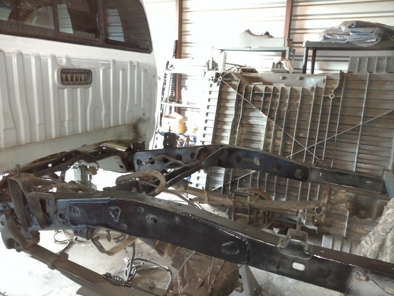

    Got home and got back to work on Basketcase:
    MANY 4 a/2" flapper wheels later the rear 2/3 of the frame is pretty well cleaned and boxed. Still need to do a litle rewelding over my booger welds but it'll work. Boxed with 1/8" plate:

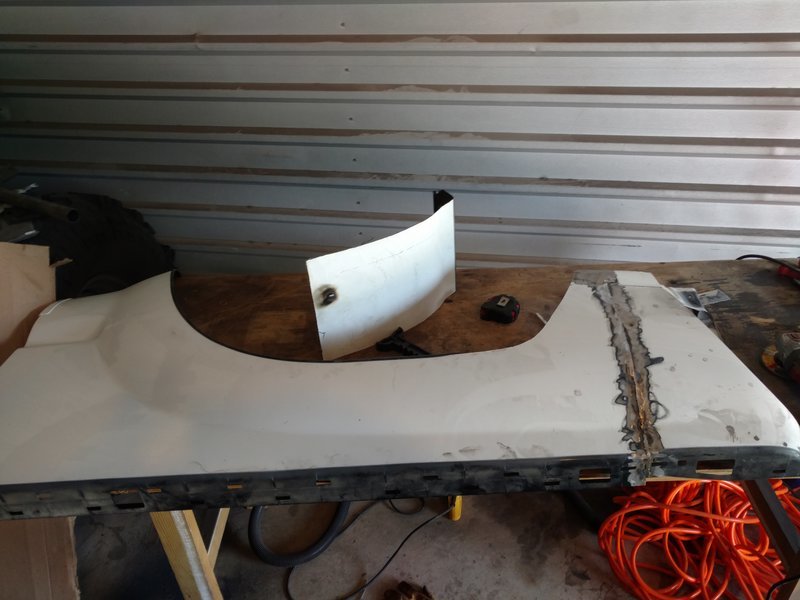

    Cut the bedsides for the bed bob as well. I really need a friend in the auto body buisness. Hopefully these will be temperary. I REALLY want glass fenders and bedsides

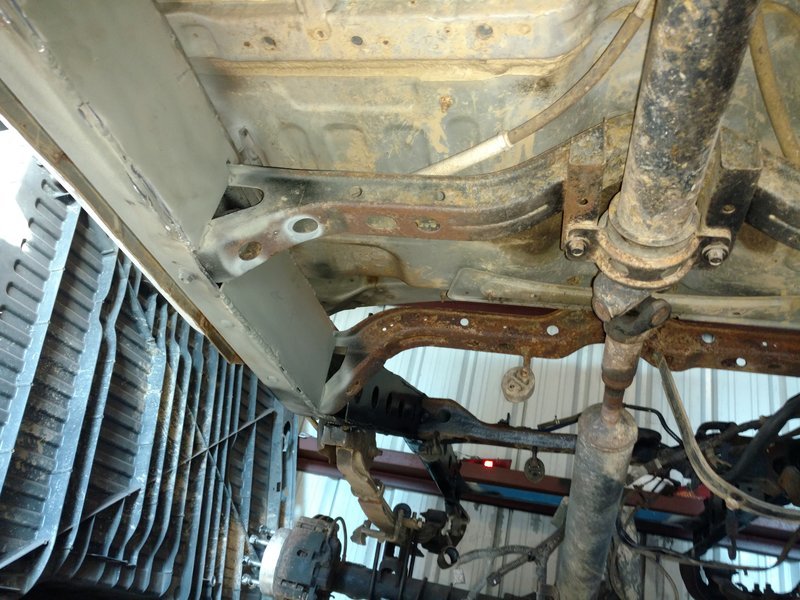

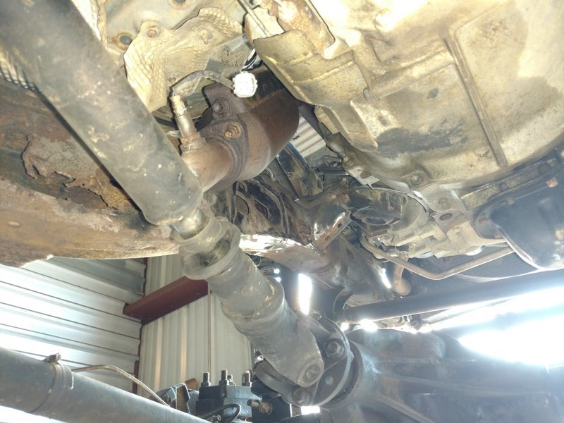

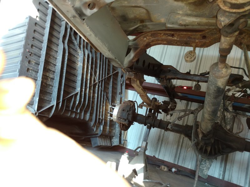

    And the first new parts went in. New body mounts all around and a 1' Toytec body lift. Bolts are all in but not tight:
    IMG_20160924_180645160.jpg IMG_20160924_180645160.jpg IMG_20160924_180653349.jpg IMG_20160924_180645160.jpg IMG_20160924_180653349.jpg

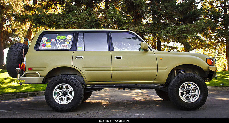

    I think I've figured out what I'm gonna do for pain. THe paint on my DD took a beating in Kentucky so I've been thinking bedliner.
    LineX wants a fortune to do a whole vehilse and I don't particulatly like the texture. So I'm thinking this:
    http://www.jeepforum.com/forum/f59/monstaliner-interiors-exteriors-1376308/
    It's supposed to be a good DIY bedliner, available in colors that lays down smooth with a roller, or more texture with a gun. I'm thinking I'll spray my floor pans with it and the underside of the cab for some sound deadening since I don't plan to put carpet back in it. Then roll the body.
    Color I'm looking at is: Sans Panties
    Its between OD and tan. I'll probably do the same thing I did with my DD and black out the roof, center of the hood and all the armor. Although I'm thinking a dark brown or charcoal greymight look pretty cool for those areas as well.
    Anybody used Monstaliner before? I tried the spray on Raptor liner, and it seemed pretty good as well but it had a lot of texture

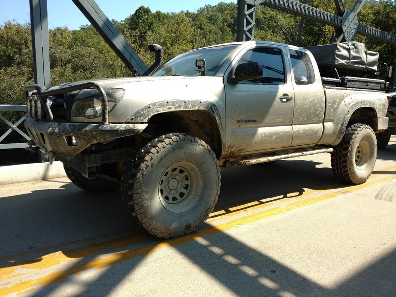

    Nice pics. Mud is nasty! I'm glad I live in a state where it rarely rains, so there's no mud anywhere.
    Just curious, and I'm sorry if I missed it on your thread, but why the 1" body lift?
    I installed a 1" body lift out necessity a few years back. The guy that welded my rock sliders go them too close to the bottom of the cab - in spite of me specifying where I wanted them exactly. Oh well, As result of being close to the cab, the rock sliders would hit the cab continuously making this annoying noise on the highway. Well, it was actually the cab hitting the rock sliders as the body mounts deflected movement from the road :D Before that, I had no idea of how much those body mounts actually absorb movement.
    I found that it would be easier and cheaper to install a 1" body lift than to cut and reweld the sliders and inch lower (especially since I got a deal on the 1" and it was super easy and fast to install). But I am very glad I installed the 1" body lift anyway because it turned out great for other things. Vehicle maintenance became easier in many areas such as removing the starter. The 1" also made the installation of the Atlas transfer case waaaaaay easier; as well as making it easier to work on the tranny. It's amazing how that inch of space between the body and the frame clears a lot of stuff.
    Work is looking good on your truck.

    I've got a crawlbox waiting to go in which was the primary reason for the body lift. In addition it will allow me to lift the engine to clear the panhard bar and like you mentioned give more room to work in general. Also it gave me all new hardware to replace the rust junk I took out. Win all around

    looking good Cap. Love the color choice too, she is going to be nasty. I see nothing wrong with those "booger welds" a grinder cant fix as long as the weld is good who cares.
