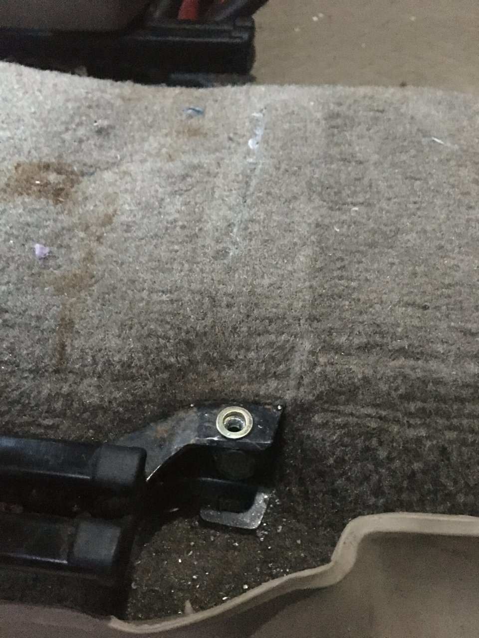

    I finished up the rear mounting bracket last night. I had originally planned to attach it to the rear seat bolts, but since the transmission tunnel does not have vertical walls, I'd never be able to get it unmounted without removing the seats.
    I went through a couple of different ideas, but I ended up drilling out the square holes on the top of the seat brackets (used for the plastic covers) and installing 6mm nutserts. I can now bolt the mounting bracket directly to this without having to unbolt the seats.
    Here’s a picture of how the bracket attaches at the back
    Here's a shot of the bracket on the bottom of the box. I just used some #12 short screws and put some JB weld in the holes before putting it together. I don't plan to ever take this off. The bracket is 1/8"x2" aluminum.
    I though about fiberglassing this bracket into the box, but then I would need to mold everything to the transmission tunnel. I really didn't want my truck smelling like fiberglass for weeks, so this was my alternative.
