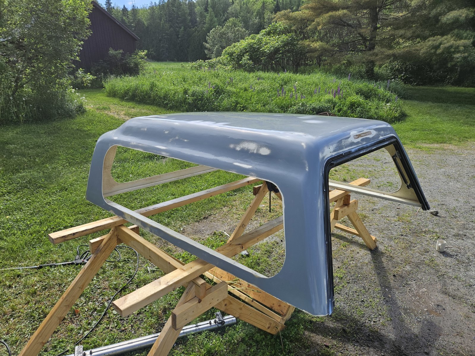

    20240605_161413.jpg 20240605_161419.jpg 20240605_161434.jpg 20240605_161413.jpg

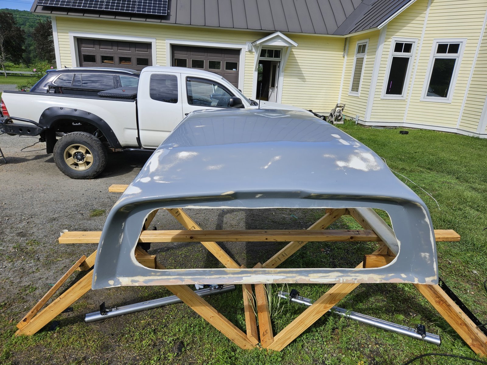

    Well, I guess I'm dead cause I'm too pooped. I need to fill a couple voids I found under the factory gelcoat and I don't have enough light to do that and get it wiped and coated tonight.
    On no planet is a 1/4 sheet palm sander the appropriate tool for this scale of work. I need a big orbital for doing this to the truck.

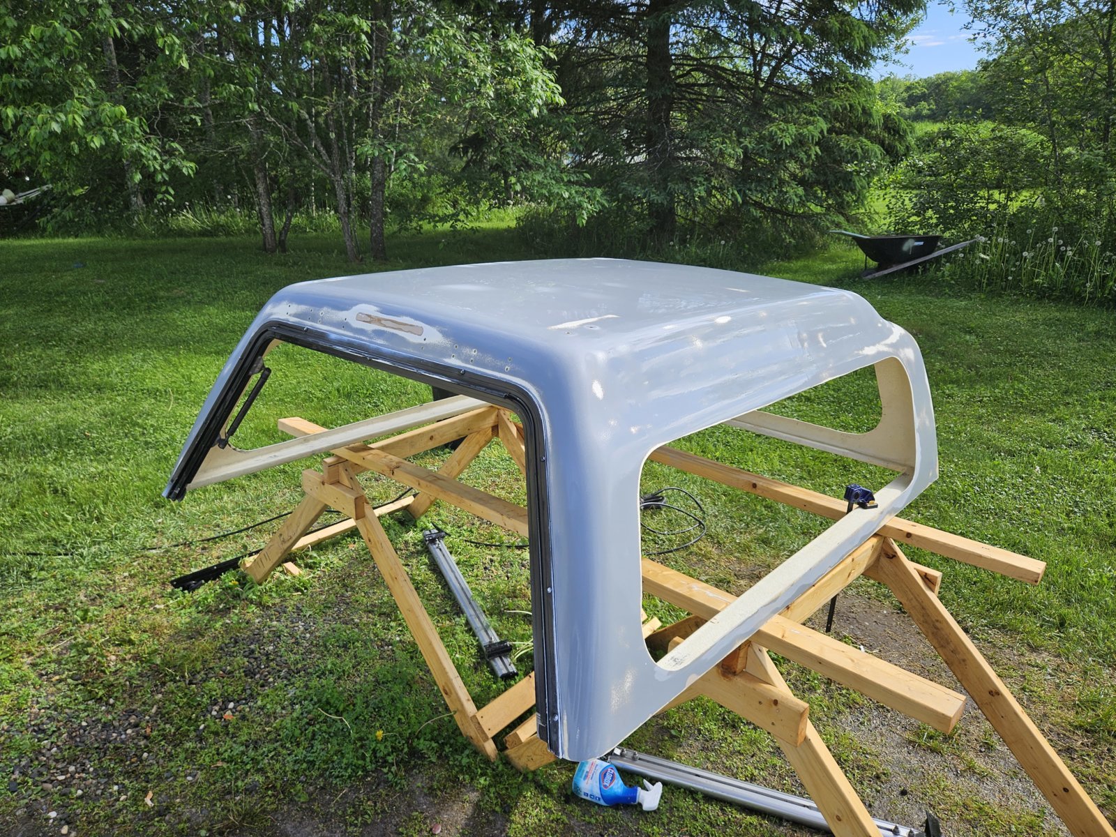

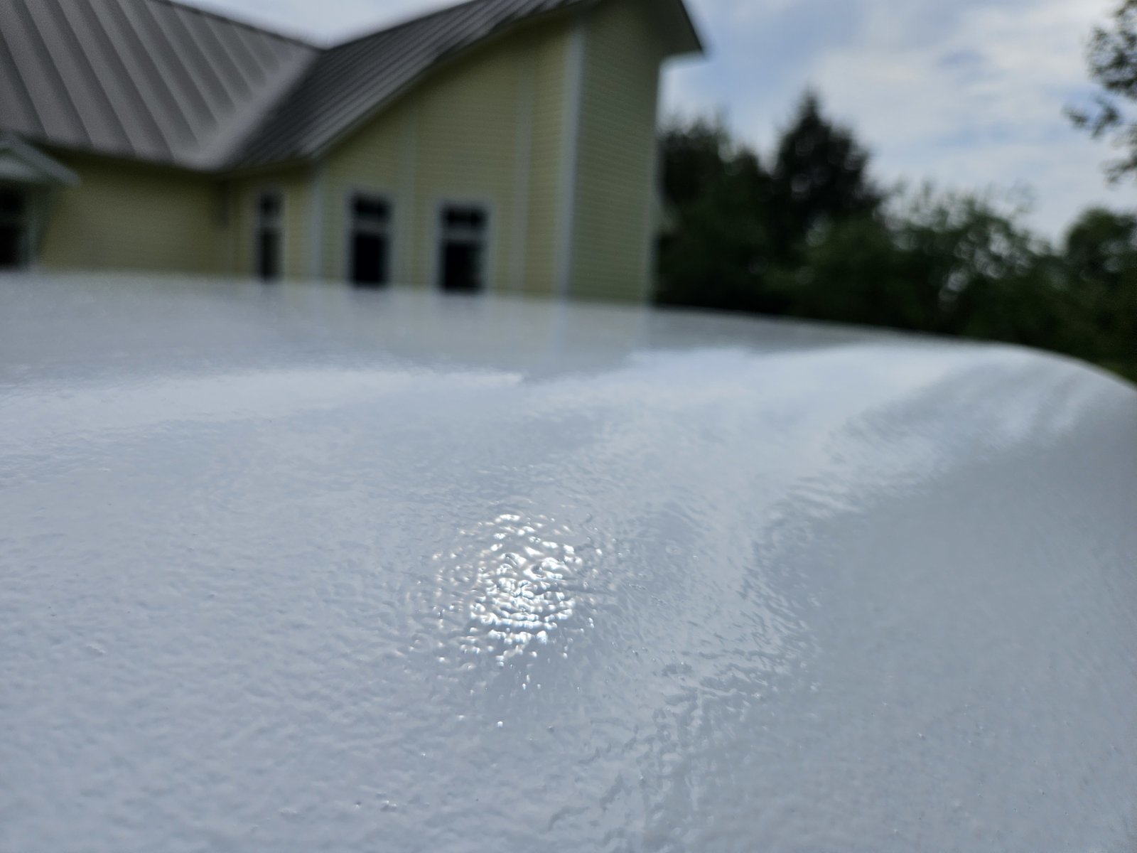

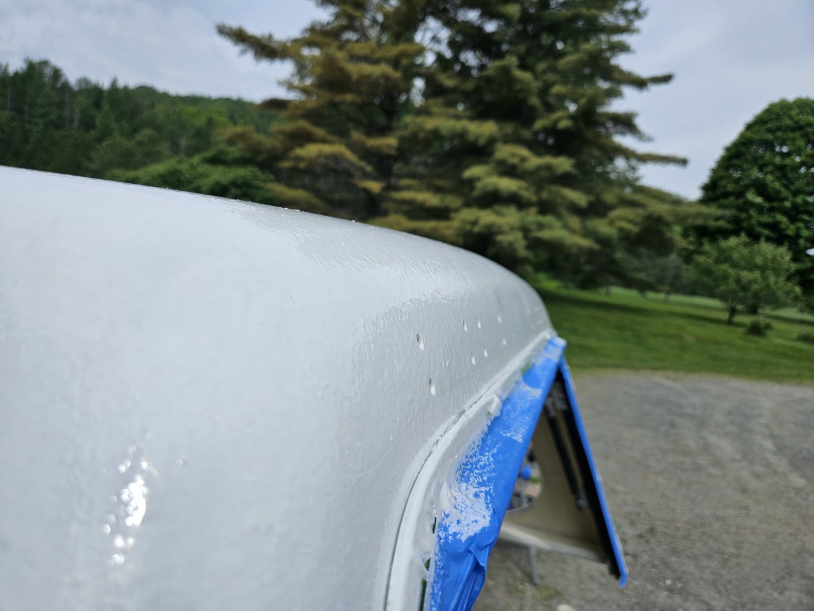

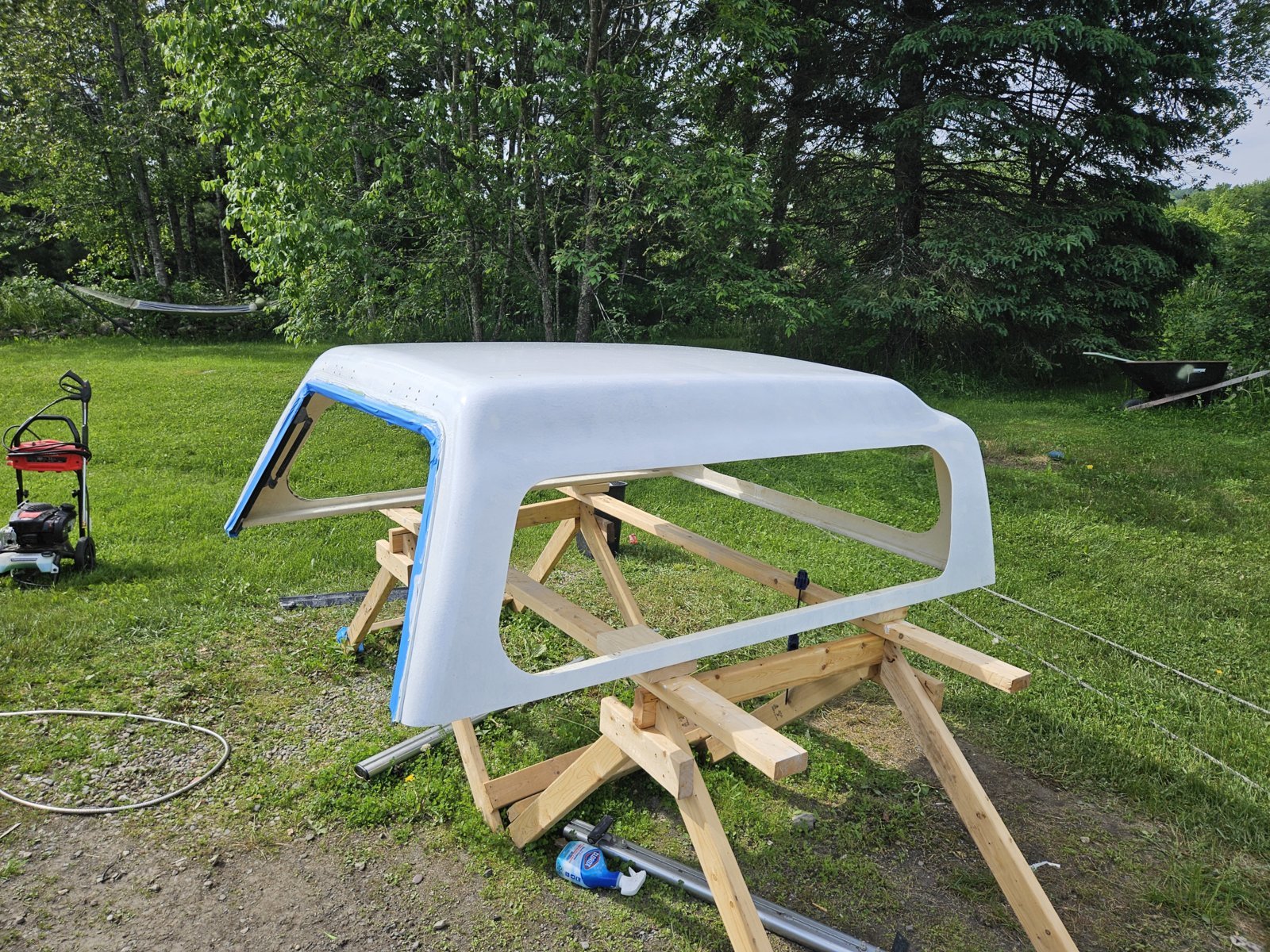

    First coat. Second goes on when dry to touch.

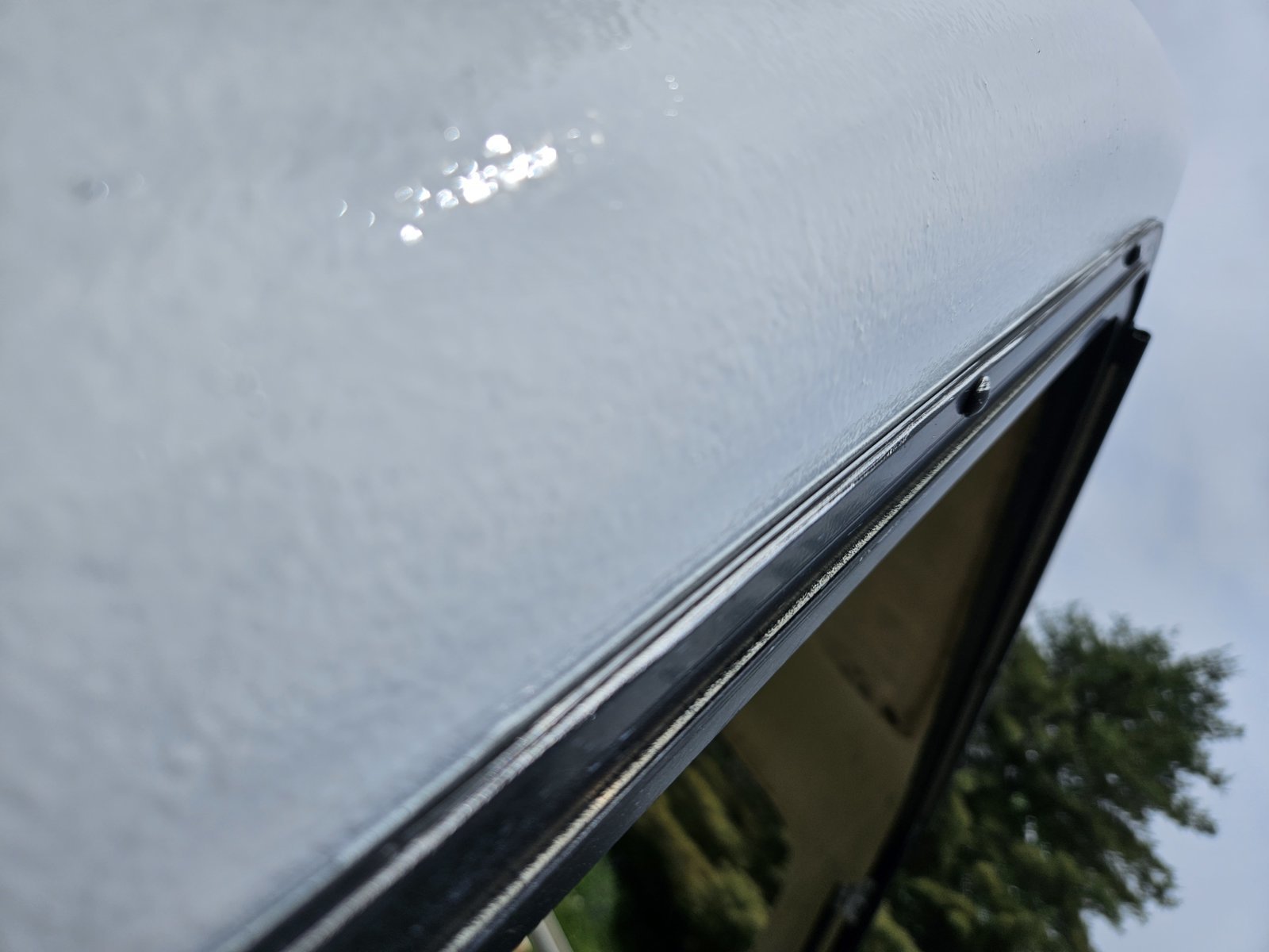

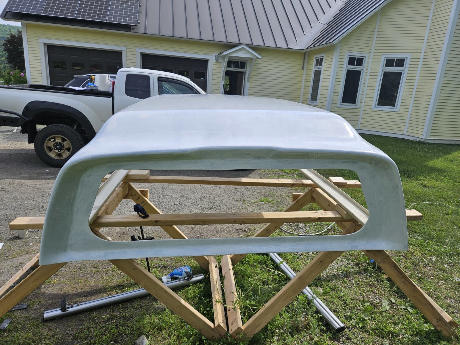

    20240606_104307.jpg 20240606_104313.jpg 20240606_104345.jpg 20240606_104340.jpg 20240606_104323.jpg

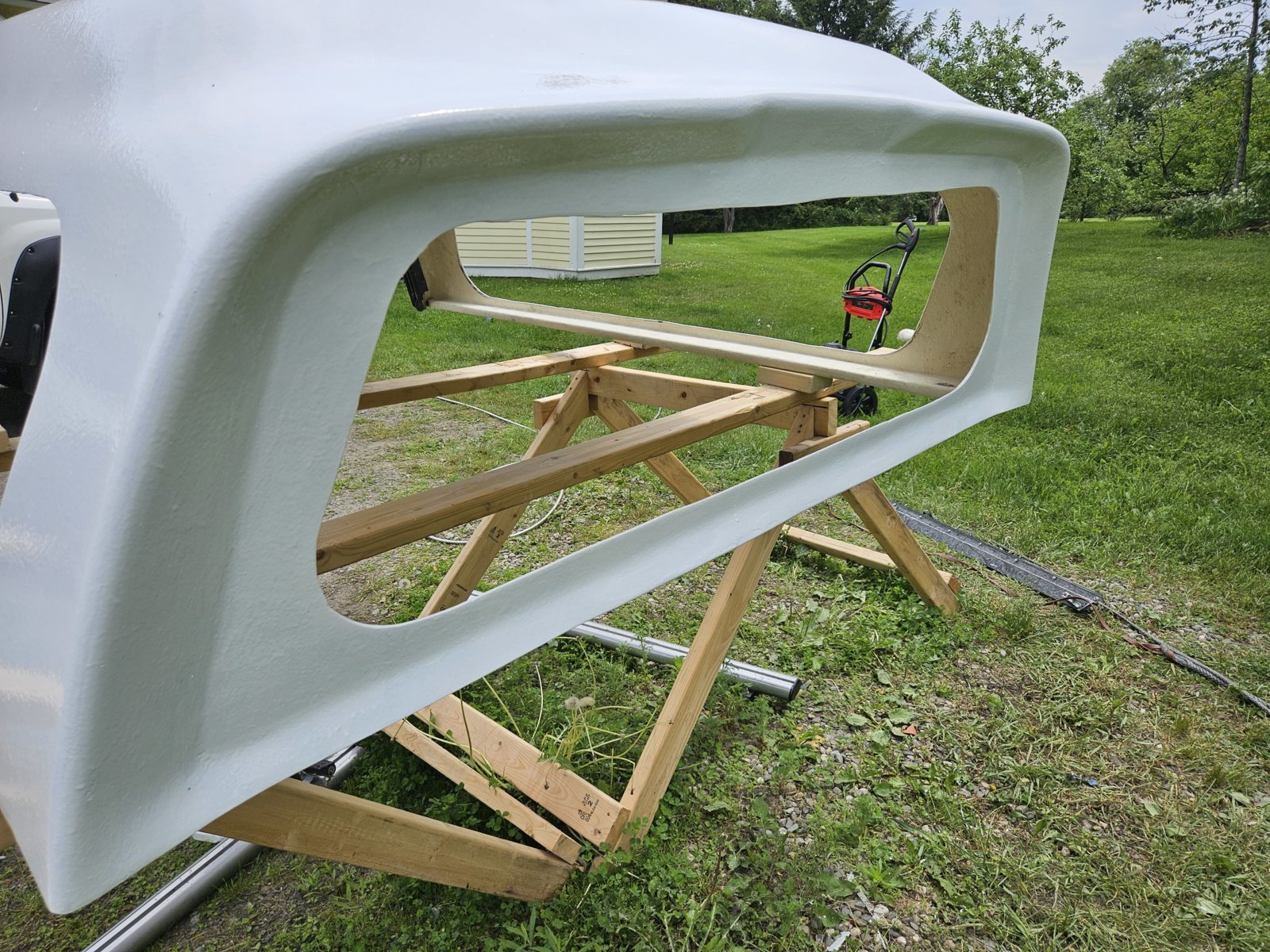

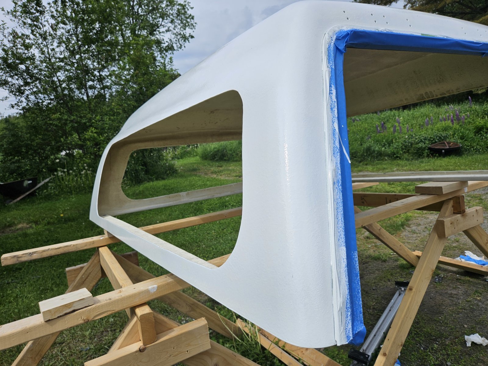

    Second coat. I am inclined to accept this pending another good look in an hour or two.

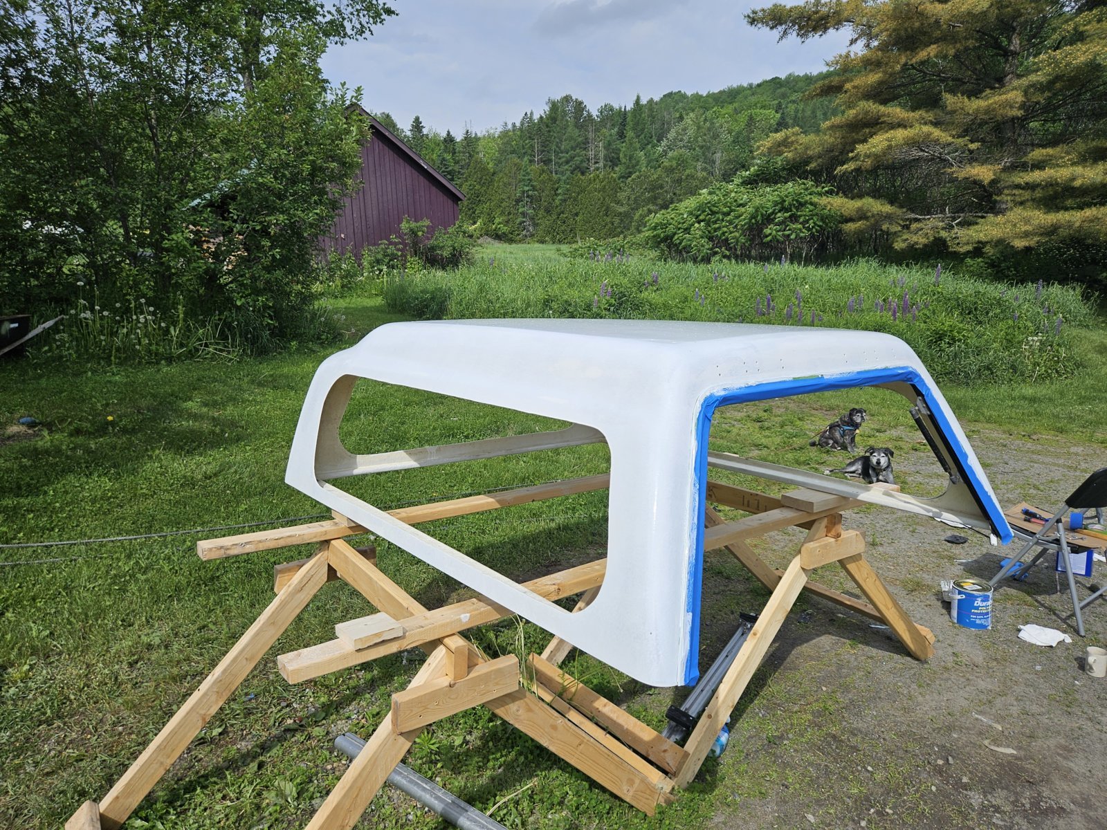

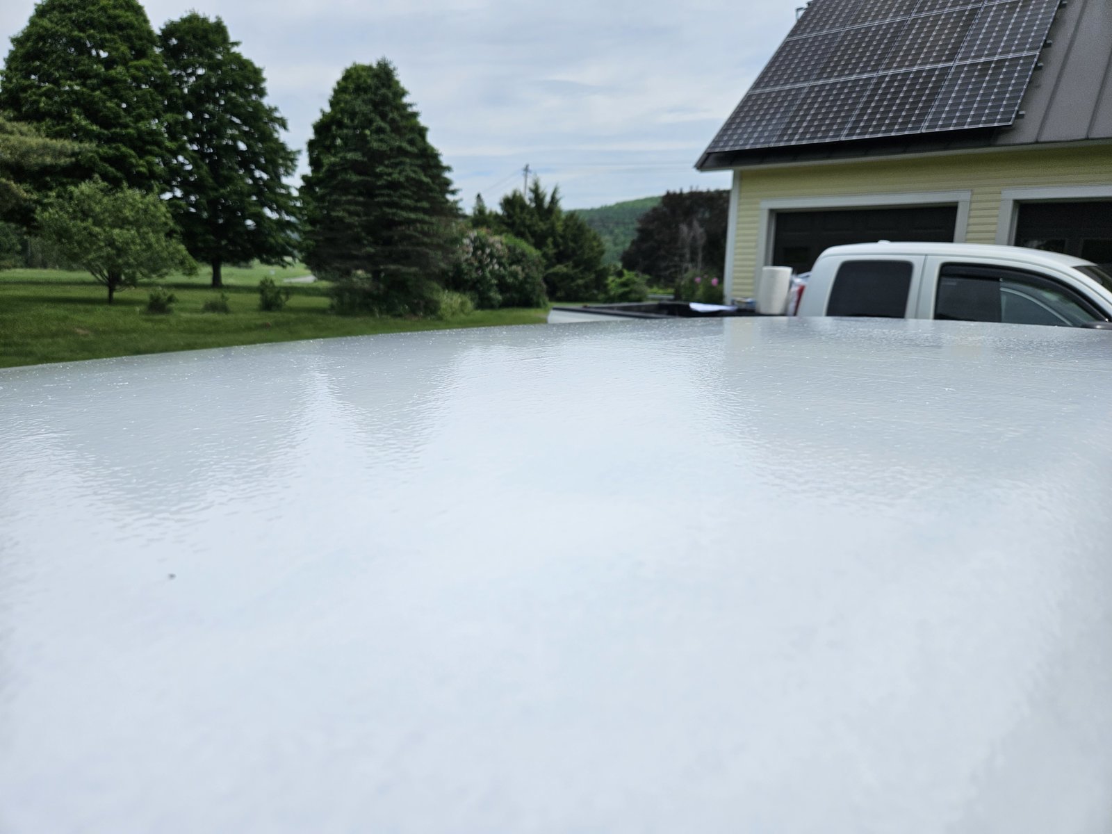

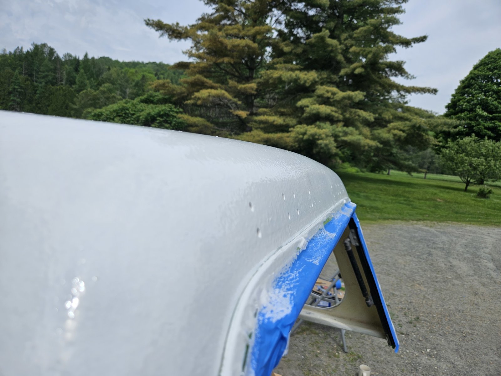

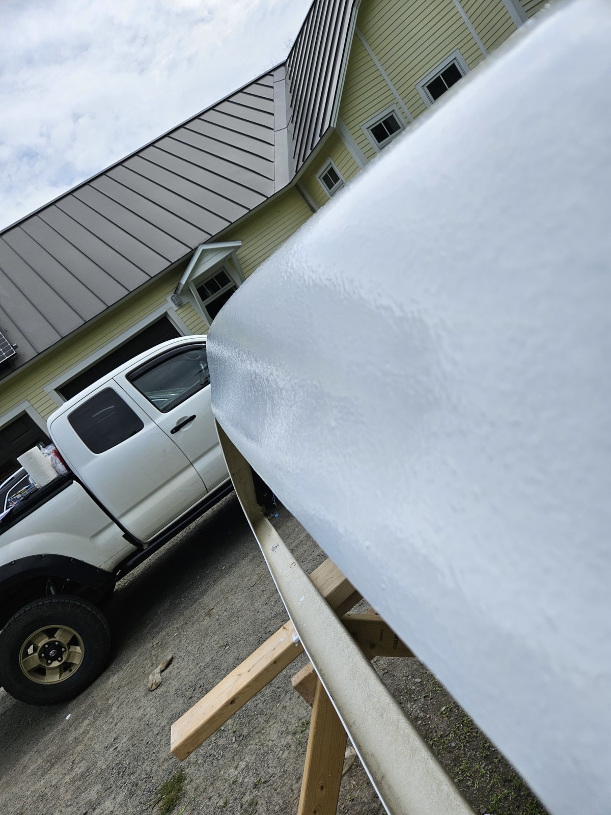

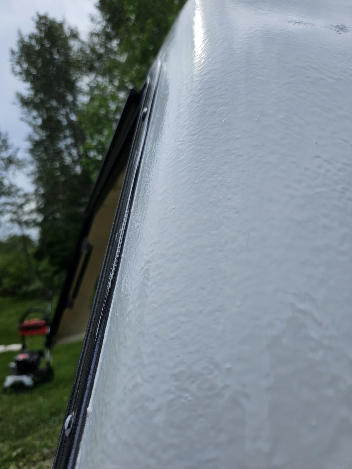

    Yeah you know what, I'll take it. Are there some bugs? Yep. But I dug them out as best I could by checking every few minutes and doing a round with the fine tweezers, and I didn't see any that were deep enough to make me think fucking with them would do more good than harm.
    The mask lines came out way, way better than I was expecting, I really pulled the tape at the perfect time. Only a few tape floofs to carefully pick away from the wet edge. The seams will be getting a seam of FIPG on the exterior after painting the frame (with a perpendicular mask line to the durabak)
    Bonus shot, look at how ugly the front face was in the 1st coat pics. It turned out perfectly acceptable. There was a minor amount of fussing with it after the 1st coat pic was taken, but not enough to make me want to take another Pic.
    I can put one more coat on the corners and edges tomorrow morning, I'll update if I do. I'll let this cure for a week at least before I do any more exterior work. This will give me time to get the liner made and installed.
