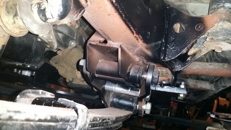

    @malburg114
  13. Mar 22, 2016 at 3:47 PM
    #193
    malburg114
    malburg114 Well-Known Member
    Dec 26, 2012
    #93766
    3,816
    Las Vegas, NV
    2001 Toyota Tacoma TRD

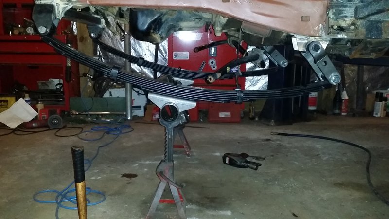

    Have any of the rear front mount?
  14. Mar 22, 2016 at 4:07 PM
    #194
    ToyRyd04
    ToyRyd04 [OP] Taco Transformer
    Aug 5, 2011
    #61217
    1,884
    Greg
    Perryville, MD
    '04 PreRunner
    SAS'd PreRunner Diamond Axles Crawlbox
  15. Mar 22, 2016 at 4:25 PM
    #195
    malburg114
    Dec 26, 2012
    #93766
    3,816
    Las Vegas, NV
    Thanks. Those are exactly what I was looking for.
