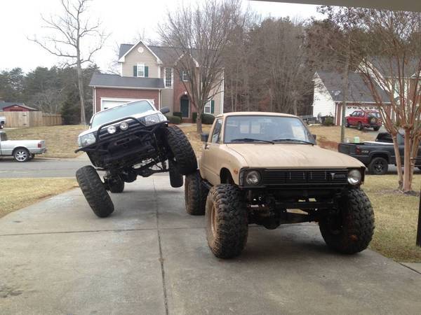

    I'm running 63's on mine. At first they didn't work worth a damn. I'm extremely light in the rear and they just would not move so I inboarded them and they are working very well now but I have some excessive body roll.
    Best before pic I can find. Couldn't even get on a 37" without lifting
    And this was a few weeks ago

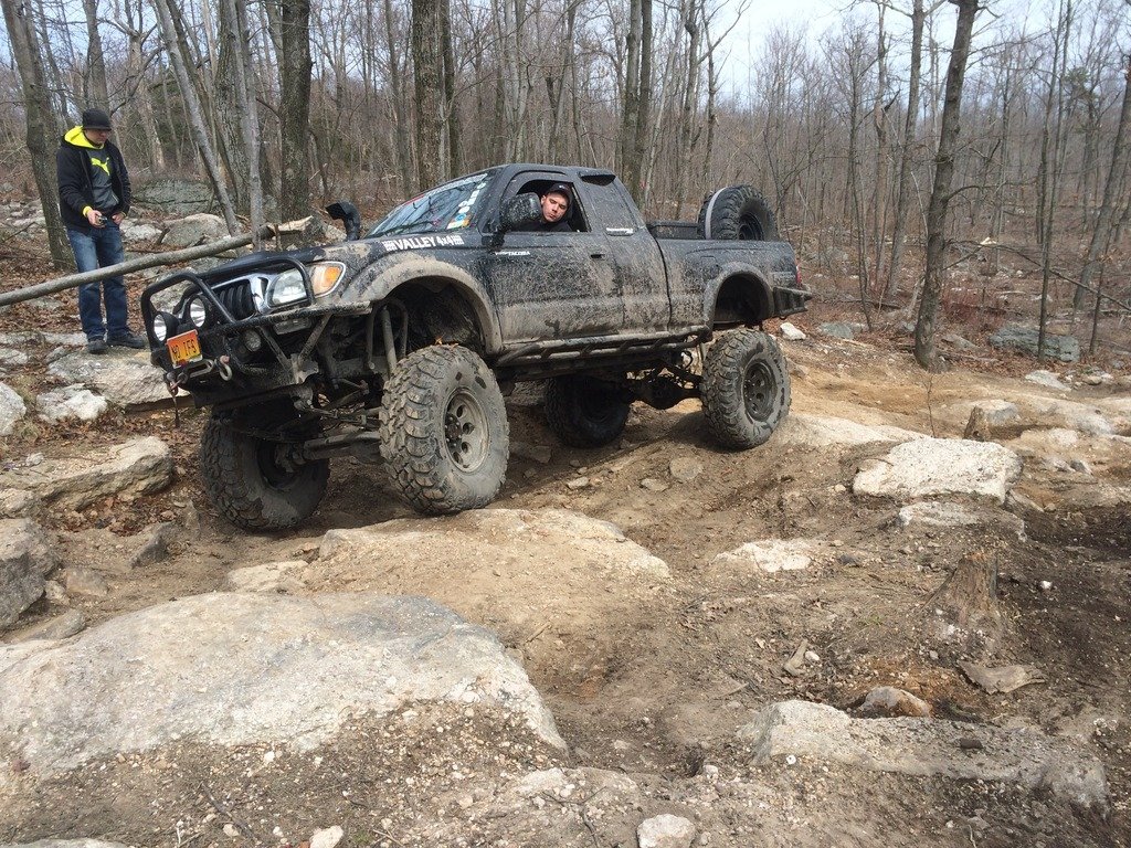

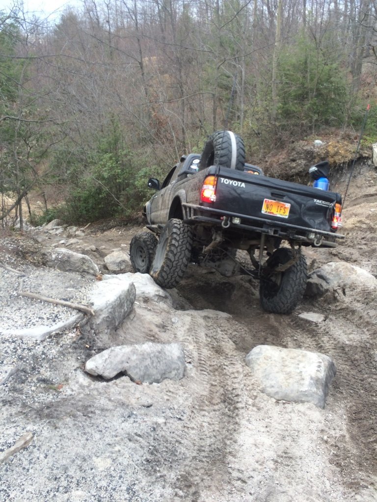

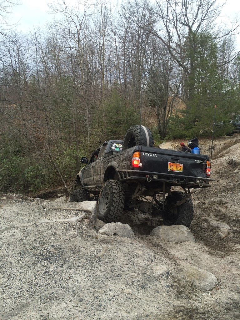

    Got a couple photos of you from Rausch Creek last week after you met us on the trail.
    Flex game strong :thumbsup:
