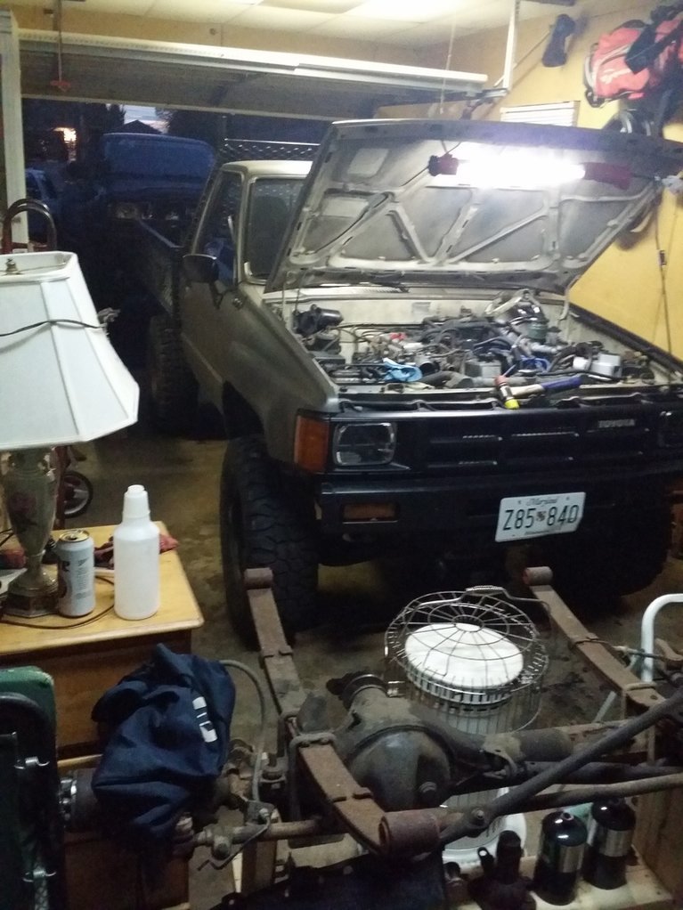

    Turbo tonight, my leafs tomorrow.

  2. Apr 1, 2016 at 5:14 PM
    #222
    cynicalrider
    cynicalrider #NFG
    Jul 25, 2012
    #83399
    17,161
    Jersey
    01 SR5 TRD 4x4, '23 Bronco Wildtrak, 2017 HSQV FE350
    Drop bracket lift and booger welds
    For the rear?

    Yup, pulling a leaf or two before deciding of going to chevy 63s.

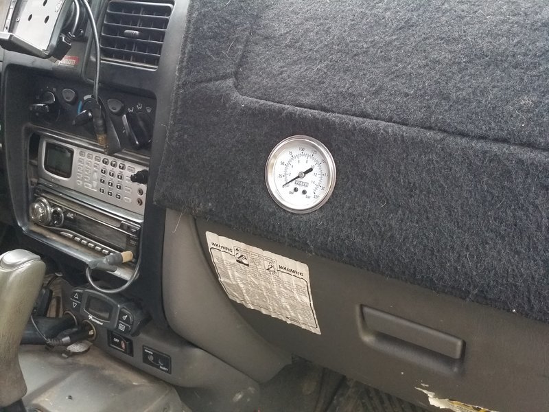

    Been awhile since an update, decided to pull the trigger on a chevy 63 swap kit. Also a/c had a leak somewhere, didnt feel like chasing it since the half doors are usually always on during the summer. So OBA conversion happening as well.
    Don't hate on the dashmat, helps hide those wires.:D

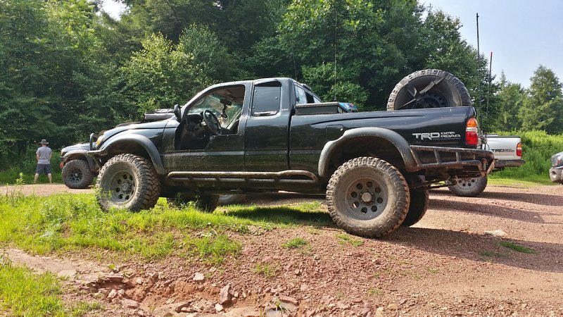

    Have any pictures of your half doors? Going to try to trade some of my ifs take off stuff for some.

    Got a pic before the swap. @malburg114
  16. Jun 17, 2016 at 6:25 PM
    #236
    malburg114
    malburg114 Well-Known Member
    Dec 26, 2012
    #93766
    3,816
    Las Vegas, NV
    2001 Toyota Tacoma TRD
    Nice! Did you cut the pin out and replace it with a quick release type pin? And do you have automatic windows and locks? Just wondering how hard they are to swap.
  17. Jun 17, 2016 at 6:32 PM
    #237
    ToyRyd04
    ToyRyd04 [OP] Taco Transformer
    Aug 5, 2011
    #61217
    1,884
    Greg
    Perryville, MD
    '04 PreRunner
    SAS'd PreRunner Diamond Axles Crawlbox
    Nope, actually modified hinge brackets on the factory and half doors. You can notch 1 of the top and 1 bottom hole to slide onto the bolts screwed into the body. Which makes install alot easier.
    I do have power windows and locks, there are disconnect plugs right near the door openings behind the kick panels. Easy to remove, after they are unplugged just switch the inside dome light to off and then your set.
