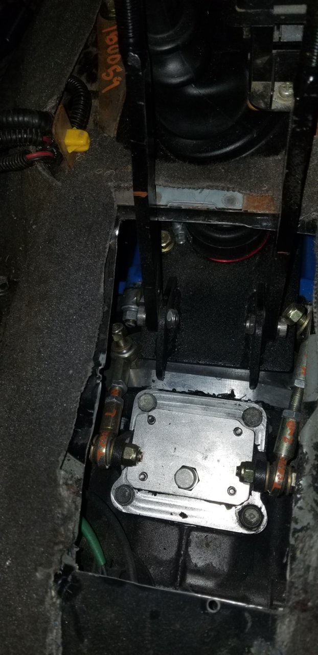

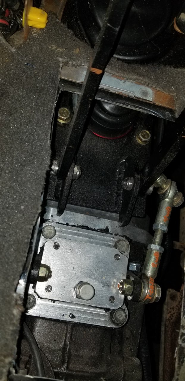

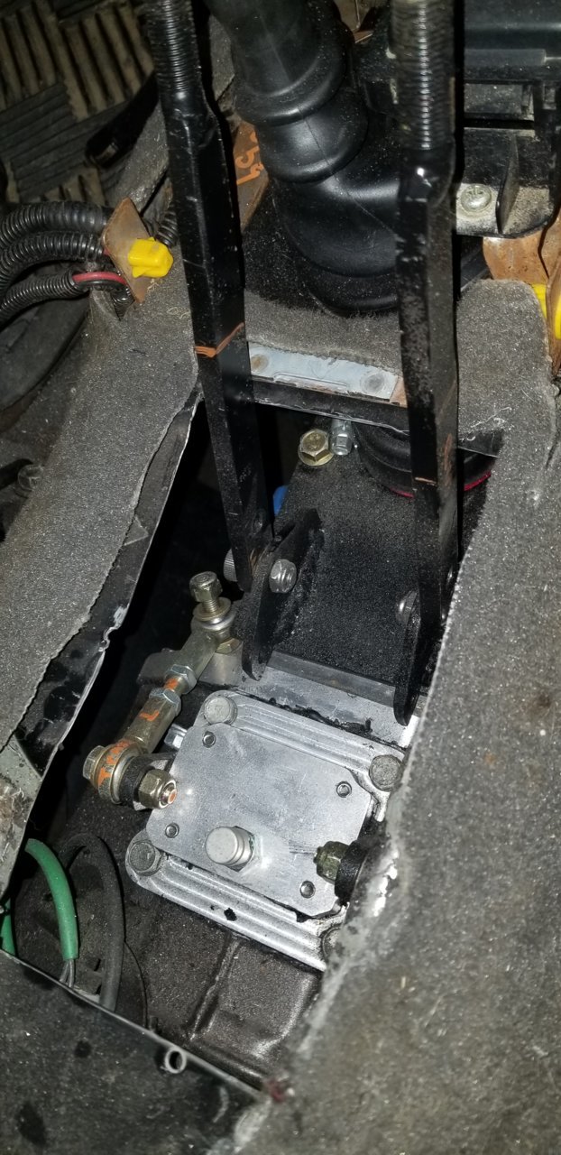

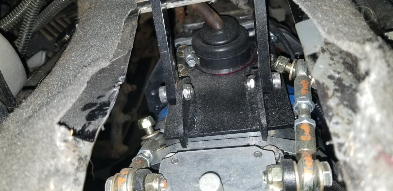

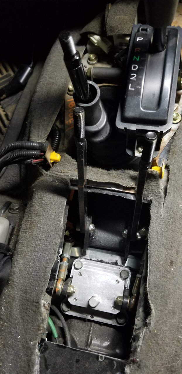

    Finally got the interior with shift boots and console in. Everything works great, happy with the results.20180928_220925.jpg
    And a couple pics of the linkage and new plate I made underneath to make it all work.

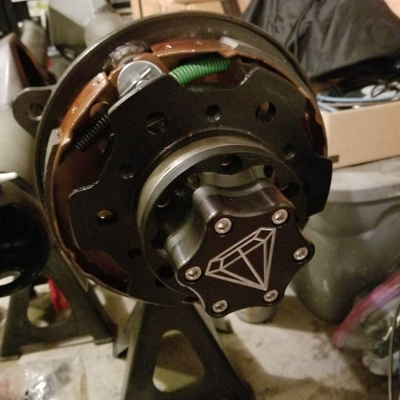

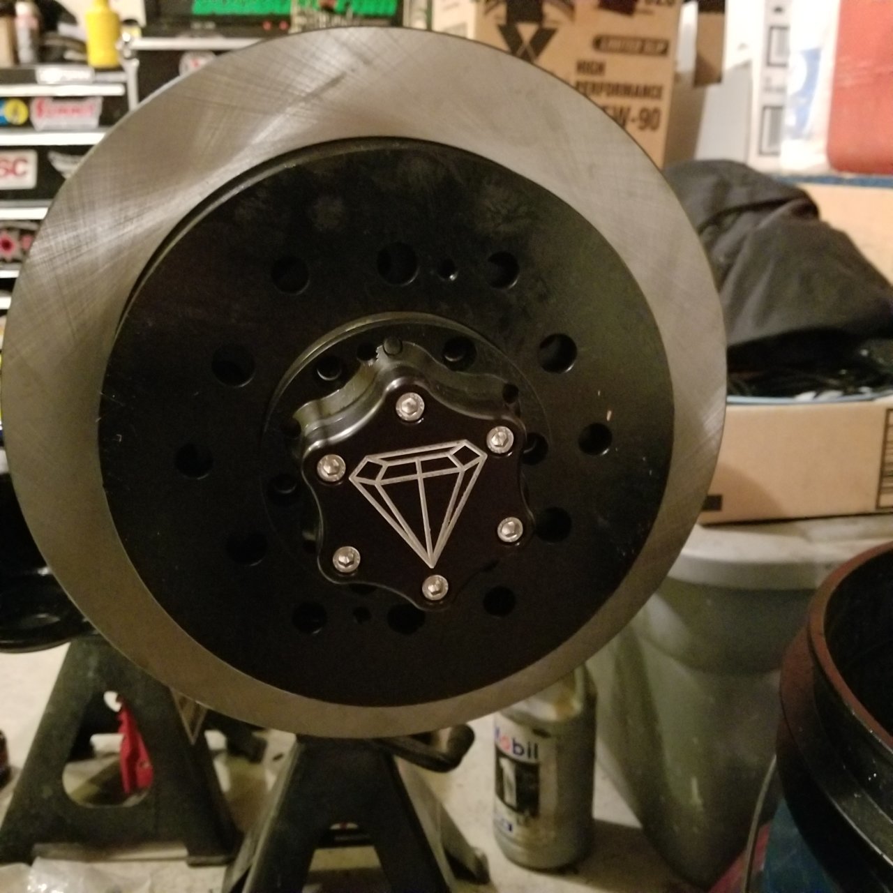

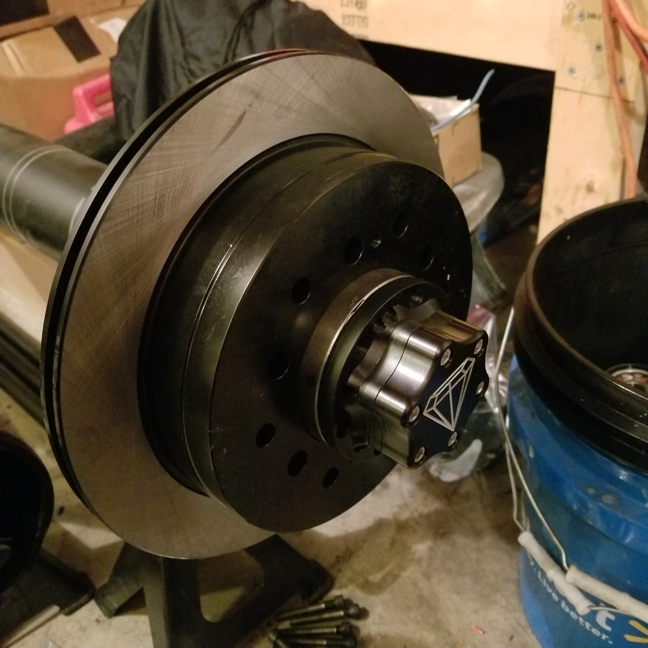

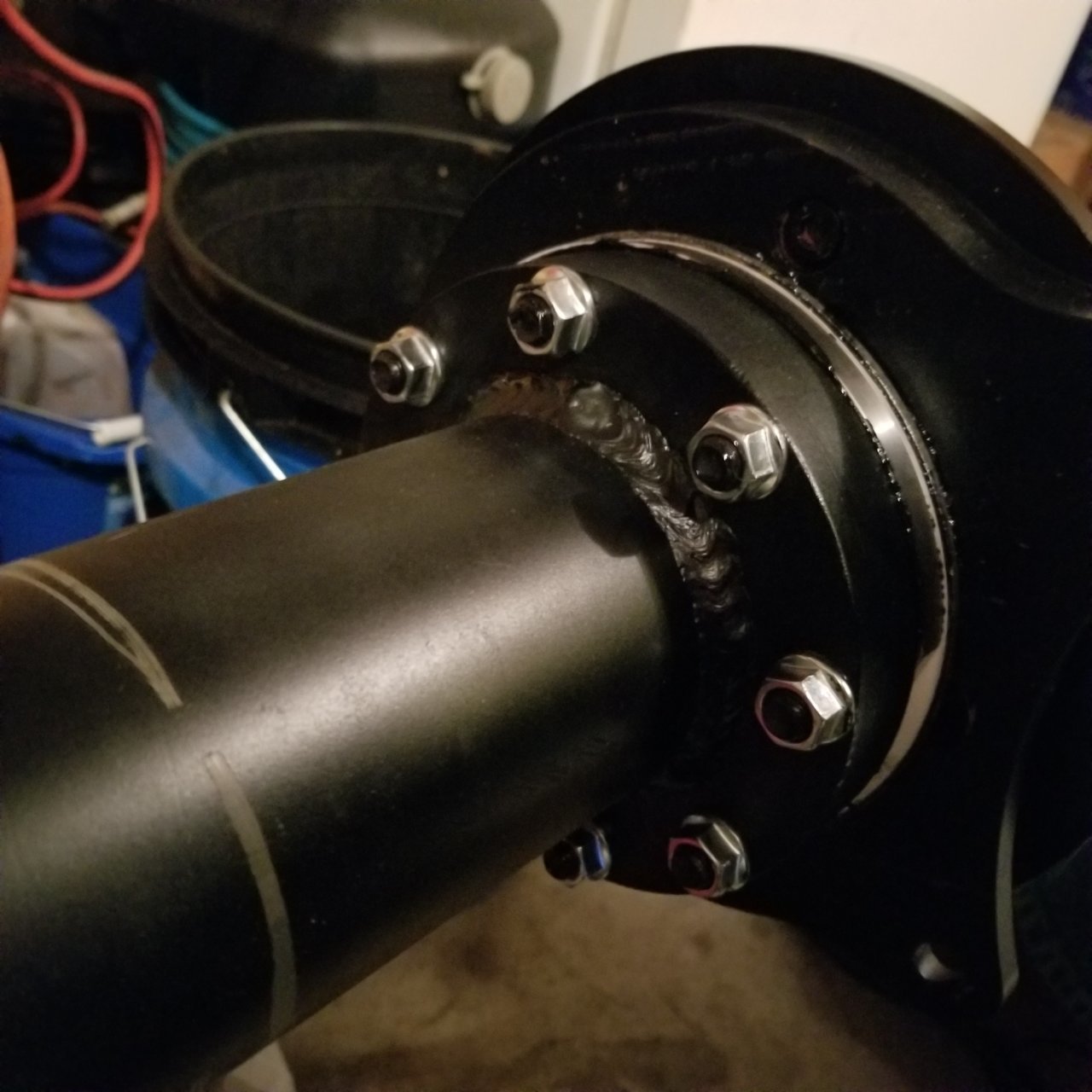

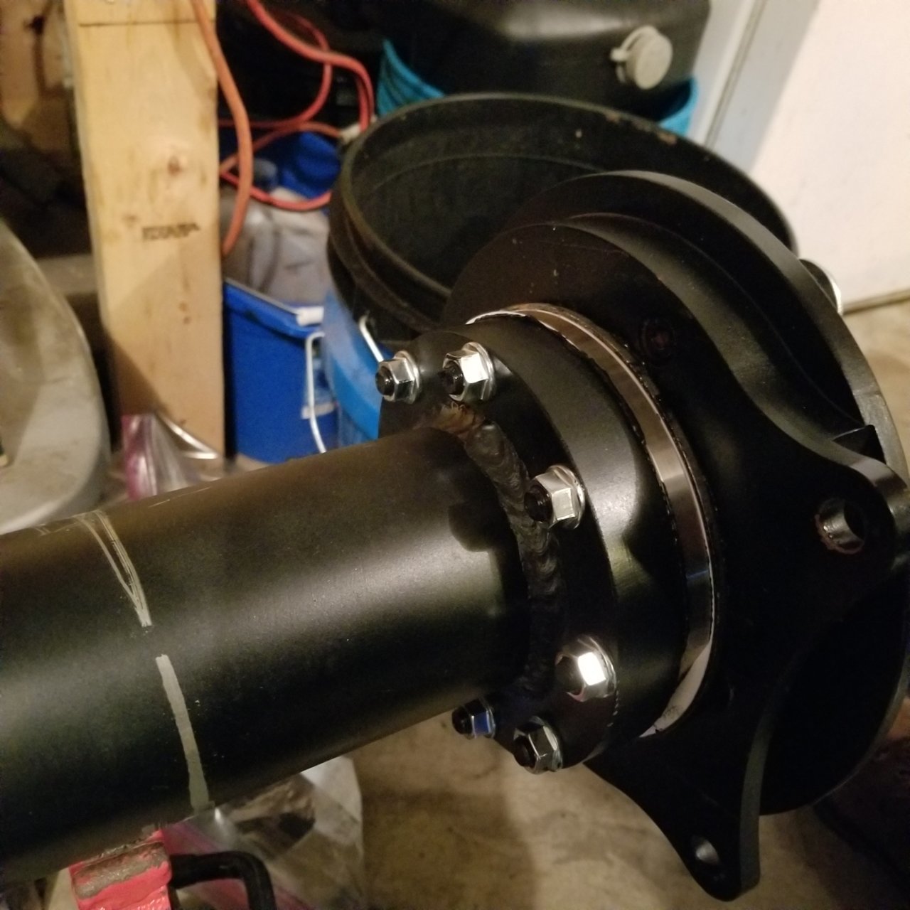

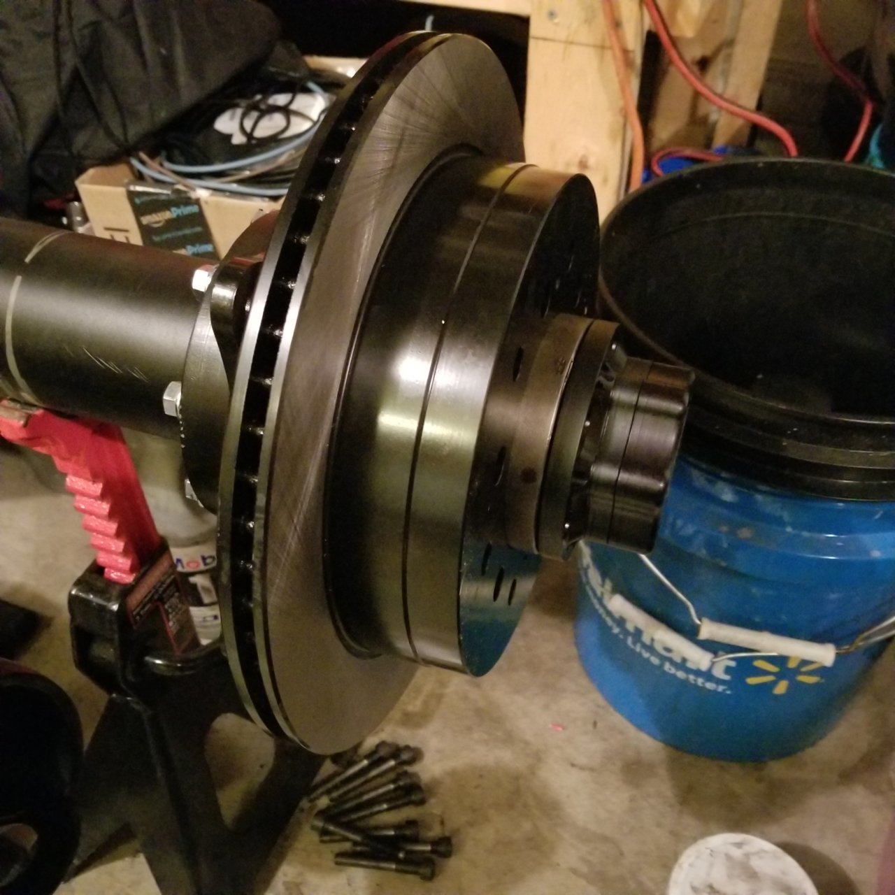

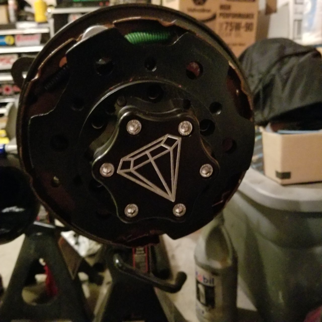

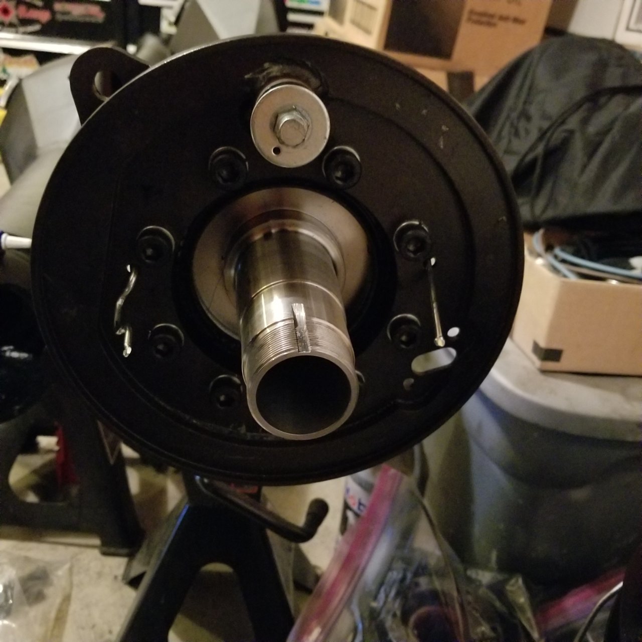

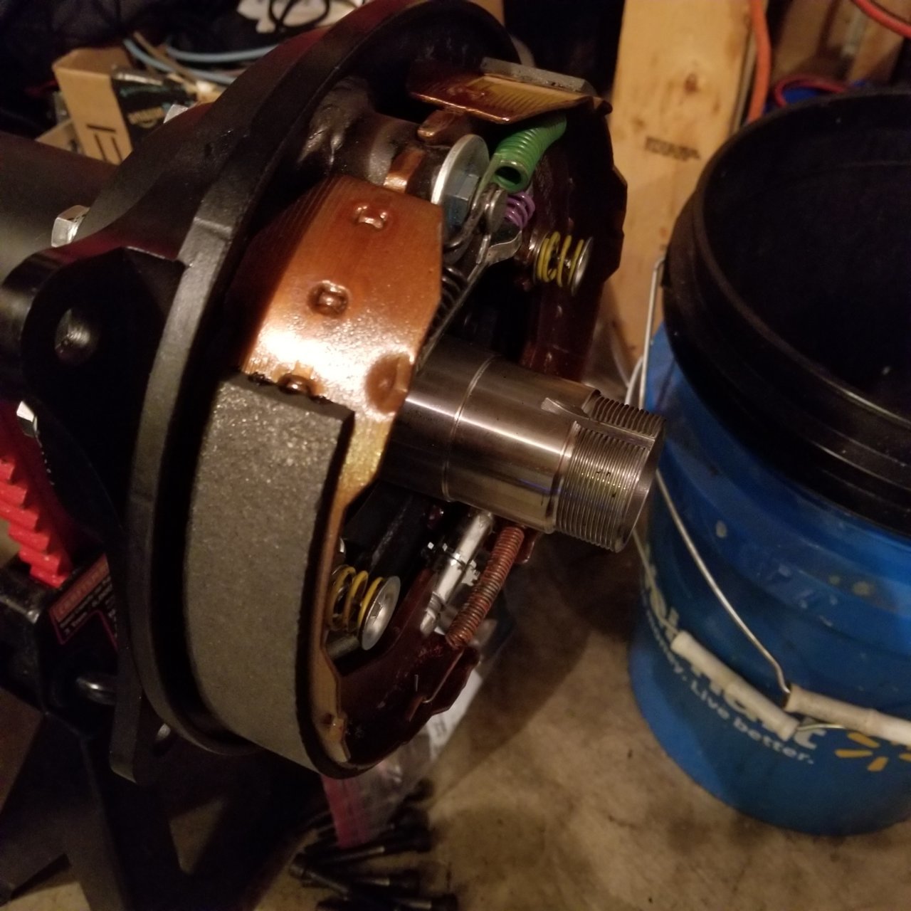

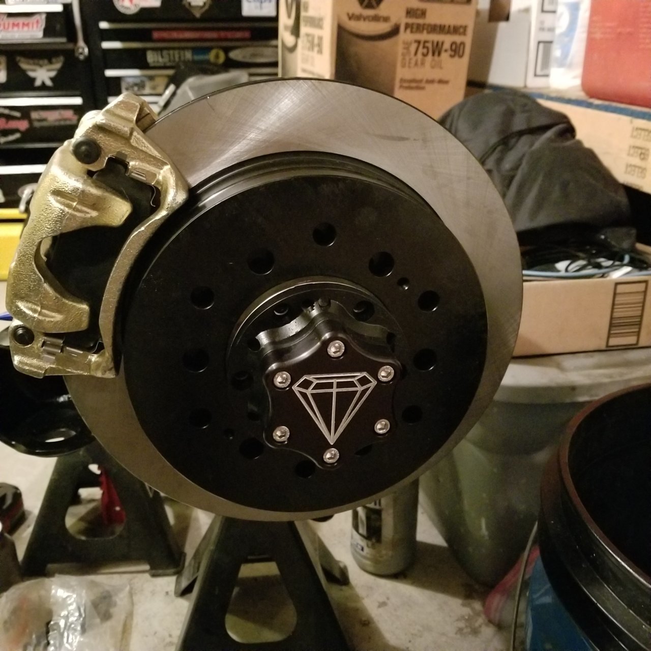

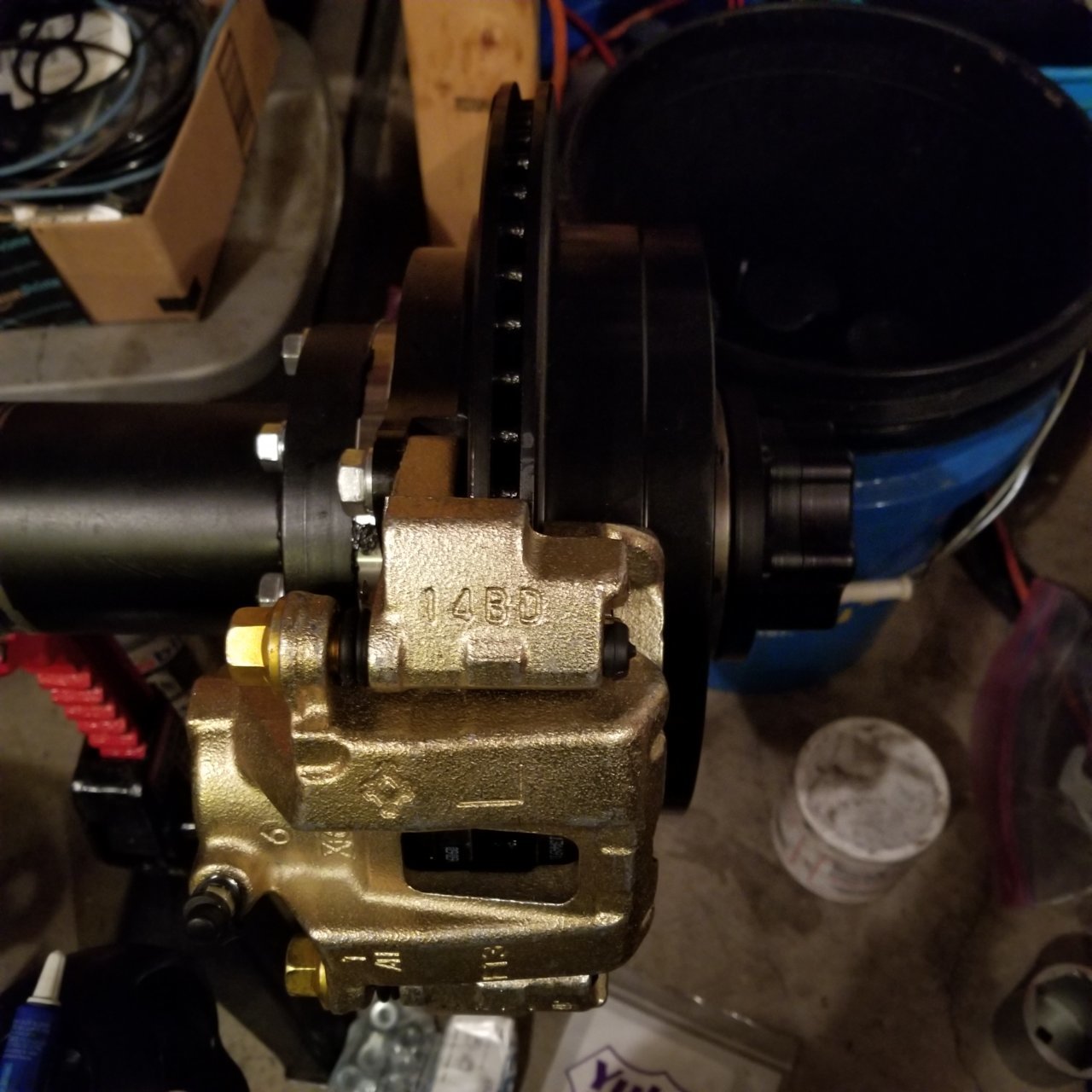

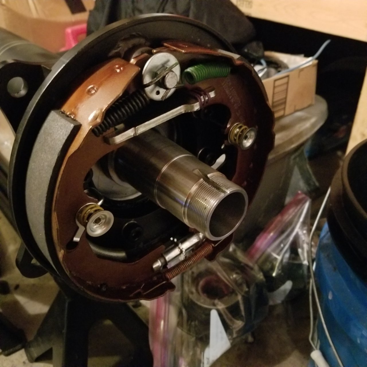

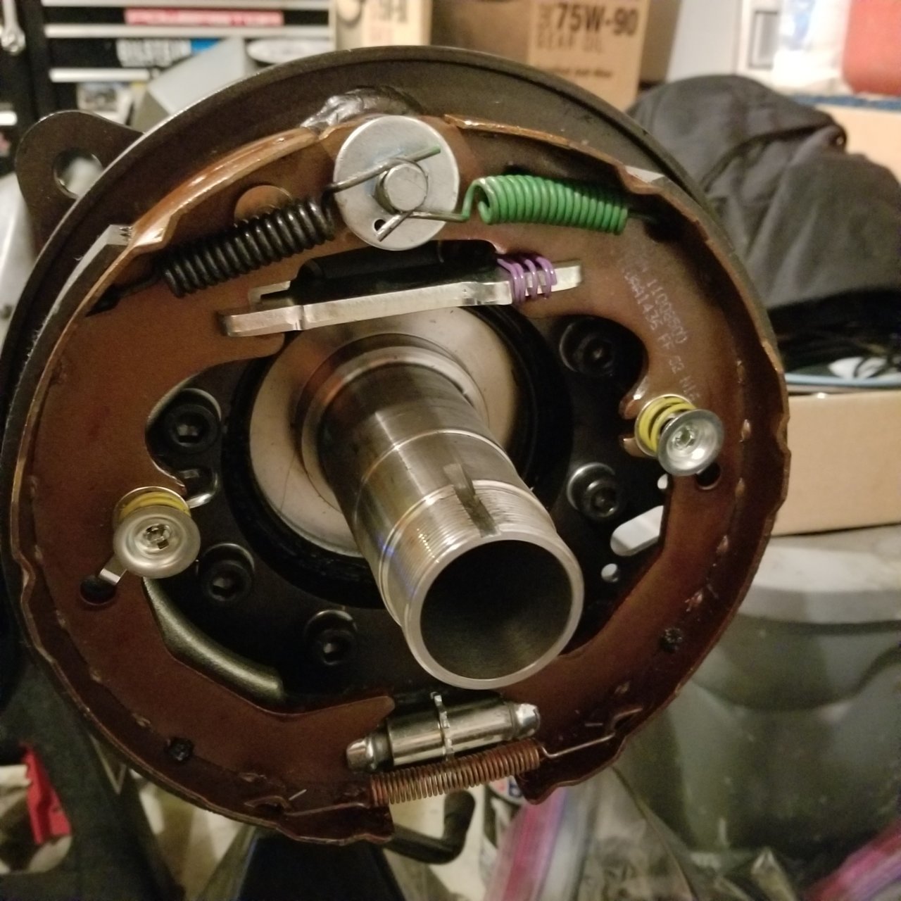

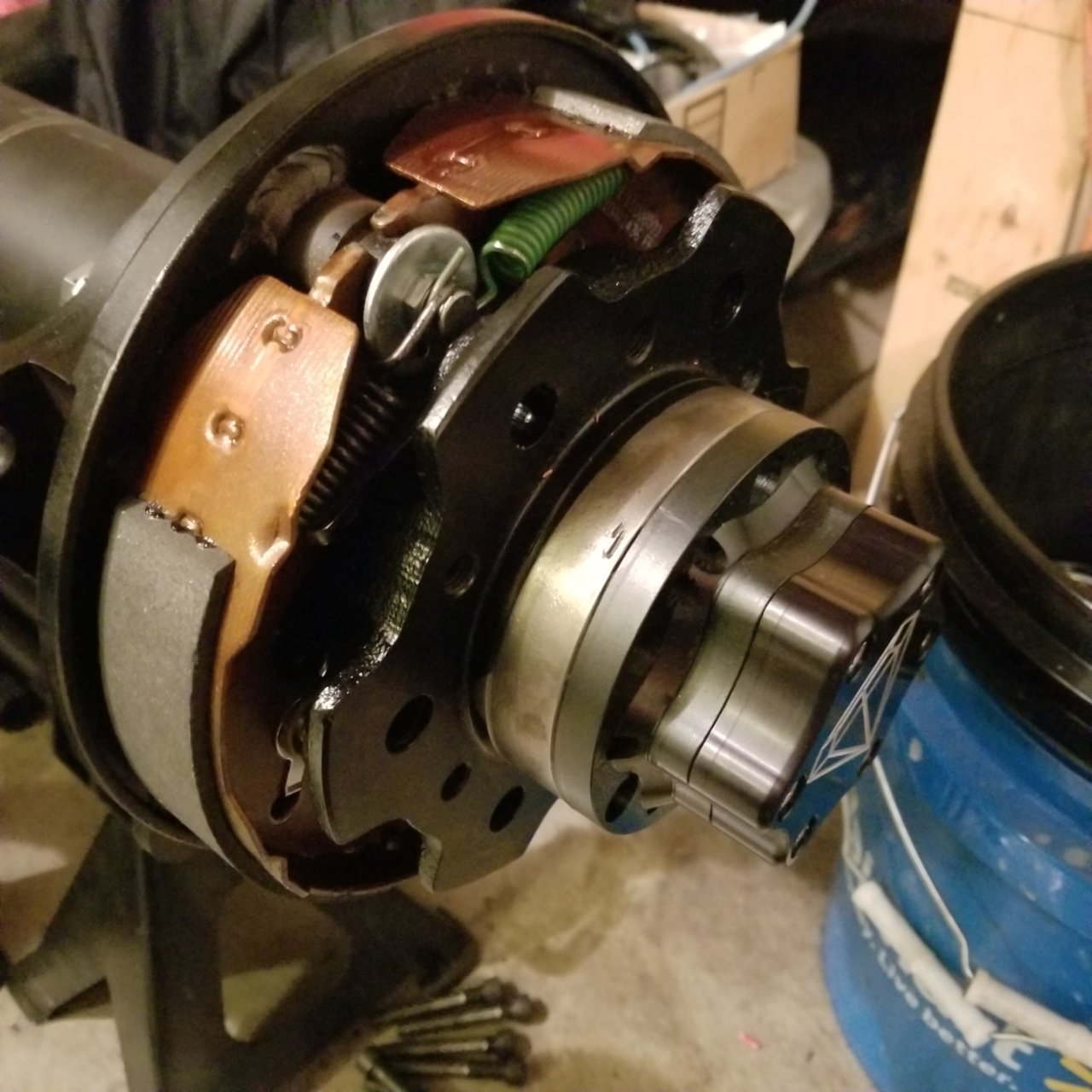

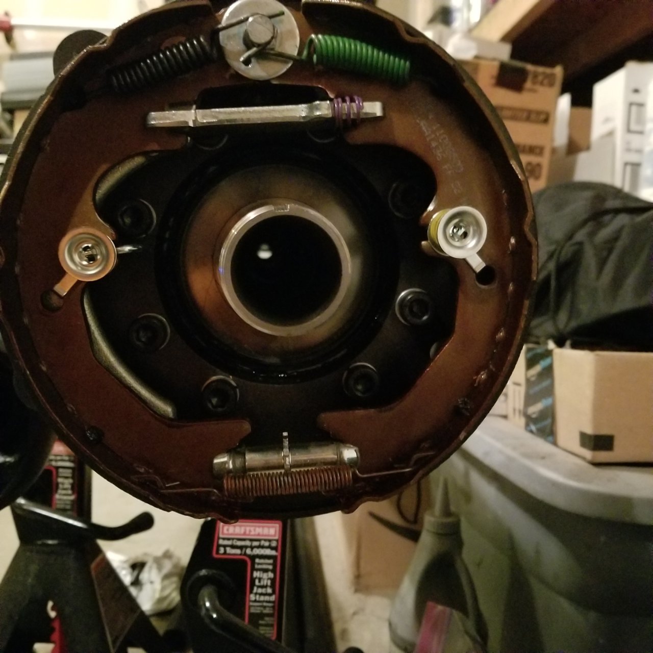

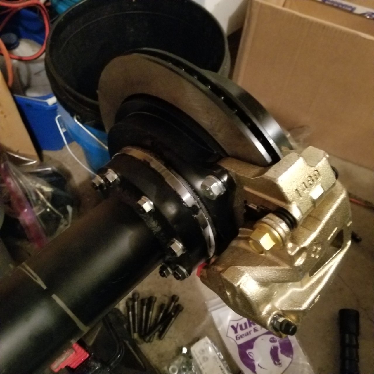

    Finally starting to make progress on the rear FF axle.
    Specs:
    68" wms
    3.5" axle tubes
    3/8" wall
    FROR Drotors,Drive Flanges, Alum. Spindle seals
    ARP hub studs
    TG Chromo spindles
    03-16 4runner rear brakes/Parking Brake setup
    86-95 IFS hubs
    Upgraded hardware to 12.9 for the axle flanges with backing nut as a second safety factor.
    Parking brake cables used independently of caliper vs built in style.
    Hubs hit a bit on the p.brake hardware so need to machine them down tomorrow, then measure for stainless flex braided lines and T fitting.
