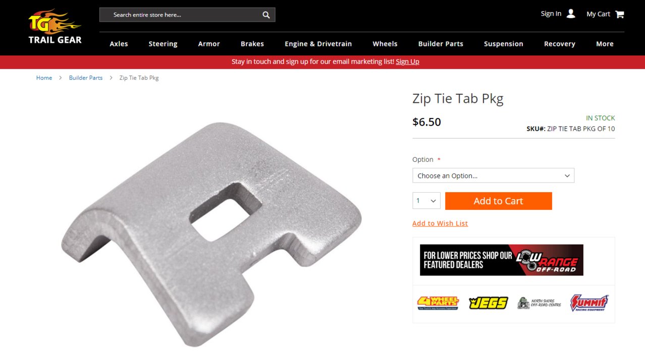

    Where did you get your welded tabs for the lines, Greg?
    I’m doing the same project that @cynicalrider is doing and I’m going to at least attempt to bend my own lines if I have to. But if that goes to shit, it would be nice to have a backup plan.
    Thanks!

    Hey Jason,
    Orginially was going to buy from TMR but they are pretty expensive for what they are. I actually found on TG that they sell flanged brakeline tabs. I like the fact that they have a 90* bend to help protect and locate the line a bit better. Bit cheaper too. I usually order TG stuff through Summit Racing now to get a discount, and quicker/closer shipping. Then I picked up some stainless steel zip ties vs using plastic ones.
    Summit - https://www.summitracing.com/search?SortBy=BestKeywordMatch&SortOrder=Ascending&keyword=303534-KIT
    TG - https://www.trail-gear.com/builder-parts/zip-tie-tab-pkg.html

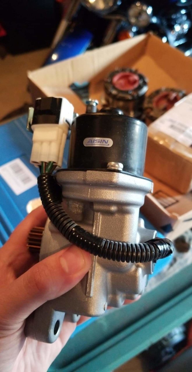

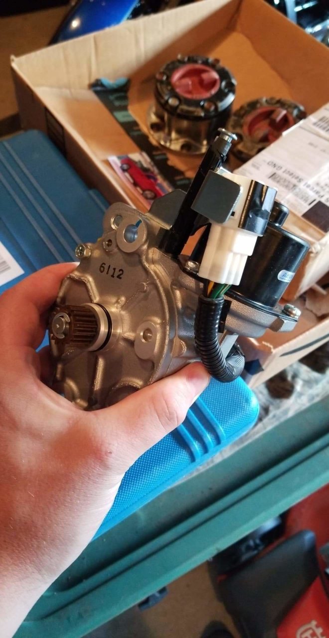

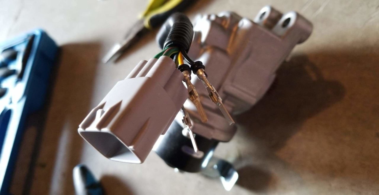

    So a couple of weekends ago, the recently rebuilt elocker stopped working again. Figured its had a hard 15years, another one is due.
    Couldn't believe the prices on these things, had to be a cheaper, yet finding a quality part somewhere. That cable driven option...too expensive for what it is.
    So that had me researching around. As we all know or now know, FJ80 front HP elockers are very similar to Tacoma LP elockers. More so the elocker motors are very very similar yet price differences are very different.
    On RockAuto:
    FJ80 front HP Aisin actuator - Aisin SAT002 - $230 & higher.
    Tacoma rear LP Aisin actuator - Aisin SAT008 - $312 & higher.
    After some research through fsm and some LC forums. I found the wiring should be the same minus a use of a different connector between the HP and LP actuators.

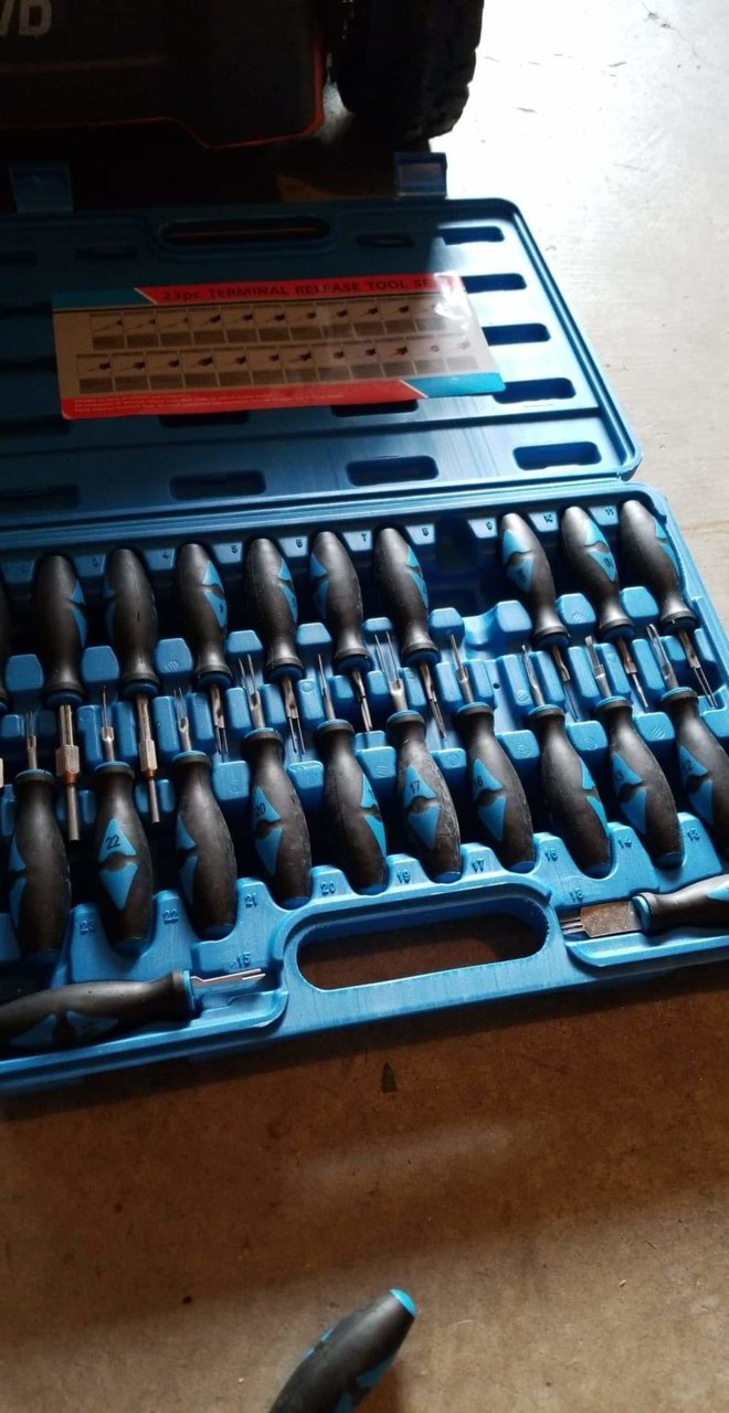

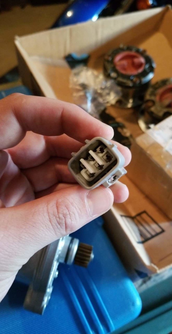

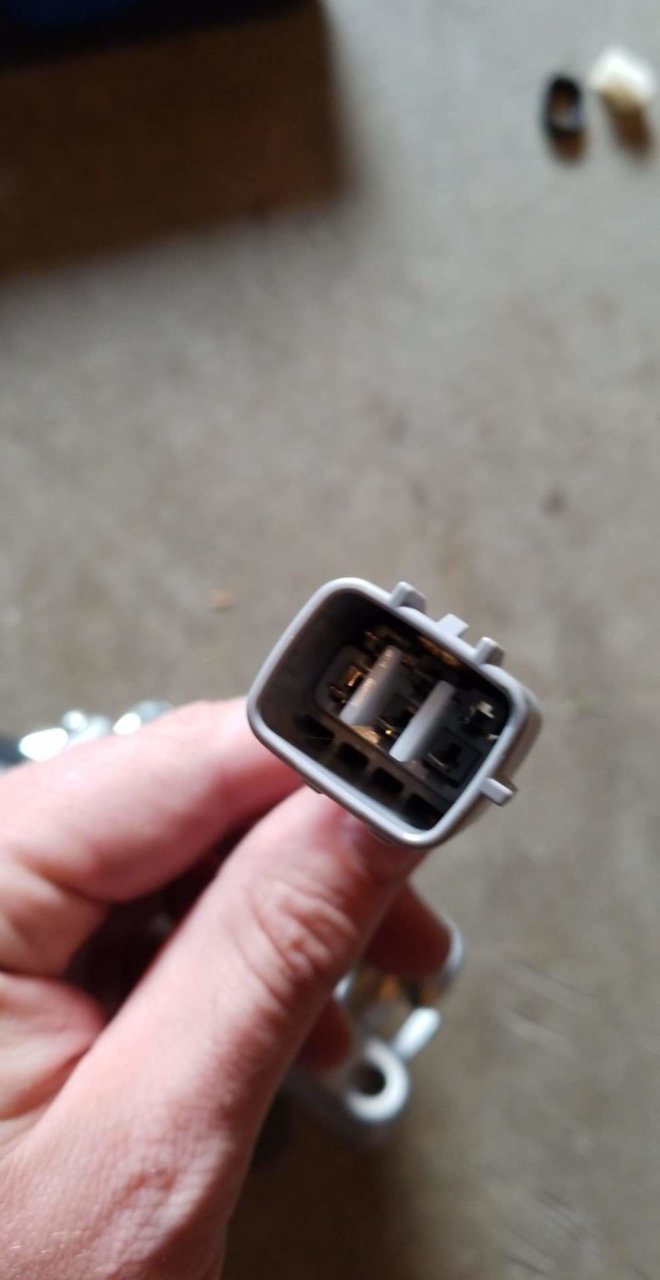

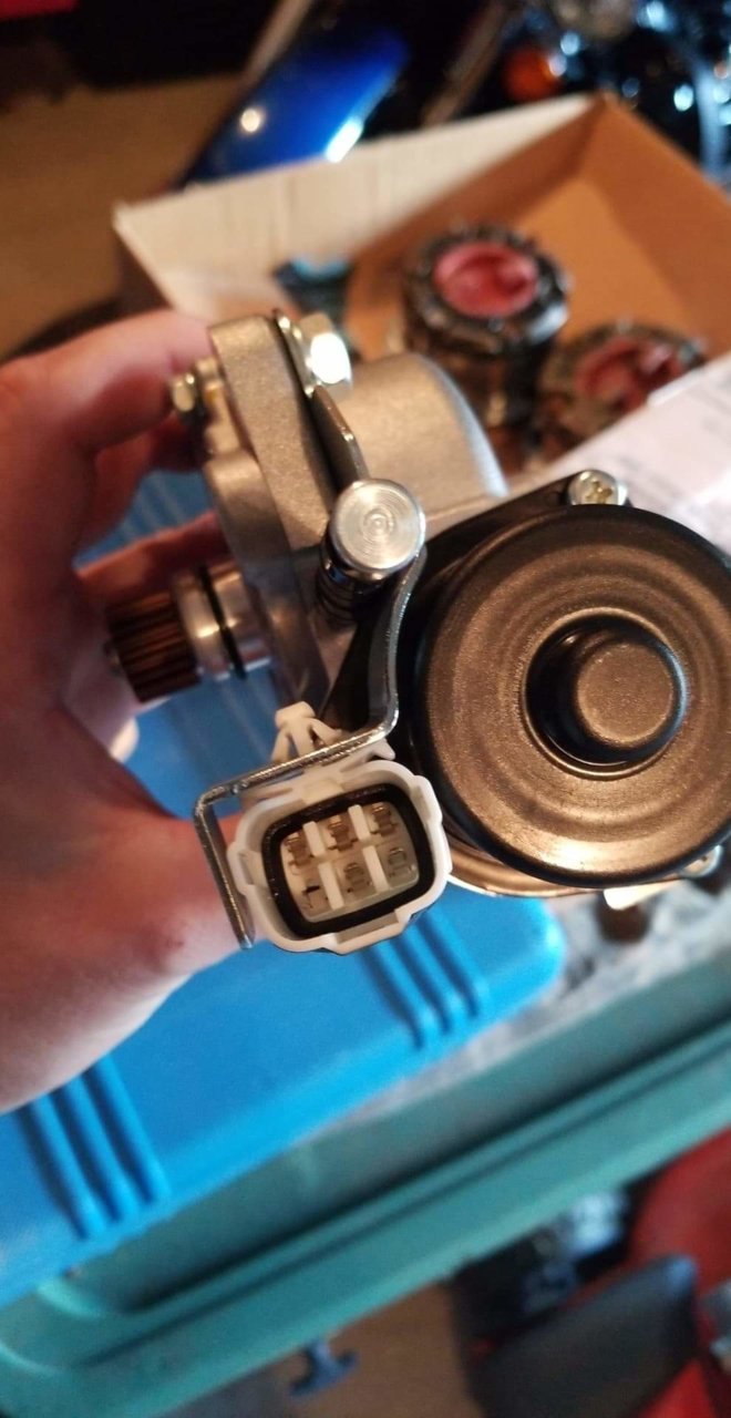

    Below are a few pics, basically swapped over connectors, plugged in and go. So for $230 and 5mins of your time, you can have a working actuator without the price tag of the drop in Tacoma actuator.
    Picked up a new OEM Toyota connector while I was at it. Part# M 90980-11193 (M designated Male connector)
    received_1173685562831819.jpg received_380258315936692.jpg received_2228452963907948.jpg received_2402208170026476.jpg received_419691598582799.jpg received_340305989987024.jpg received_652847158512316.jpg

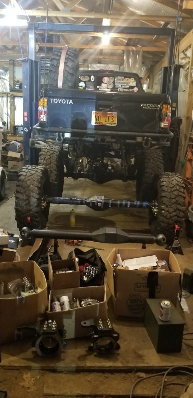

    About time for an update! Stay tuned.
    60wms vs 68wms. Full Float rear.
    MY50cal, slander, malburg114 and 5 others like this.
