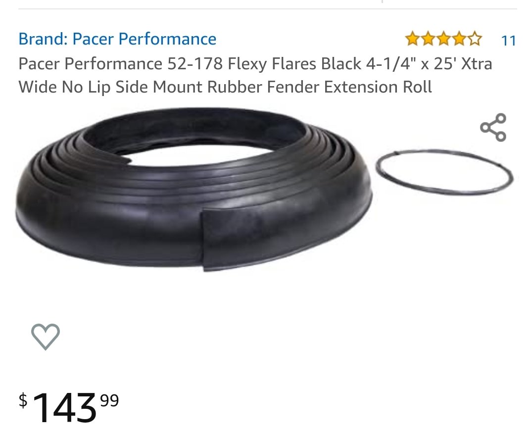

    Went with the 4 1/4" Jason, and to make them mount easily, used the factory platic flare clip holes to bolt them on. One nice thing about these flares is the outer part can fit a small steel rod through and you can "form" these into a flare so it looks more facotry than the garden edging some use that looks awful.

    Yep these are the no lip mount ones. Rubber sounds flimsy but damn if these things arnt solid once formed.
    This is the exact one I picked up. Price fluctuates, but 25' roll will leave you enough to make 5 flares.
    Pic shows that it comes with the wire, mine didnt. Perfect size fit is a spool of drop ceiling support rod slides right in.

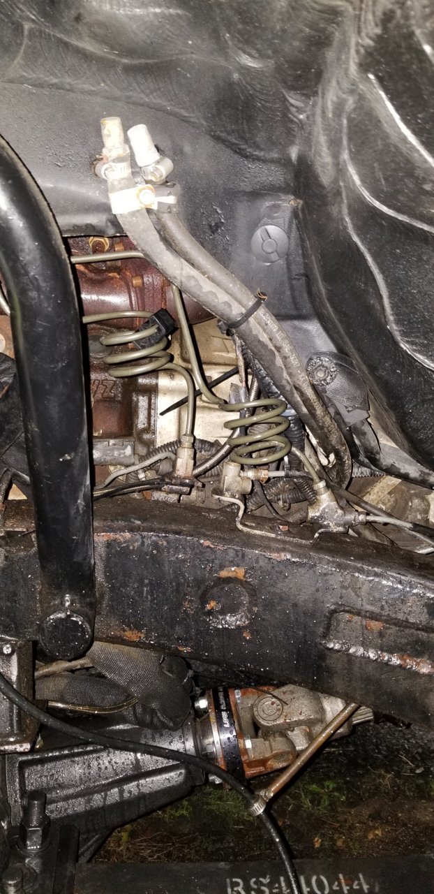

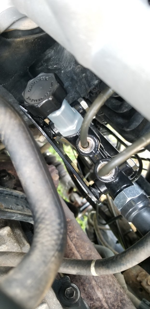

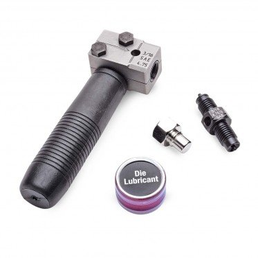

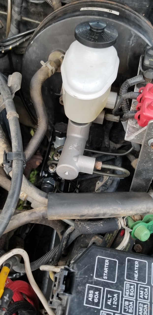

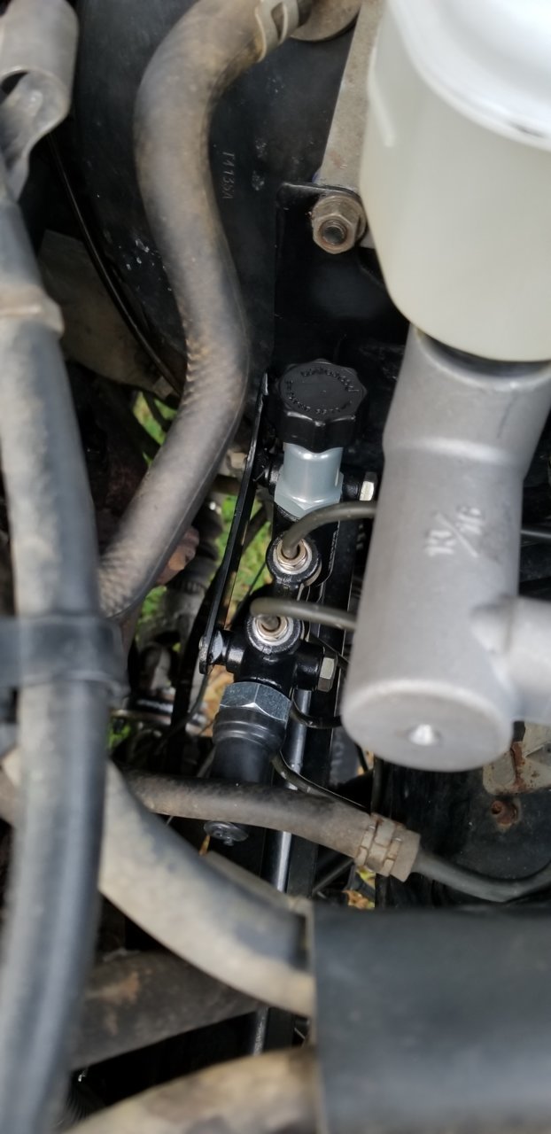

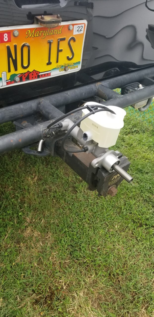

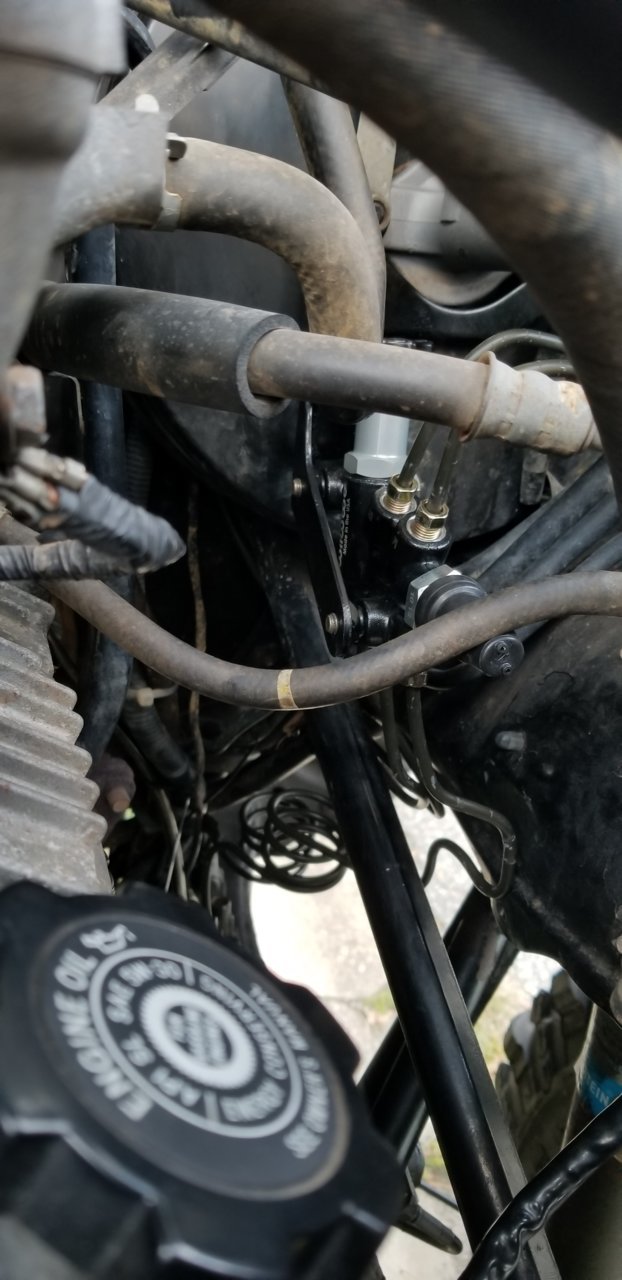

    Finally got the brakes working with amazing pressure. Thing flat out stops with Tundras on the front and now vented 4runner discs in the rear.
    Ended up ripping out the whole abs module (been disabled for years after ifs swapping to non abs 4wd spindles). Had an air pocket I couldn't bleed, so out it went and same with the factory master cylinder.
    In its place a Wilwood 5 port whole system proportioning valve and new master. Decided to rip out all the lines instead of trying to make some work. Actually pretty easy to bend and bought a nice flaring tool by Eastwood, I recommend to anyone as it can make great 3/16" inverted flares both on and off the truck.
