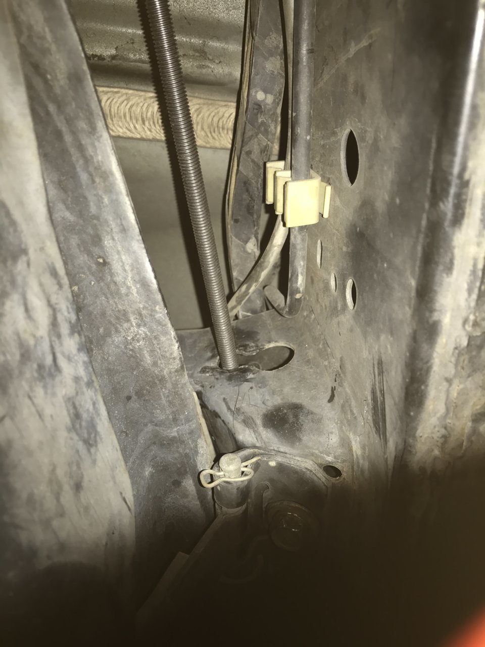

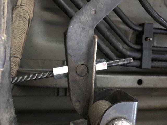

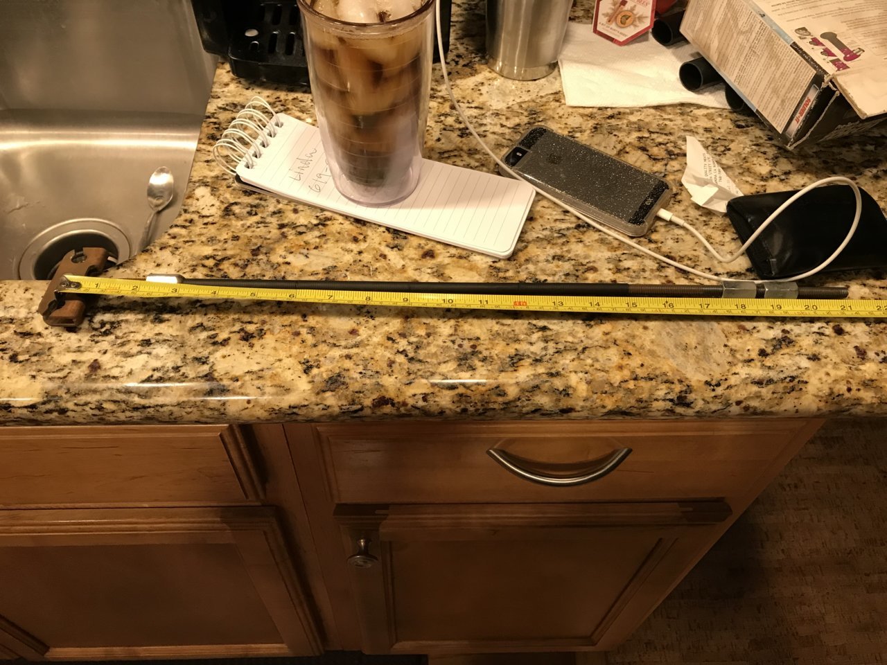

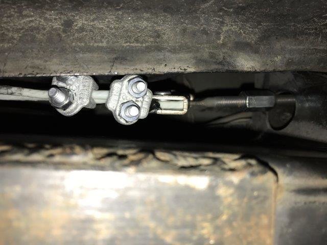

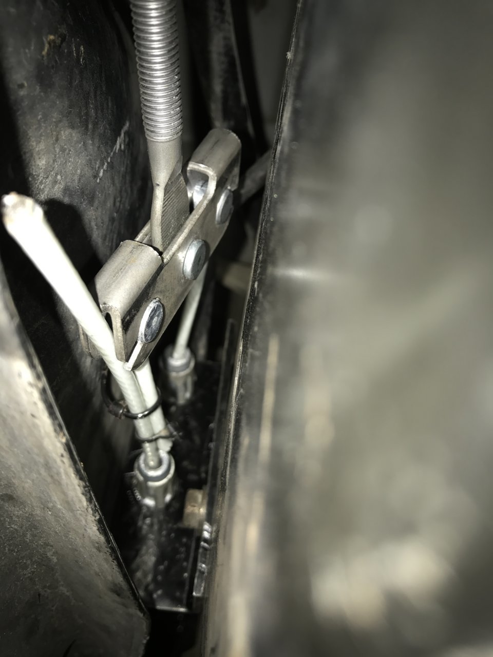

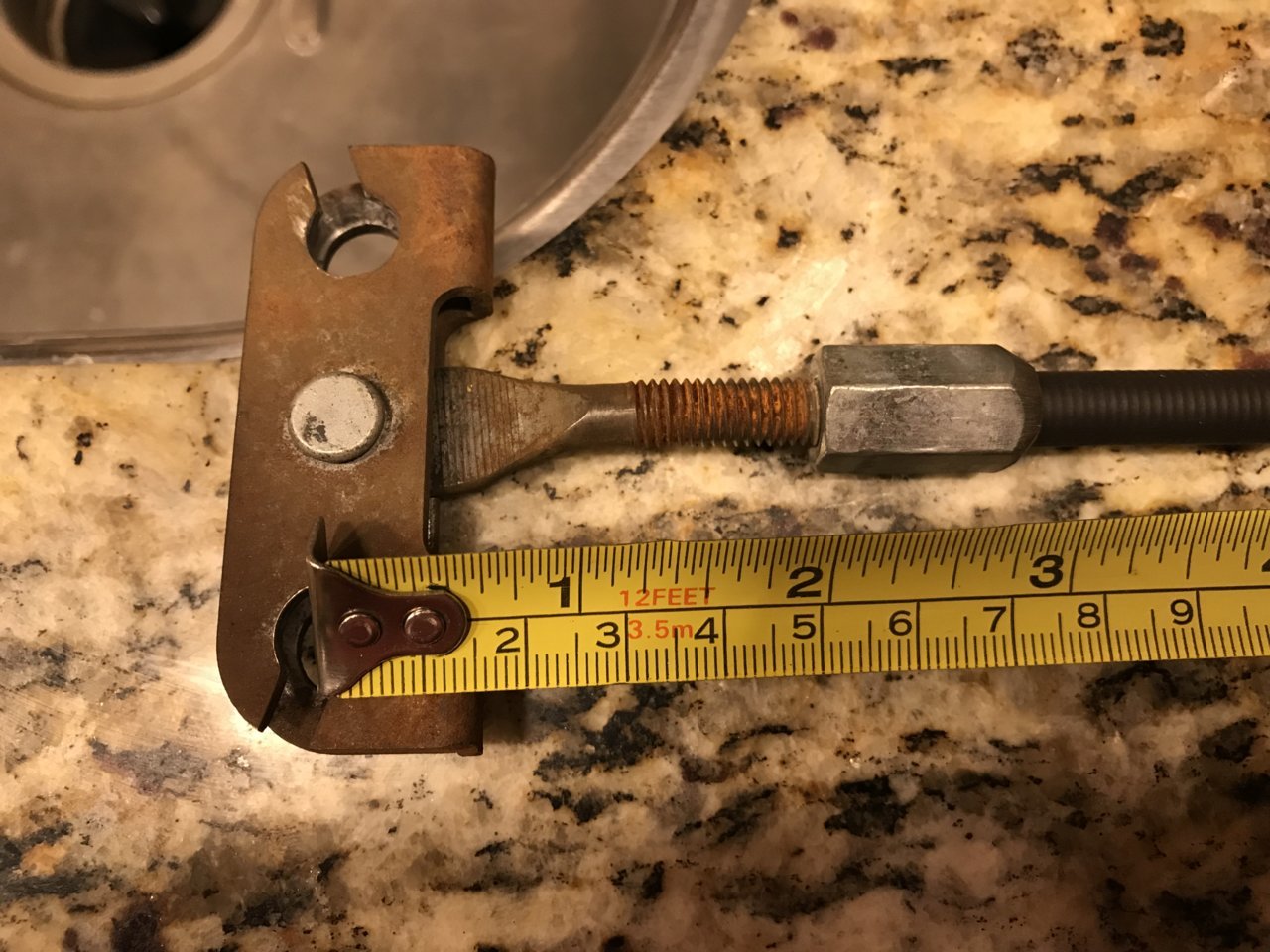

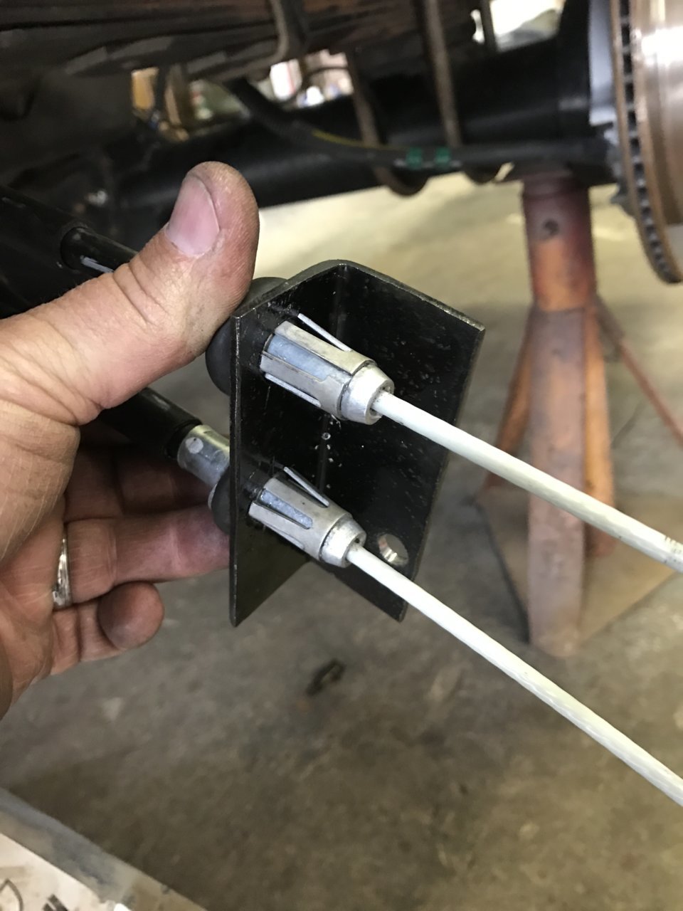

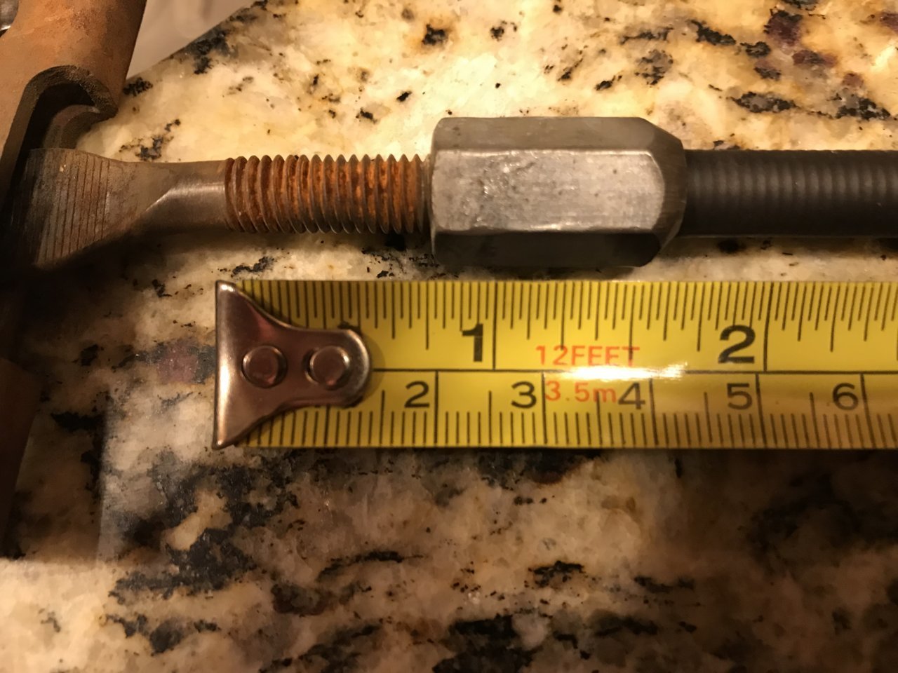

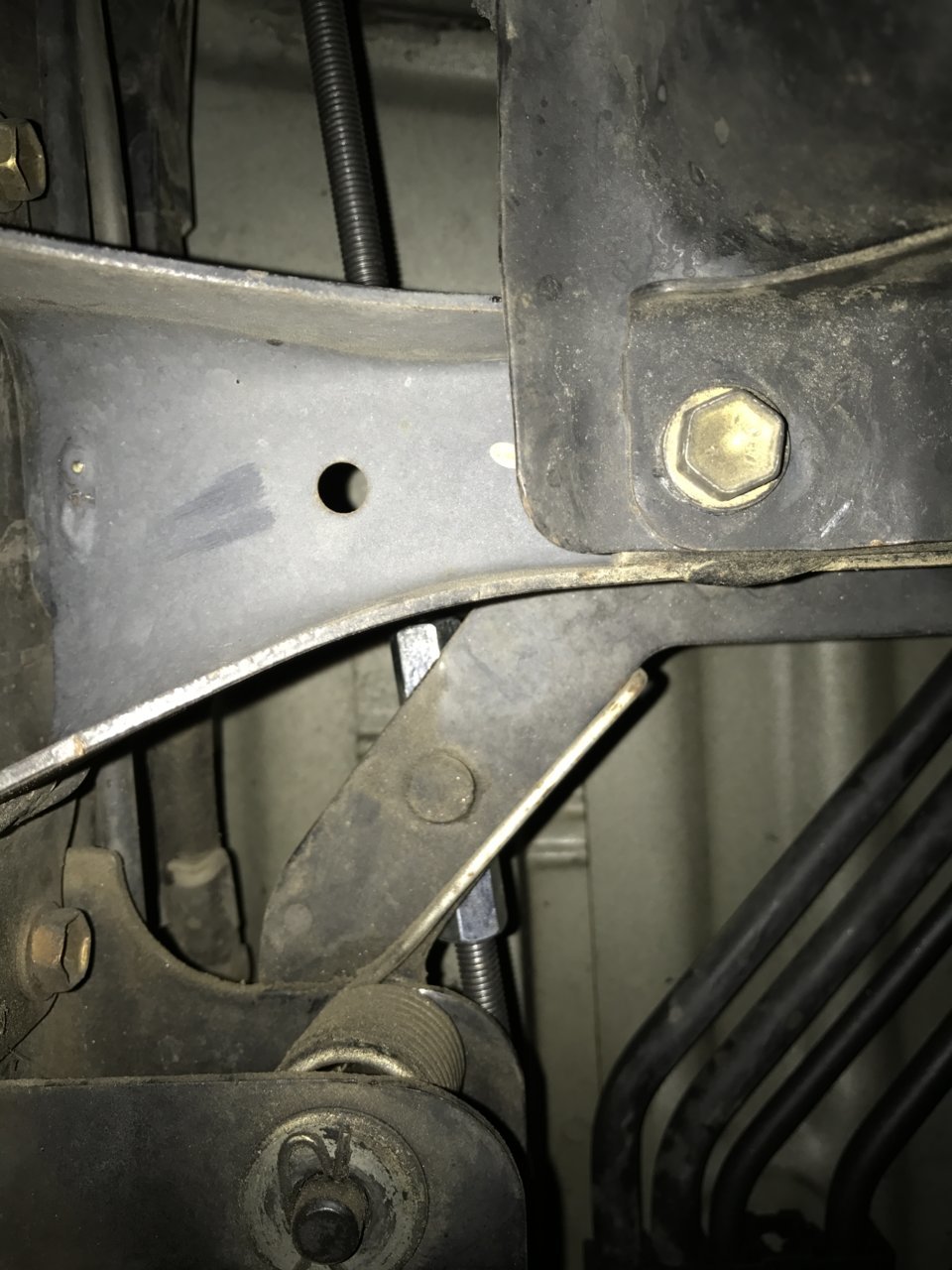

    Here are the e-brake cables that fit my Diamond D-rotor assembly:
    1. RT - Cable Assy, Parking: 46420-35773
    2. LT - Cable Assy, Parking: 46430-35563
    These cables are pulled together with this required bracket: 46302-60010.

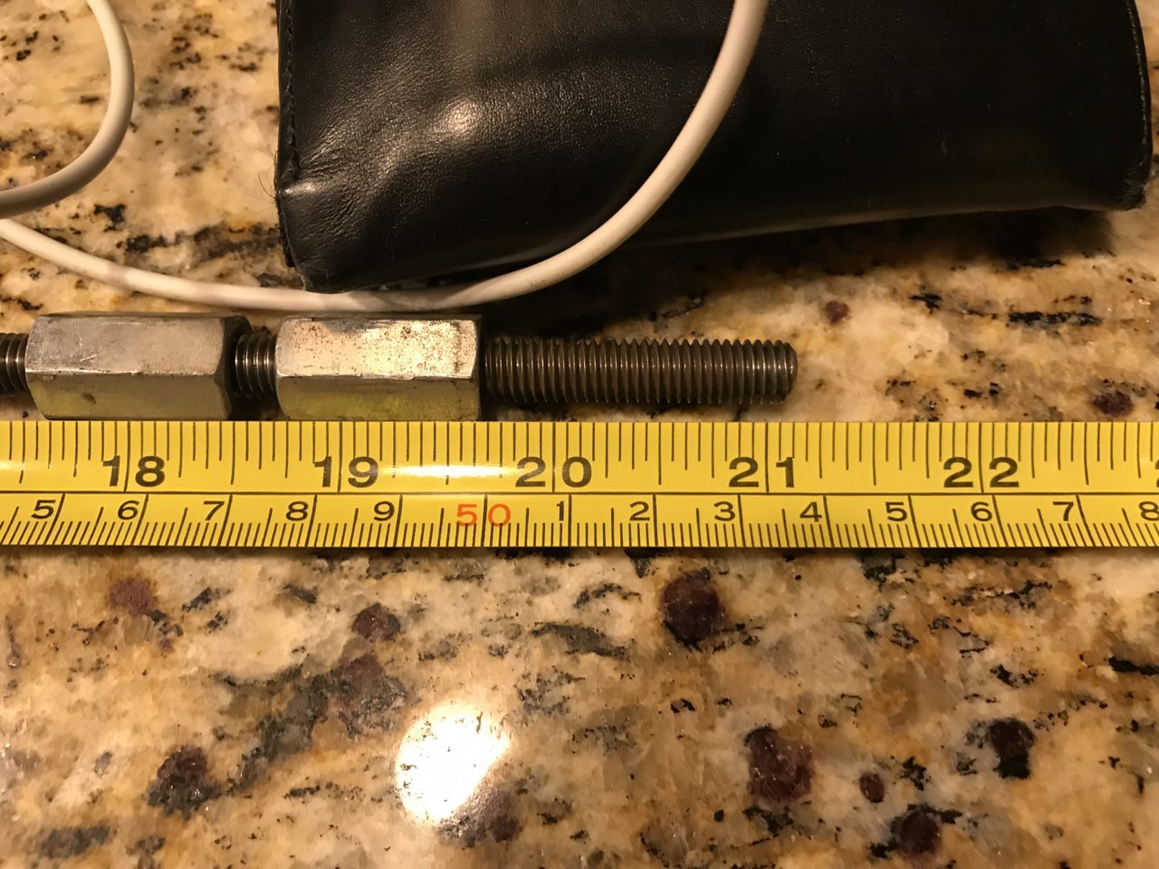

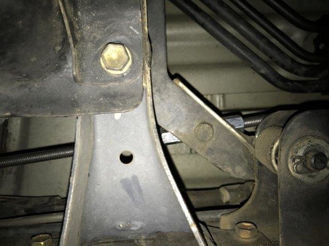

    I used a length of all-thread to run up to the e-brake swivel.
    I made a bracket for the cable housing ends to 'plug' in to. The LT cable needs to be shortened to match the length of the RT cable where it ends after you route it in the OEM cable location.

    I did locate a cable clamp unit that connected the shortened cable section.
    I will say that the parking brakes works but it will not hold tight on an incline.
    Might need some fiddling with to dial it in... I just wanted to get it together and wheel.
    I have other pics if needed.
    Hope this helps.

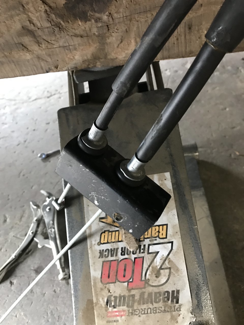

    Do you mind posting a few more pics of how you built this? Also, how much extra did you have on the shorter parking brake cable? I only ask because the length difference between a Std cab vs Ext cab is a good 18"+ wondering if it'd be better to use (2) Longer parking brake cables vs (1) Short & (1) long.

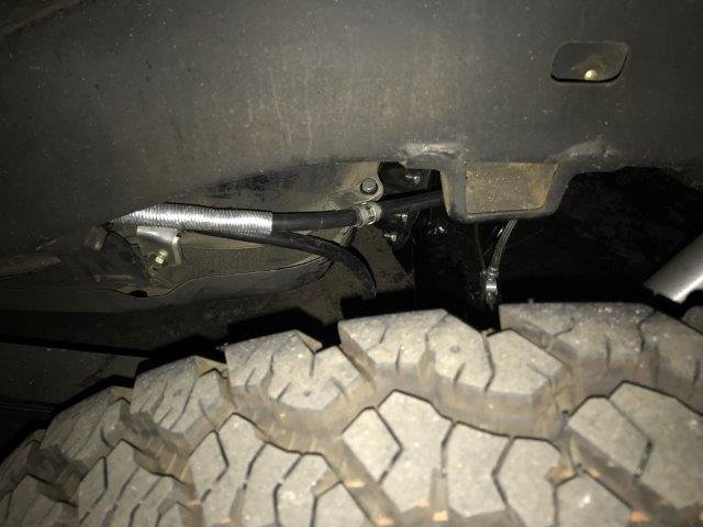

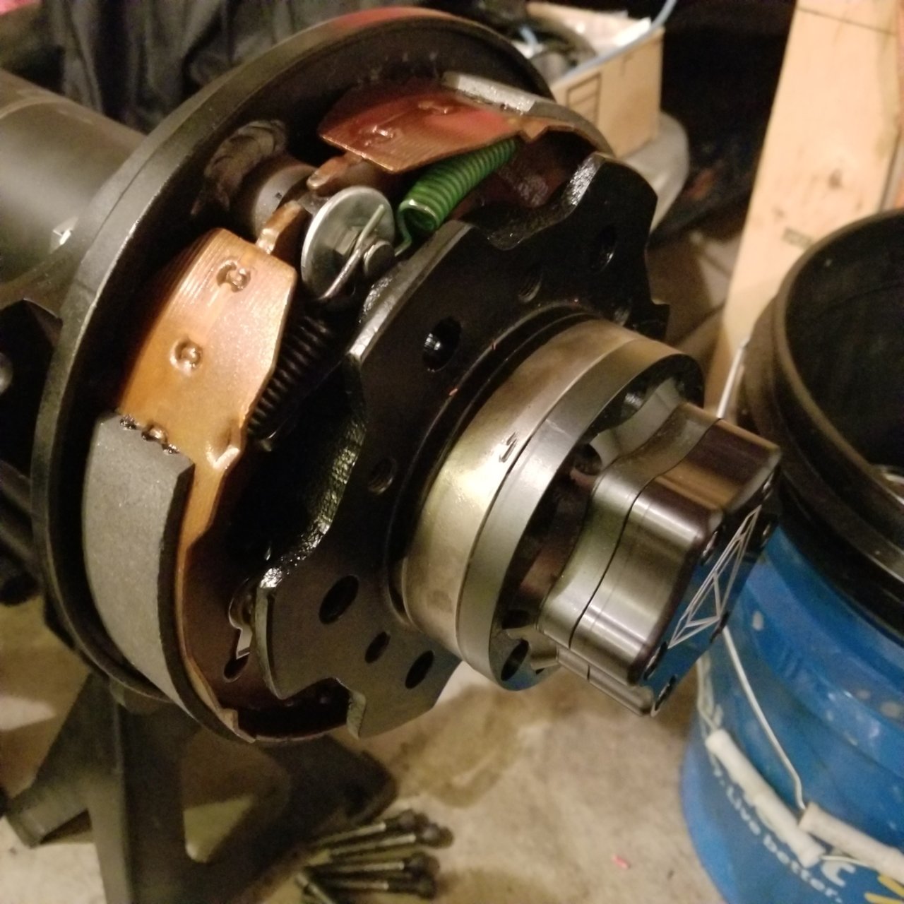

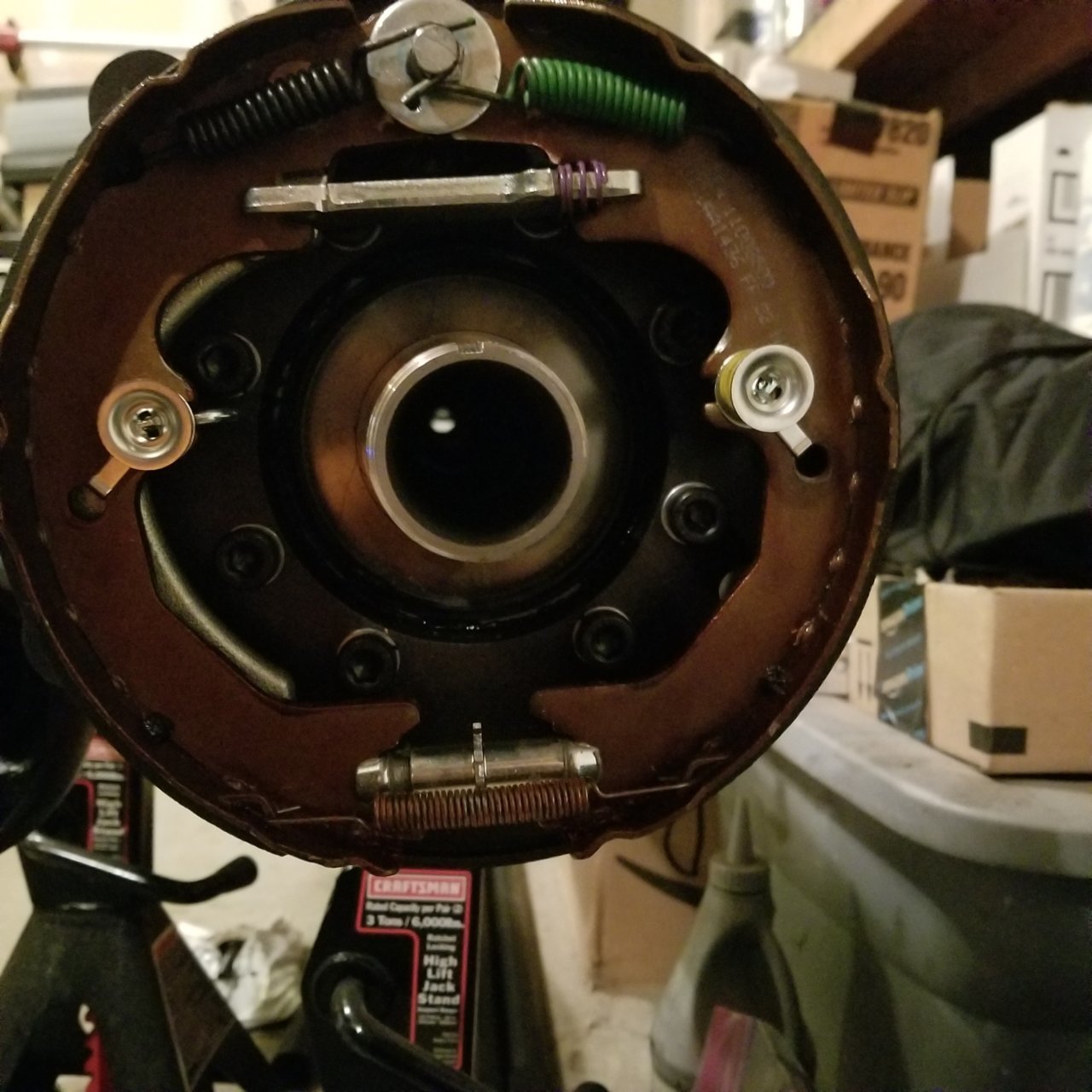

    They were both the same length to start with. The DS was shortened 14".
    What I did was figure full droop, plumb the PS cable to said location... measure & cut the DS to match. RC, Ex cab or 4 door does not play into this. Also, the amount up/ down travel indicates the amount of the DS cable cut length. What will change is the length of the all-thread to get to the e-brake swivel.

    Got it, makes sense now with the length now that I see what you did with the all thread. Thanks @Ritchie

    As a side note:
    I was told to adjust the parking brake at the backing plate, not at the swivel point where I used to adjust my OEM set-up. Not sure why but, I can say adjusting as suggested eliminates a slight squeak I used to have.
    If more detailed pics are needed, let me know of specifics.

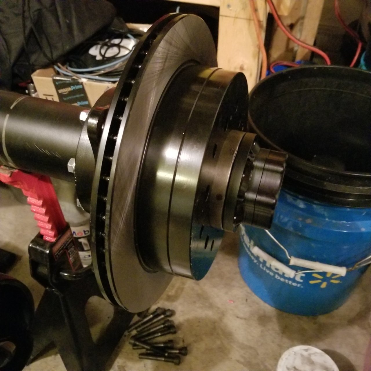

    DROTOR disc drum are adjustable? I am considering this setup, got any picture? Is it like the FF fj80?

    Yes, P.brake drum inside the rotor mimics a standard drum brake minus the wheel cylinder. You first make the adjustments at the star wheel with slight drag and then adjust cable(s) as needed.

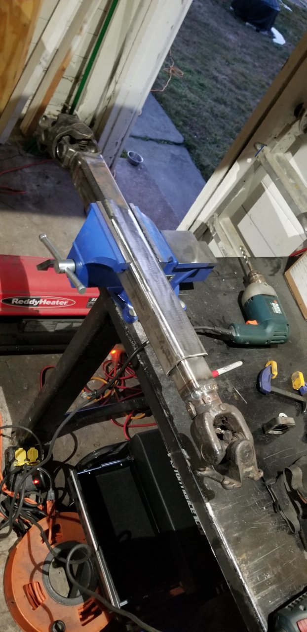

    Been working on turning my old barn garage, into a much better work space.
    Picked up a welding table, vise, got some C25 and finally knocked out a quick project building a spare square tube driveshaft. Bonus points as itll work with the front or rear. :cool:
    Down side....looks like I found a rust hole underneath the bed in the wheel well. Seems to be a common spot....off to the junkyard to skin a good bed.
