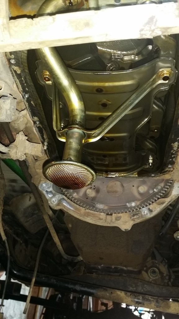

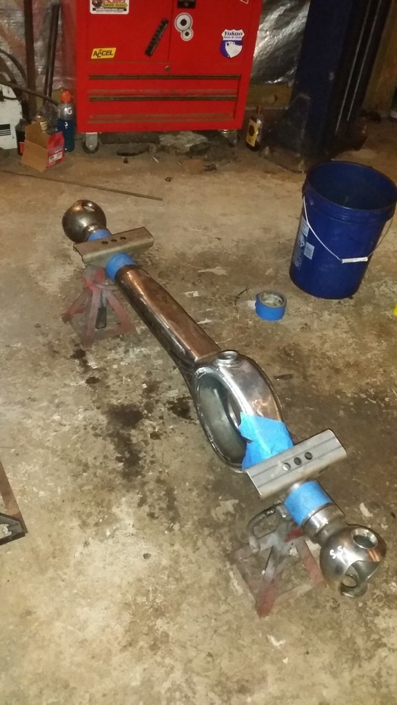

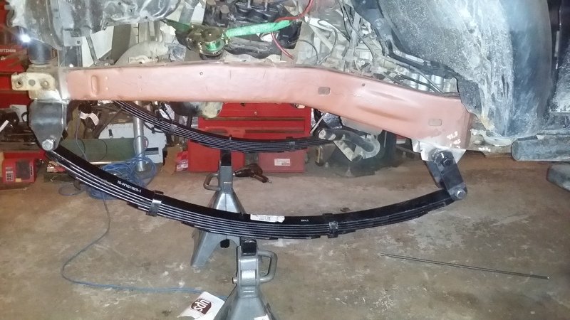

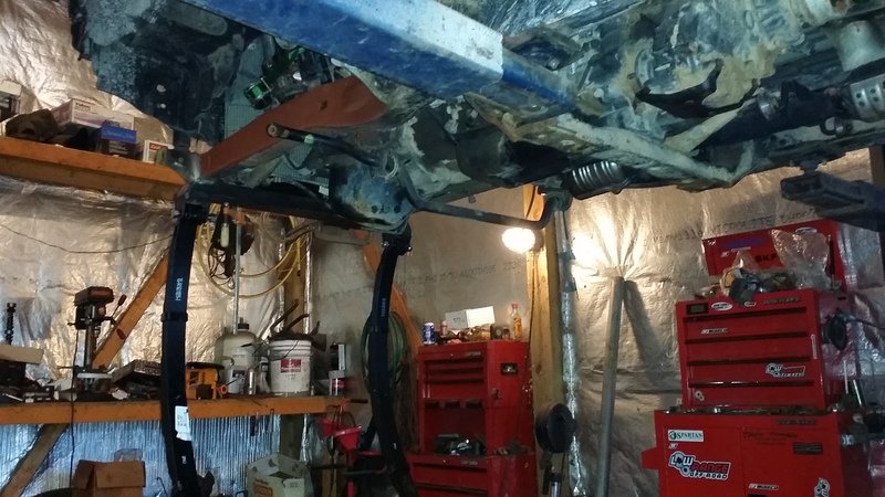

    Knuckle balls cut and removed. Ready to be set.
    A little tall at the moment 28" frame height on 37s, but not far off.

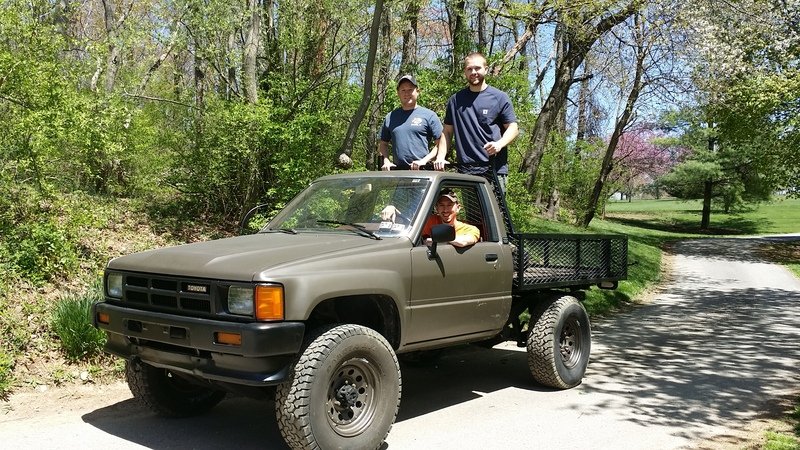

    Updates coming, got a bit de-railed last weekend....
    Friend of mine (sold lime green samurai) found this little gem and decided it will be the next SAS project.
    $2500 1986 22r-te = factory turbo.
    Oh yeah.....also had to get longer shackles as my measurements were off 1/2" so shackles were so close to hitting the frame. Fixed now.

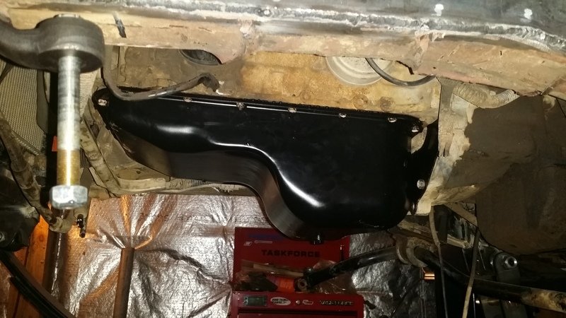

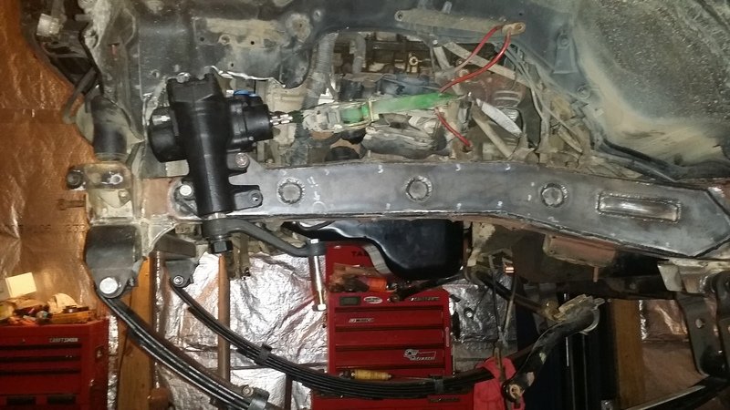

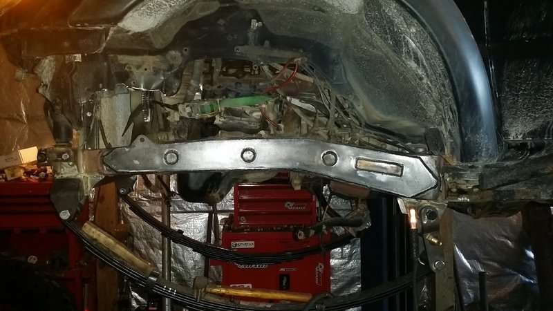

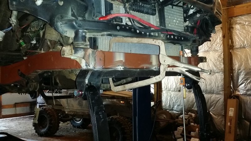

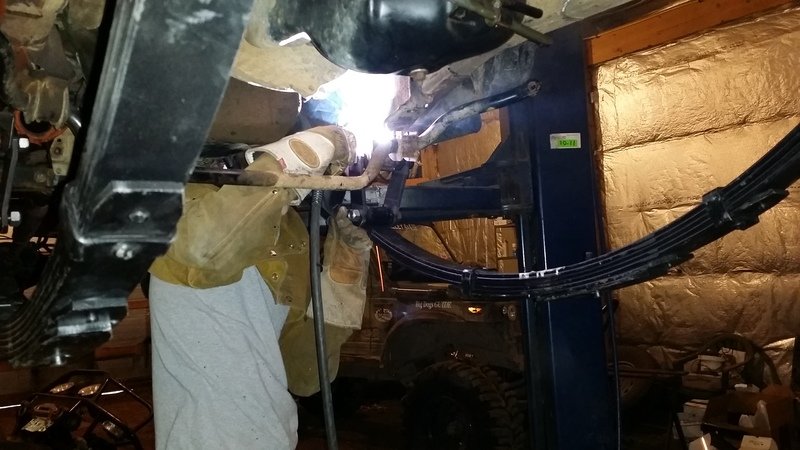

    Small update, worked on steering box position and welded in the frame plates.

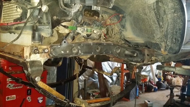

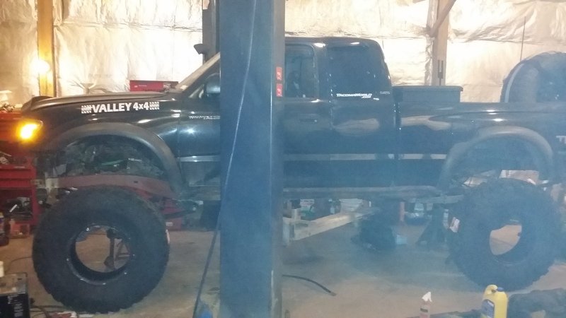

    Little bit further.
    31.5" on center perches
