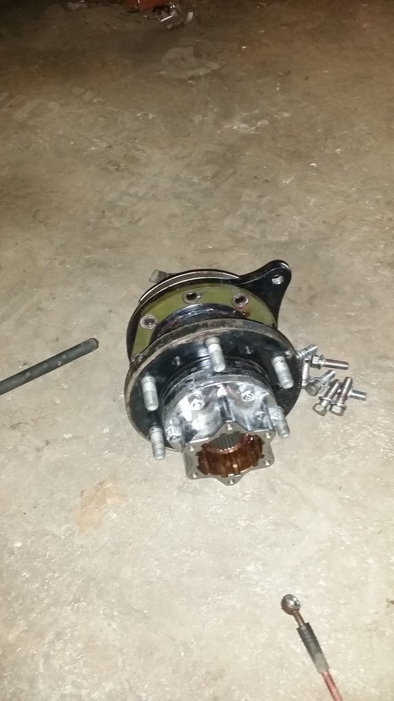

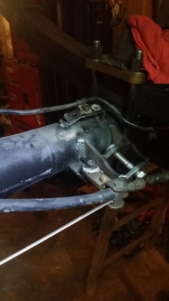

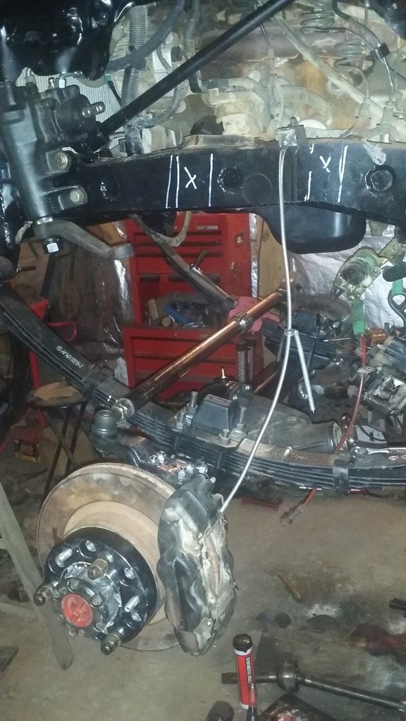

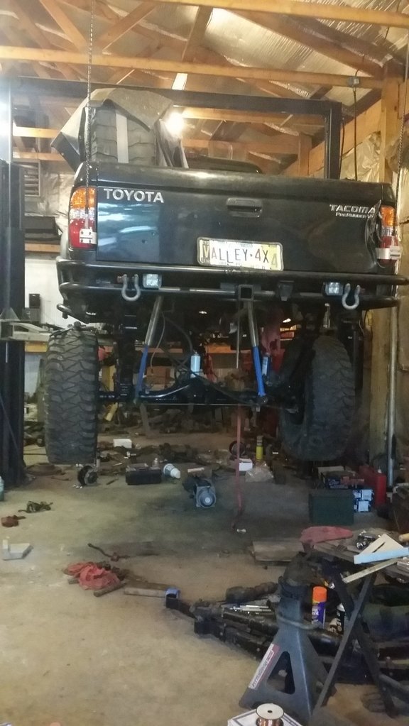

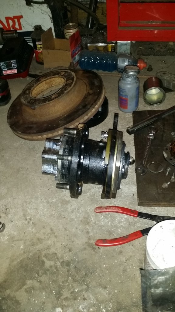

    Building the tie rod with weld in ends.
    Three generations of Toyota parts on 1 axle
    1983 Toyota Pickup solid axle
    1987 Toyota Pickup ifs hubs
    2006 Toyota Tundra 231mm brakes
    14" front shocks
    14" rear shocks :woot:
    The Toyota "unit bearing" assembly

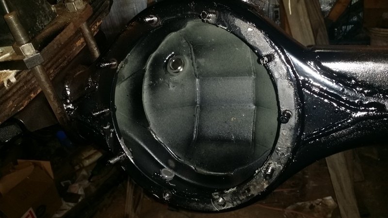

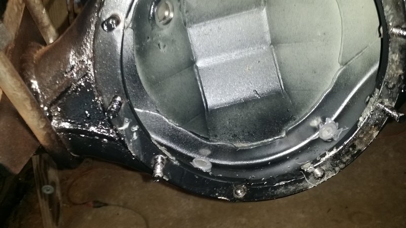

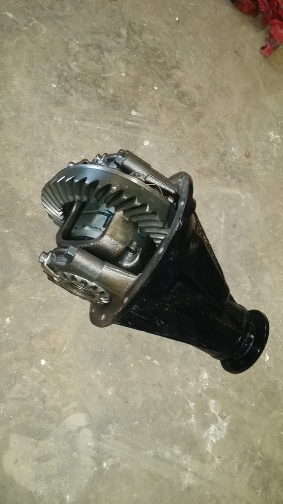

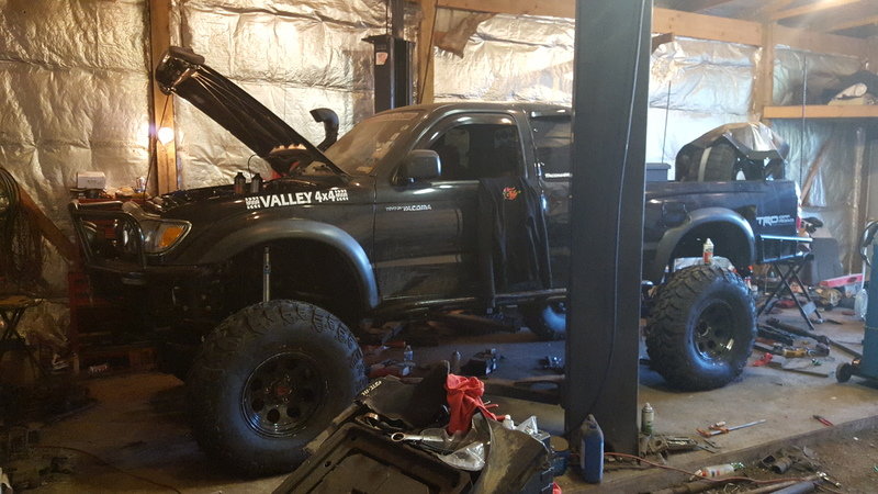

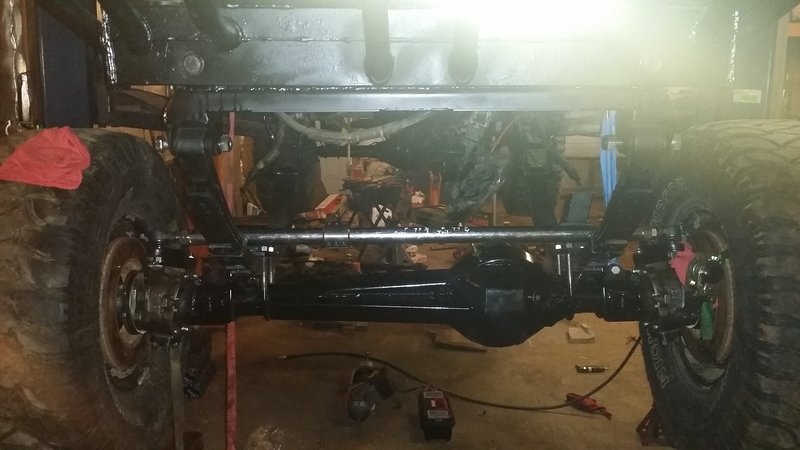

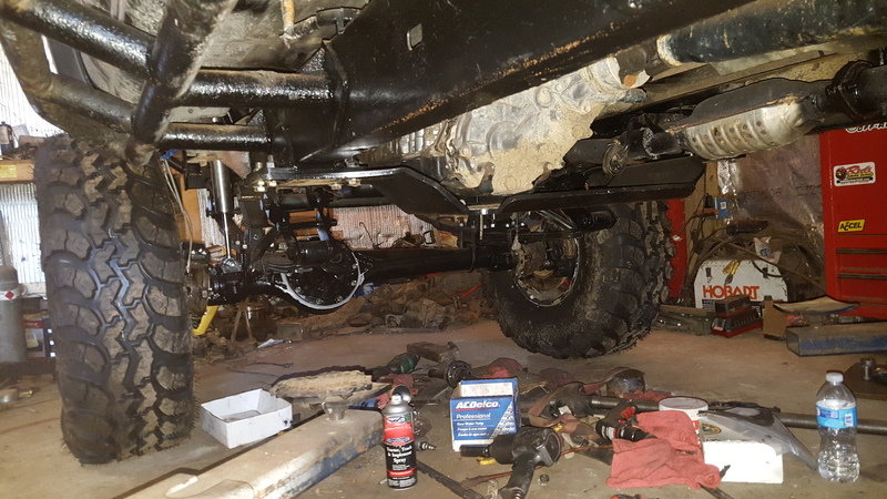

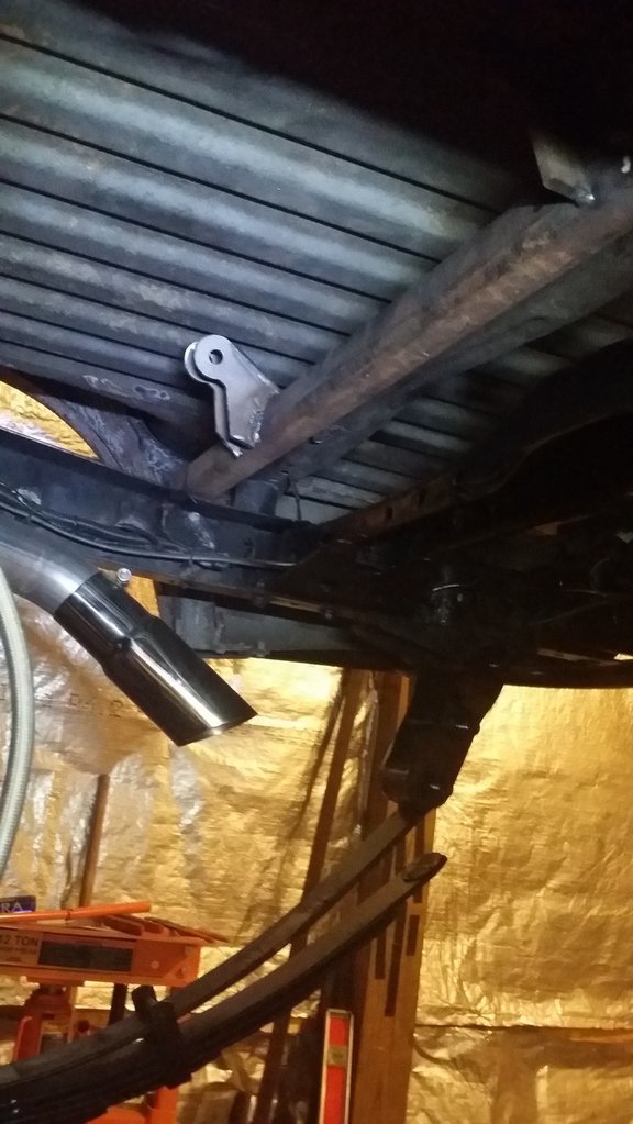

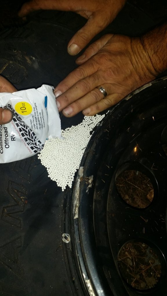

    Flipped diff doesn't have a magnetic drain plug, so added 3.
    Diff ready to go in.

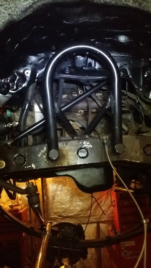

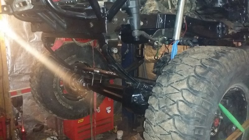

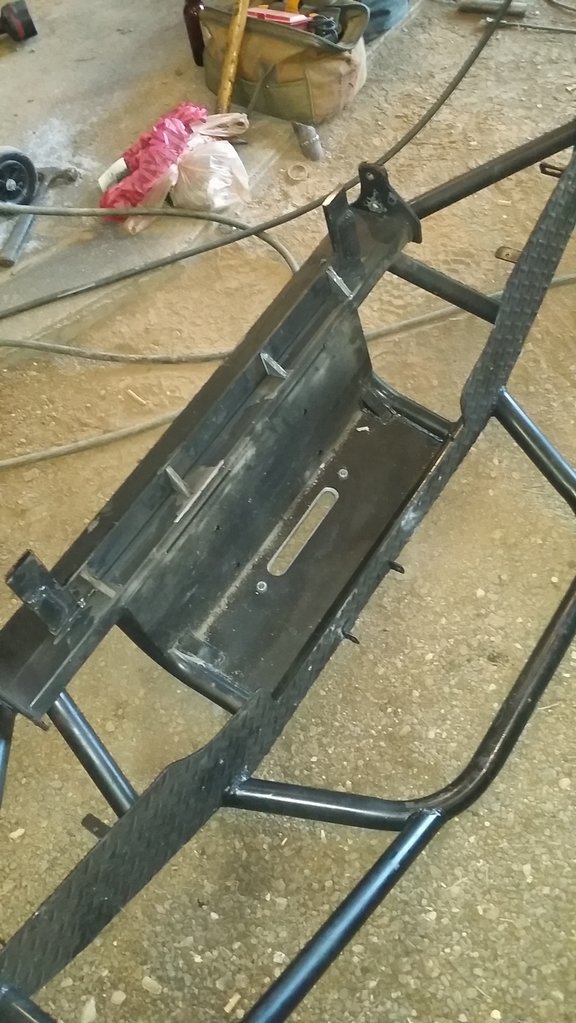

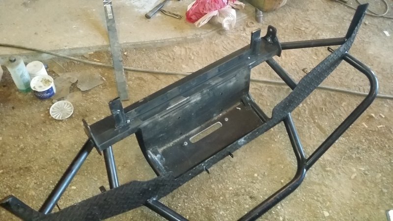

    With the Front leaf spring crossmember, the original lower bumper mounts had to be cut off and a new design made up.
    Lower shock/skid mount
    Upper rear shock mounts
    Front shock hoops

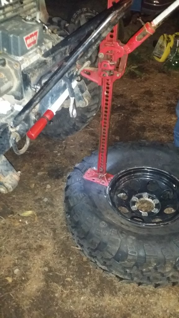

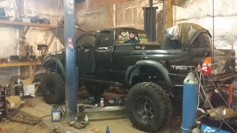

    Dyna beads install for the 37" Iroks

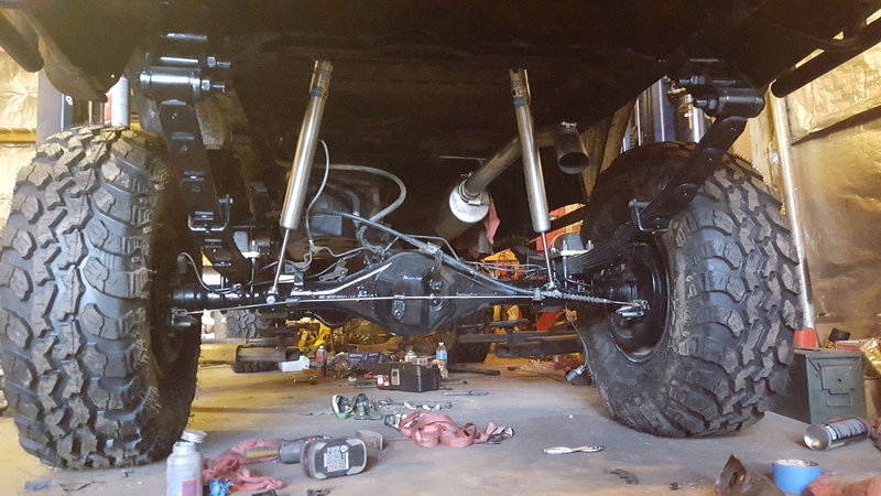

    And finally how she sits 26 1/2" frame height

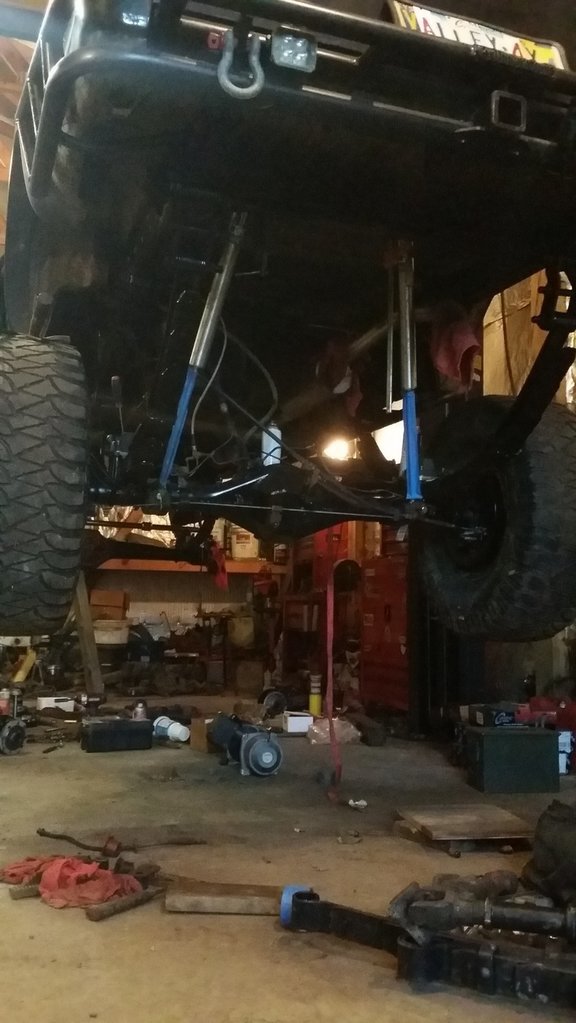

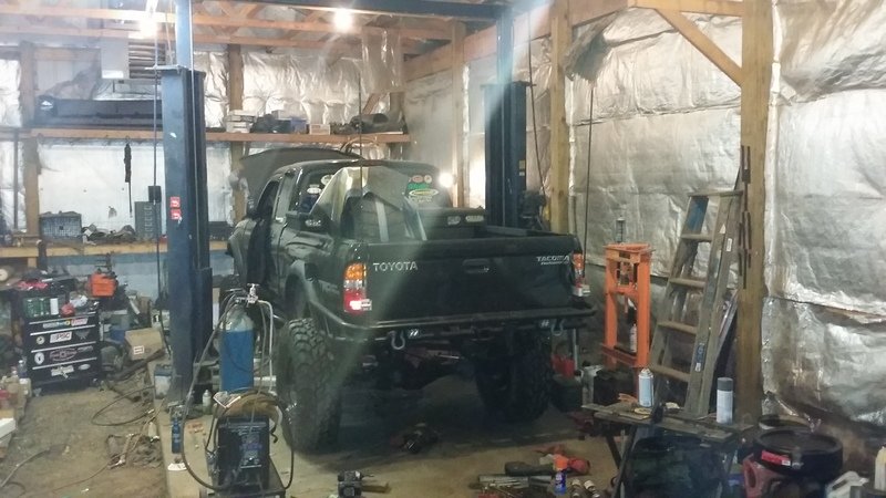

    Thanks guys, just wait to see this in person....pics really do not do any justice.
    But here are a few more...

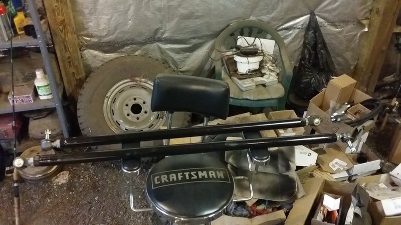

    Tie rod and drag link finished.

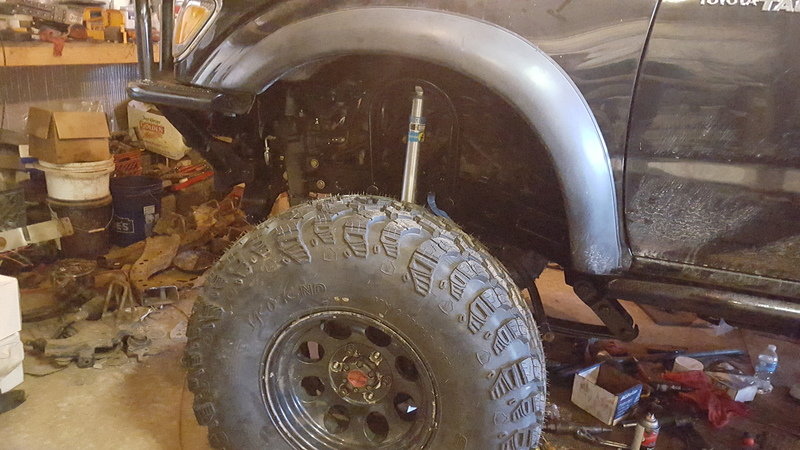

    14" Bilsteins fit great underneath

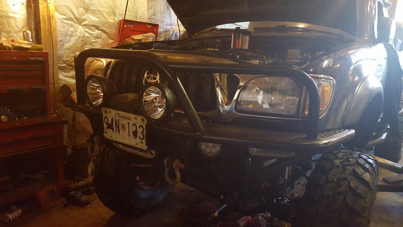

    New lights, new emblem, and temporary license plate :spy:
