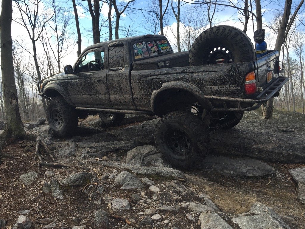

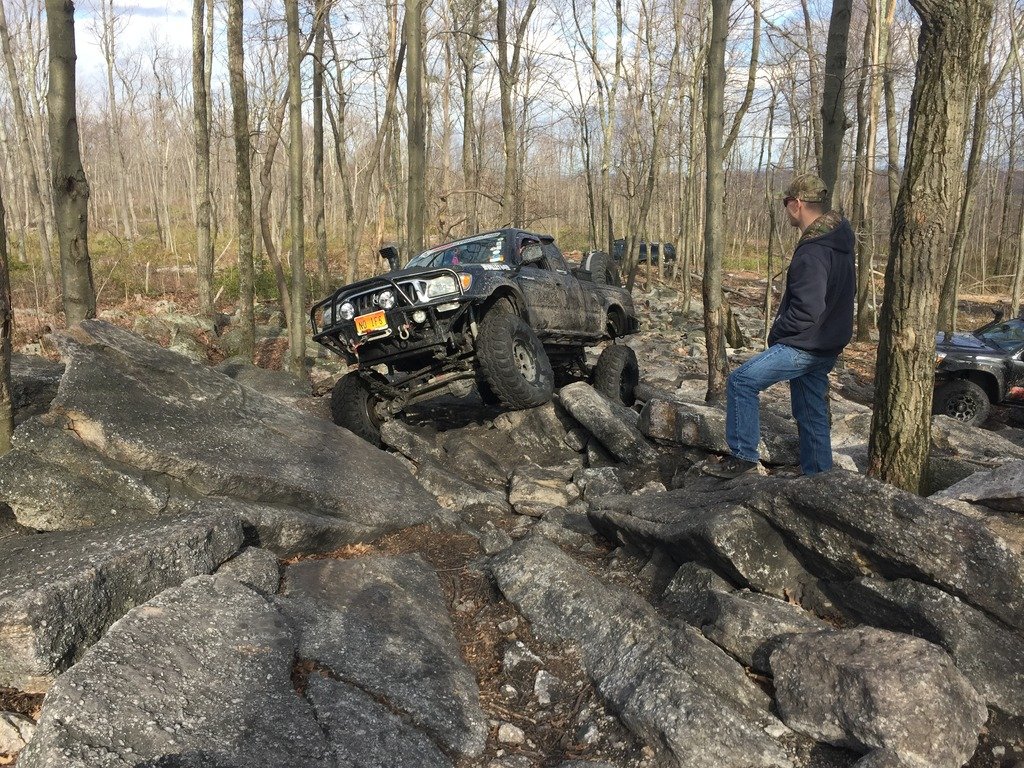

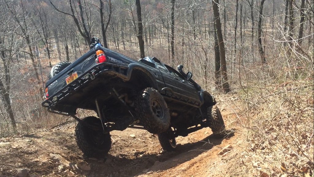

    More vid's to come but here's what I got so far. Thanks for coming up Thursday night, the bar was a blast haha
