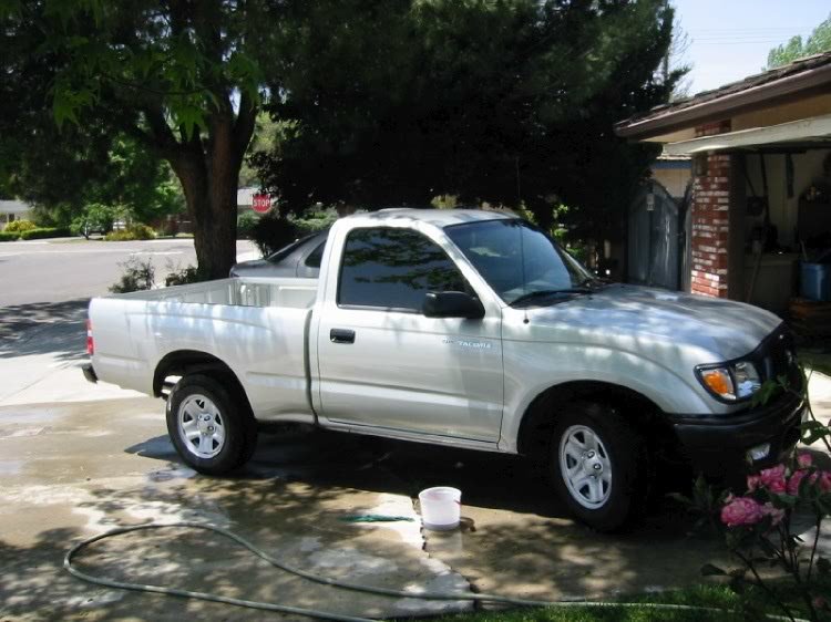

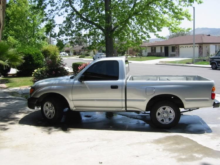

    this is what I started with

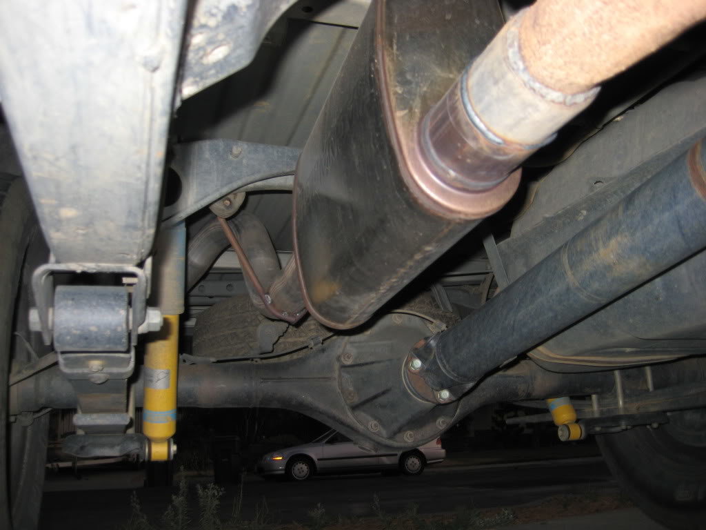

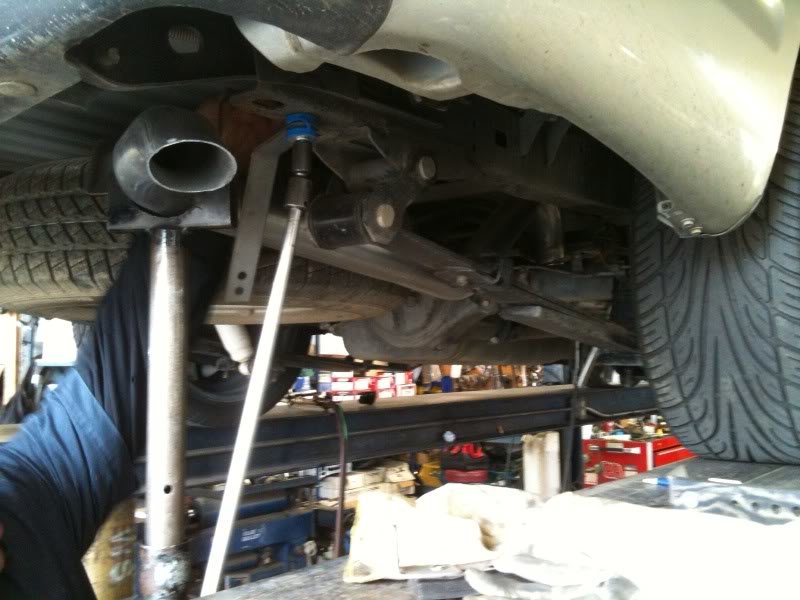

    First came the exhaust: Pics are not of the first exhaust I have, first is of the muffler I'm running. It's a magnaflow, the 2nd pic is of my current exhaust being welded up to clear the notch

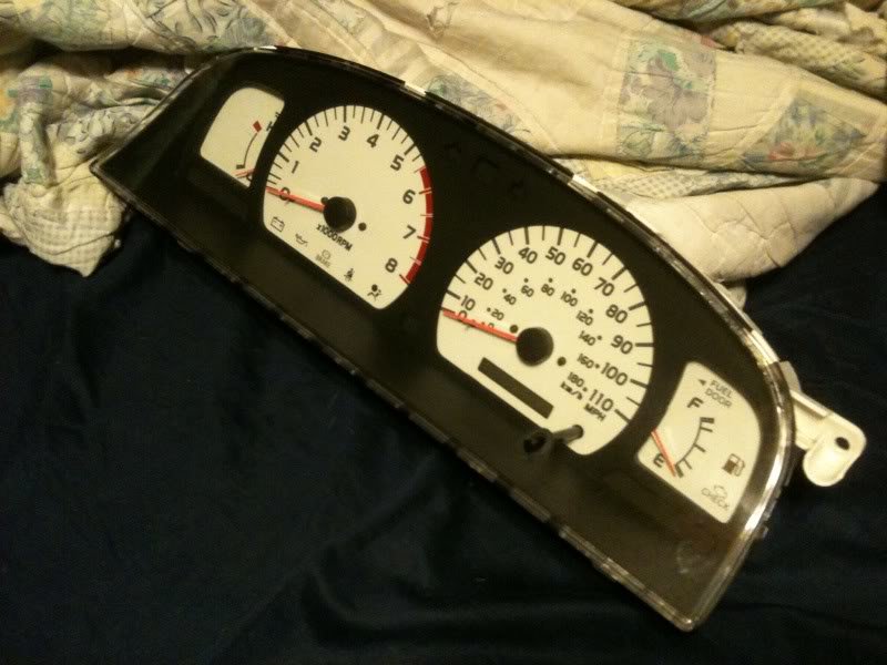

    Then came the OEM Tach Cluster
    then came rims/tires: front: 235/40/18 Rear 265/35/18 (going to 245s probably)
    You'll note at this point it looks HIGH off the ground.. well I agreed
    so:

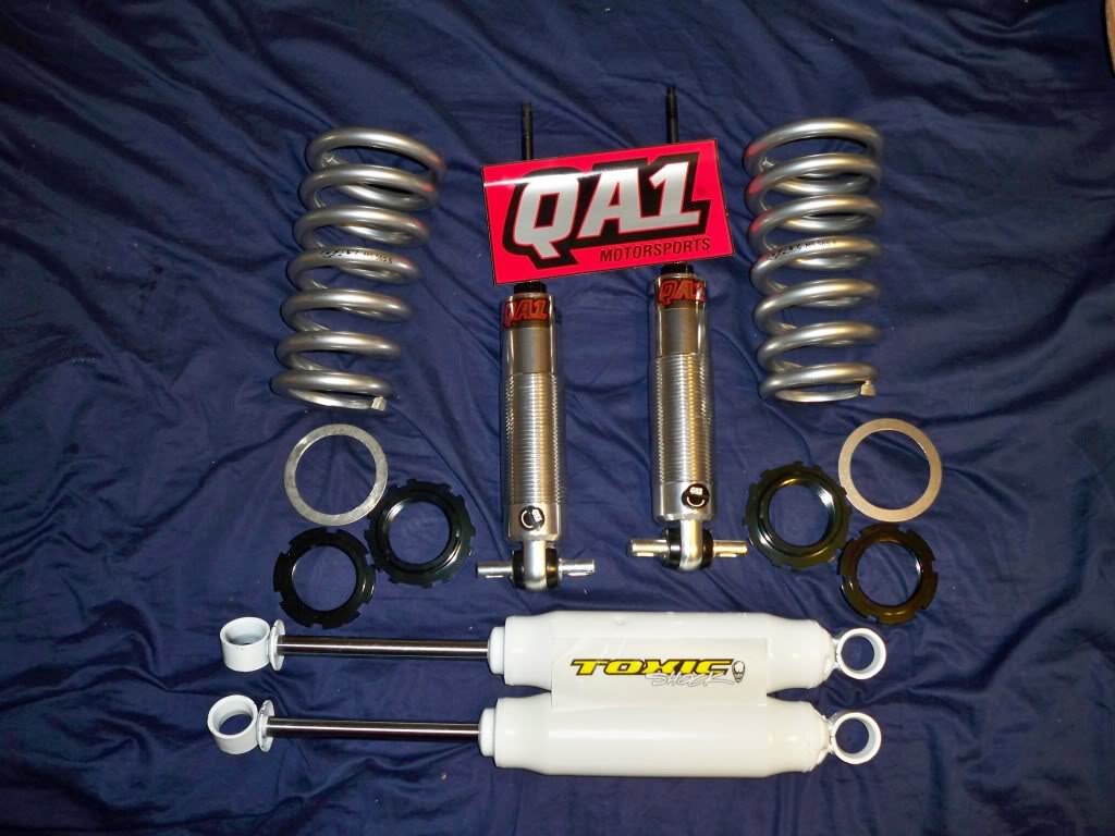

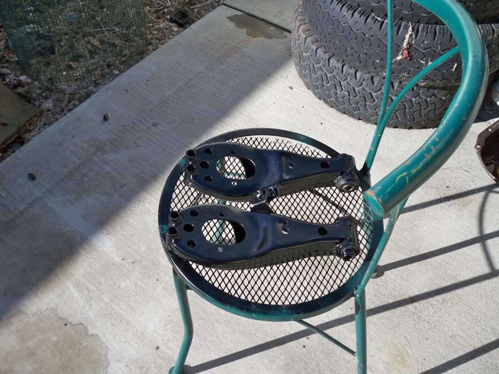

    Cut LCAs for QA1 plates

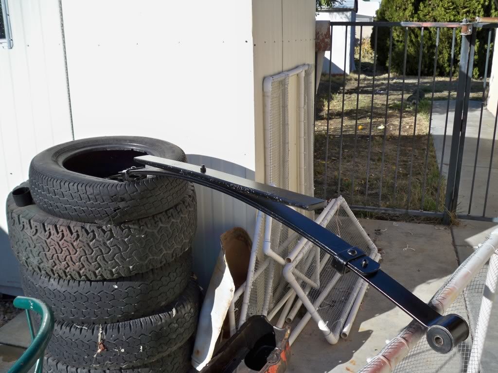

    Prerunner Leafs (3 inch drop with middle leaf removed)
    Not Pictured are the 3 inch Beefed blocks and ubolts

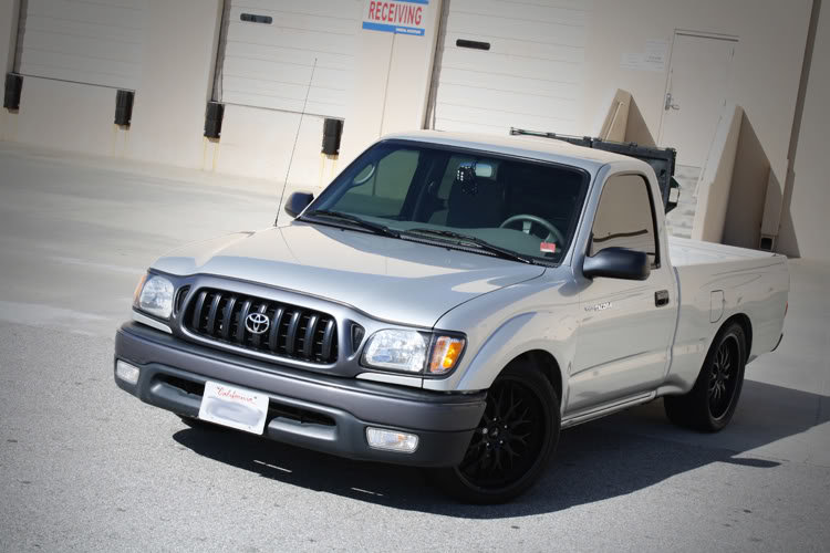

    this is what I ended up with:
    I should probably mention that the QA1s are GMP1s and I'm running 8 inch 565lb springs and that The toxic shocks on the back are PN# 418509

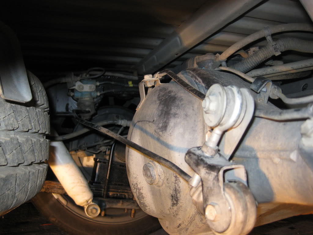

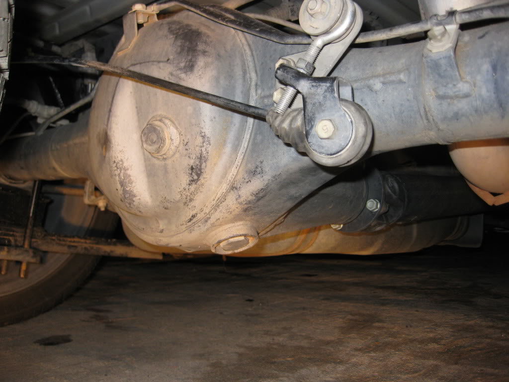

    This is how I put the proportioning valve end.. so far it hasn't broken off haha
    thats all I got for now ;p

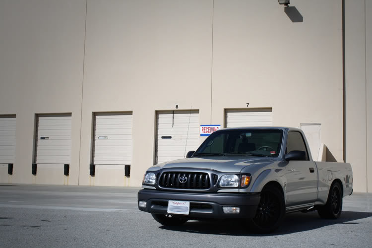

    now in correct location!

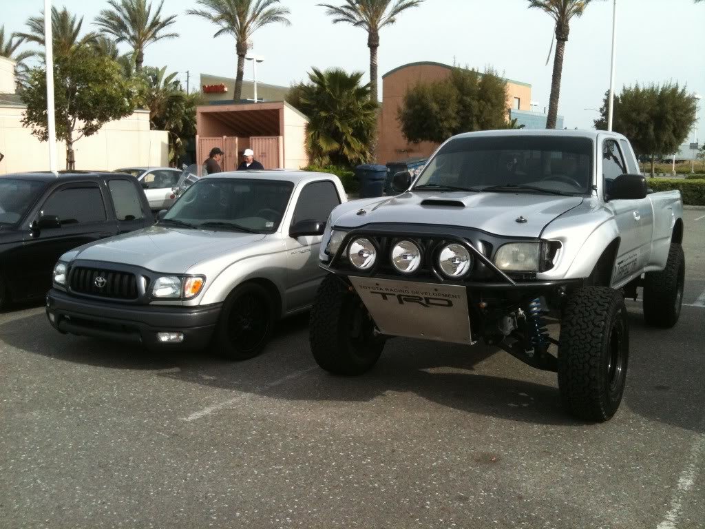

    dont like lowered trucks? ;p thats cool
    I have a Jeep CJ5, you know a 4x4 with a real front axle :D

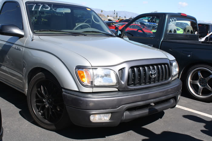

    this has been on for a while now, as of 2-28 lol but
    prerunner lower valance ftw (thanks to ryanjboutin for pickin it up from certifit)

    What was your original gauge cluster? Just three displays? The temp, speed, and gas?
