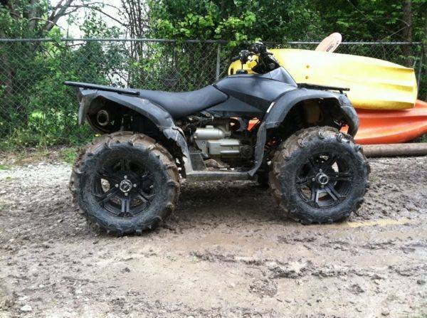

  16. Mar 30, 2012 at 11:29 AM
    #16
    woody6047
    woody6047 [OP] McGrubber
    Nov 20, 2009
    #26254
    4,687
    Beau
    Austin/ Waco Texas
    05 tacoma 4x4 dc
    100%stock, except for the exhaust leak and custom windshield crack mod
    All put together and ready to go for the time being
  17. Mar 30, 2012 at 11:34 AM
    #17
    Pugga
    Jun 18, 2010
    #39131
    38,679
    Massachusetts
    '19 Ford F-250 6.7 SCrew
    F-250 Land Yacht Mod
    I used to have a set of tires like that on a quad. I turned them backwards and they hooked up a LOT better in the mud and snow.
  18. Mar 30, 2012 at 11:35 AM
    #18
    woody6047
    Nov 20, 2009
    #26254
    4,687
    Beau
    Austin/ Waco Texas
    05 tacoma 4x4 dc
    Ill probably do that when they get worn down.

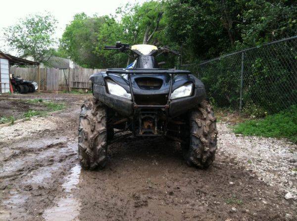

  19. Apr 10, 2012 at 12:34 PM
    #19
    woody6047
    Nov 20, 2009
    #26254
    4,687
    Beau
    Austin/ Waco Texas
    05 tacoma 4x4 dc
    Took it to Alto OHV park and she did work! I lost four wheel drive when i broke a front axle (it was shit anyways) the second day. Ran through the carb and put an inline filter from the gas tank because i was getting sand from there and she runs like a scalded ape. even in 2wd she has plenty of torque to push those 28's. The oil temp light keeps coming and an i have a slow water leak from a weep hole by the water pump so im gonna have to run through that and see what the deal is. Lastly the last night it started running like shit and dying so i stopped for a second and realized that the carb was constantly dumping fuel. So my guess is the float was sticking, another small fix to make
