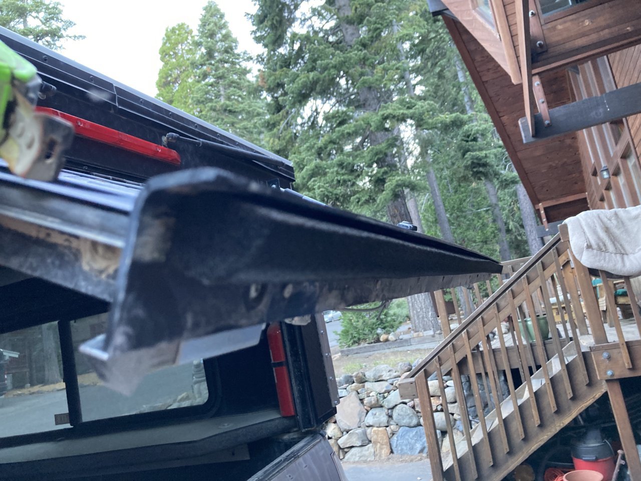

    I saw a partial pic of your hatch door. looks like a curved plastic lip overlapping your tailgate. first thought is that plastic lip needs to extend laterally beyond your hatch, to cover the gap where tailgate closes. Then that plastic curved lip needs to have closed cell foam glued into it, and carved down with a sure-form rasp to closely fit against your tailgate. i used to use contact cement to glue big chunks of blue closed cell foam to fiberglass and kevlar kayak cockpits. the foam was then shaped to fit. the glue and the foam was longlasting in saltwater. The thing about automotive door seal products adhesive, its not up to the task.

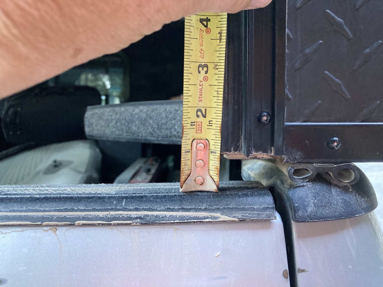

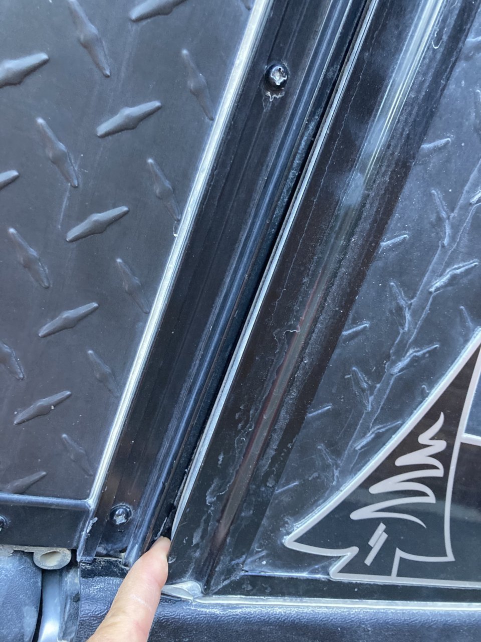

    This is my third camper shell on various pickups. The other two never had dust intrusions like this. Some dust is understandable. I get that.
    When the door is latched there's still lots of play in the door. It doesn't latch flush enough. I can still fit my pinkie in the door gap on left.
    For the door height, you can see from the pics how far off it is. Looks to me like the door was cut too short. (?) 1" on one side 3/4" on the other.
    In the last photo, you can see that I added the deep weatherstripping. This is a patch. I can't imagine how bad it would be inside without it! Actually I can...because first trip out everything was dusted out. t1kIyCqKQjyc81e86lZACg.jpg 381HtsNvRdKYMHiYfEIcSQ.jpg a7ZiRaV1SAypRApMUQCA0Q.jpg
