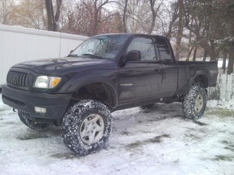

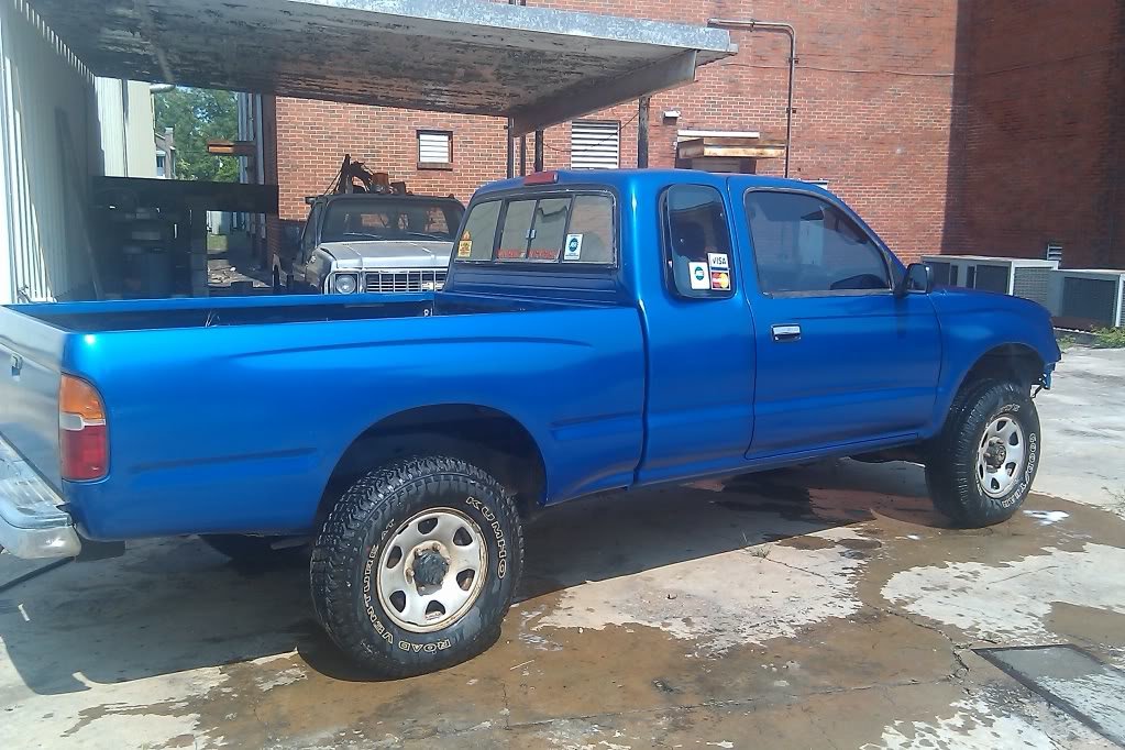

    Well i have finally done enough research to feel confident in painting my first vehicle.
    I have always liked the speedway blue on the newer Tacoma but couldn't imagine paying some one a few thousand dollars to paint mine.
    So i Ordered up Some Single Stage Urethane from Eastwood, as well as Epoxy Primer and a Glossy Clear coat.
    I will be using a HVLP gun from Eastwood.
    The Truck is Currently Black but has scratches, some dings, one repair spot that paint doesnt match very well and the Tailgate is in black primer. If it didnt have all these blemishes i wouldn't ever dare to try this.
    Im going to Take pictures of the process. Im painting the door jams but not the entire box as i have a box liner.
    The Color i picked is Eastwood Coastal Hiway Blue.
    I will attach pictures of the truck before and the Color.

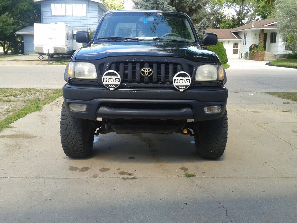

    Yup i never see ANY around here.
    Thanks for the tip. I will be doing it in my garage. So i will have to pick a good day.
    Hey you never know i might end up saying that. I hope i dont slap the truck with the compressor hose haha!

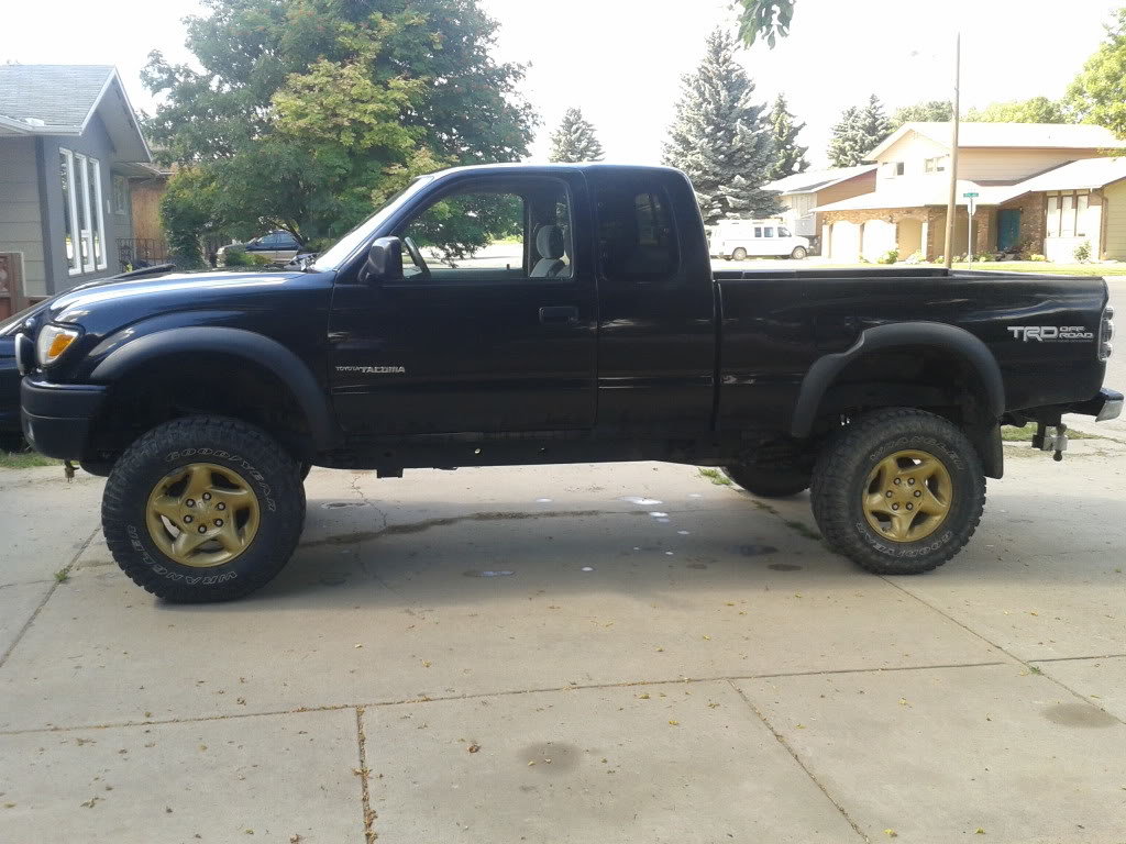

    Your Truck looks exactly like mine.. well mine has gold wheels now.

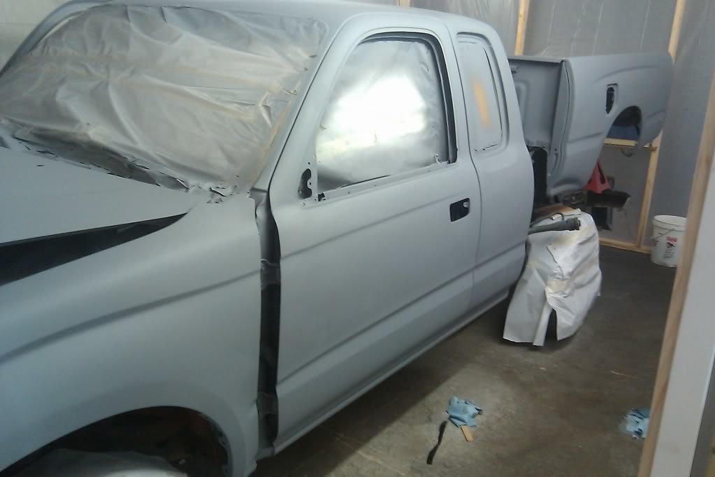

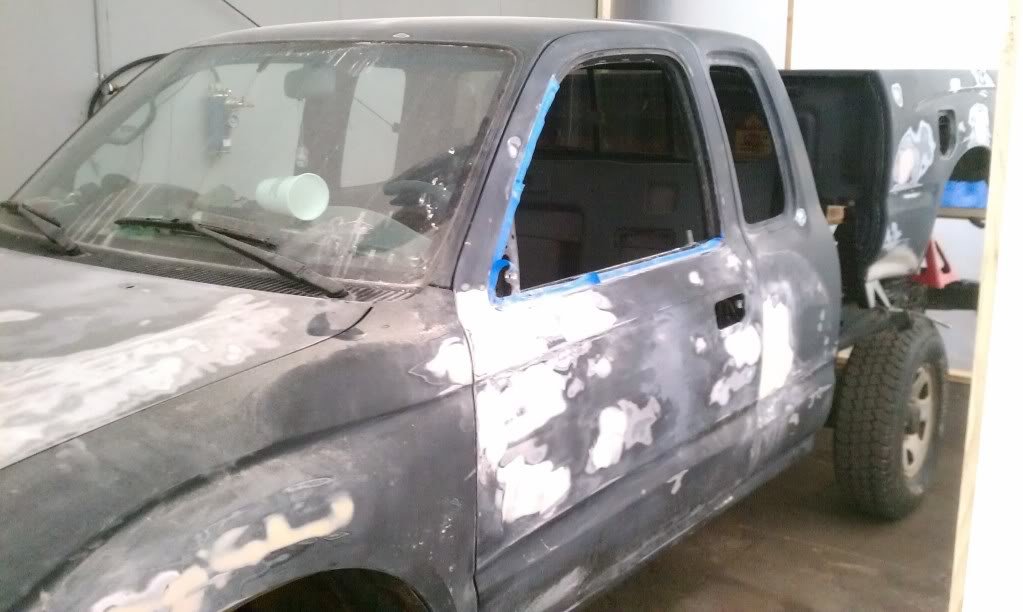

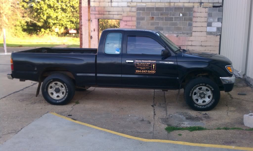

    I second this question. Single stage paint does NOT require using a clear coat on top. As a matter of fact a single stage paint typically will not work well with trying to add a clear coat on top. If you truly want a paint job that will look good and LAST, I would suggest doing a basecoat-clearcoat paint job. They are MUCH easier to accomplish, and if you make a mistake they are WAY easier to correct without major work. Below is a link to my truck, which I did just like you are talking (Scroll through the pages past the engine building sections and you will find a lot of useable information on doing your own paint job.
    One good thing was mentioned, and I will reemphasize this as well as add VERY important information.
    95% of a good, or even a DECENT paint job is preparation. A shiny new paint job will show EVERY defect in the substrate (i.e. any deep scratches, dings, dimples) and while it may not seem like much now, you will kick yourself later when you look at the finished job. Look over the entire vehicle and repair the little dings.
    Compressed air: Obviously you want NO moisture in the air lines. I used a $150 air dryer/filter and STILL added an additional line filter/dryer. Moisture will not show up in the paint at first, but a few hours after and the paint will literally look like CRAP. Also get a good quality spray gun. One that has two different sized tips (one for the primer/sealer, and the other for the basecoat and clearcoat.) I also recommend using a paint cup that is used exclusively for the clearcoat.
    I cannot emphasize enough about CLEANLINESS. You can wash your hands 10 times, but a single touch from your bare hands can RUIN a paint job. Wear gloves that do NOT have any powder in them. The powder can get caught in the paint and show up later. A gallon container of quality wax and grease remover will be your friend.
    DO NOT USE NEWSPAPER to mask. When it gets wet the ink will bleed and show up on the paint job when it is done. Use an automotive paint grade masking paper and good 3M tape for masking.
    You will learn to HATE one word: Sandpaper. Before you can expect a primer or paint to stick, you have to open up the old paint. Use no coarser than 400 grit sandpaper and sand EVERYWHERE that you plan to paint. Expect at least 2 good days of sanding to get it all smooth. When you are done the entire truck should look dull. If there is ANY shine, then you need to sand more.
    Your truck is black from the looks of it. A base of black underneath a bright blue will show through, causing the bright blue to be a flatter color. Grey primer/sealer will cover black and allow the new color to look like you want it to. So when you are ready to paint you will spray the entire truck with a primer/sealer and allow 10-15 minutes depending on the primer/sealer brand to "flash" and then start spraying the color. After 2-3 coats of color, allowing 5-10 minutes of flash time between coats, you will be ready to apply the clearcoat. (Assuming you are doing the aforementioned basecoat/clearcoat method) Allow the clear coat to "flash" dry between each coat. I applied I believe 6 coats of clear to give the paint "depth".
    Can you tell I have done this before? Hahaha. Feel free to aask anything you would like to know, if you are interested. The color I used on my truck is a custom made blue. The base color is 2010 Dodge Viper Blue Pearl. I added two different metal flakes to the original color. I used .004 inch Cobalt Blue flake, and added .008 inch Patriot Blue flake.
    If I am stepping on your toes here just tell me and I will delete all my pictures.
    Before paint and body work:
    Body repair and sanding completed:
    primer stage:
    3rd and final base coat:
    After clearcoat finished and masking removed.
    I did run into some errors, and made a few mistakes that I have worked on clearing up since. The good thing is that since I did a basecoat/clearcoat, I can fix all of them without having to repaint. I hope my information helps.

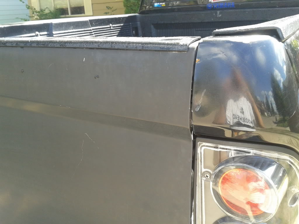

    Washed the truck up today kind of was thinking about how im going to do this.

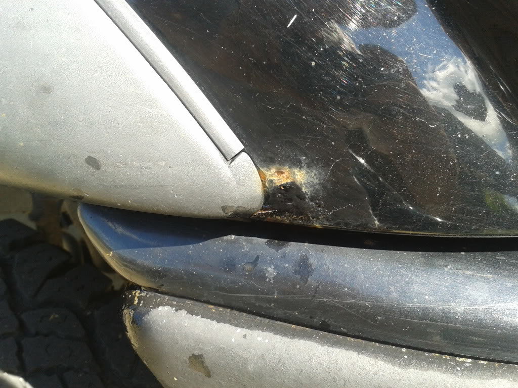

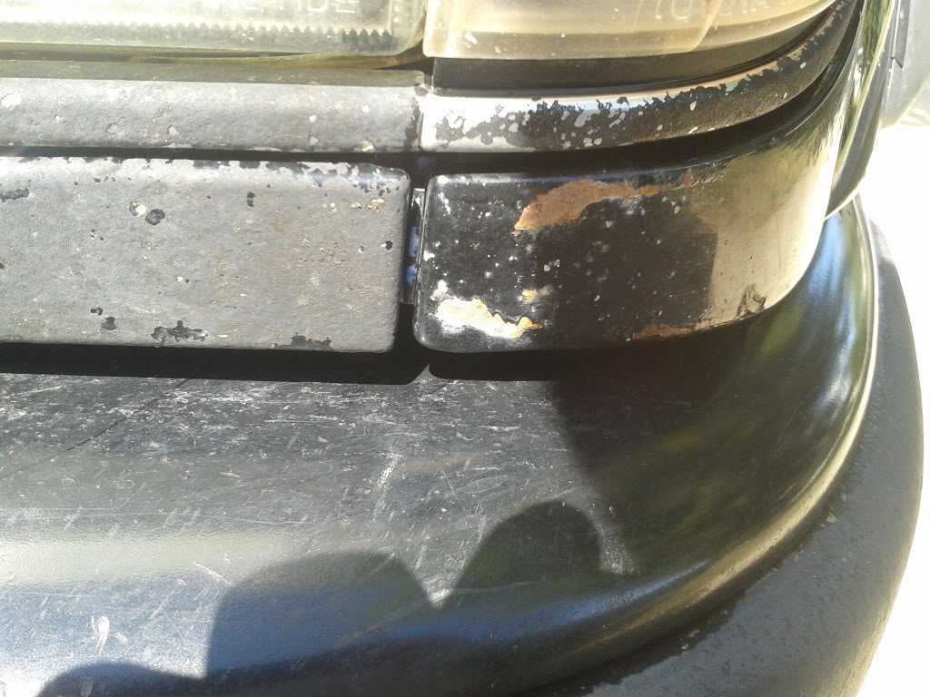

    Took a few pictures of the flaws:
    Here is the Primered tail gate, which has a dent in it, same with above the tail light
    One of Very few rust spots
    Some more chipping

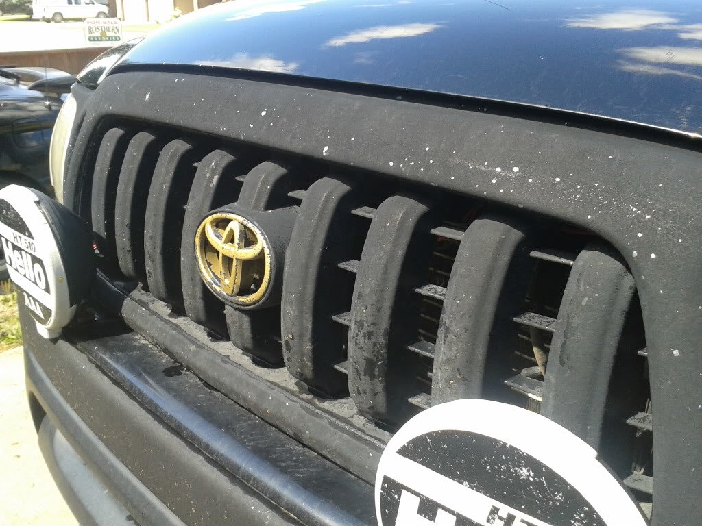

    The grill that needs to be stripped. The PO painted it with some black undercoat or something. Can i use regular paint stripper on it?
    Plan is to paint it the same color as the truck
    AND THE LAST BEFORE PICTURES OF THE TRUCK!

    ok, the rust spot needs to be taken care of. No if/ands/buts. That rust will come through the new paint job FAST. Sand it with 80 grit until ALL of the rust is gone, then use a primer/filler. If the rust penetrates the metal then sand it all down and use fiberglass repair to fix the problem. It looks like there is some rust on the front edge of the fender as well. Get that sanded down good. The grille, I will be honest with you, would probably be cheaper to buy a replacement. The time involved alone in trying to smooth that grill, or strip it, would far exceed the cost of a replacement.

    The grill will need to be stripped as there is none of these in the junk yard here and i cant wait for shipping. i was going to leave the area where people usually do the satoshi mod black. . i will be respraying both bumpers and the satoshi part of the grill in black bedliner

    Good luck with this adventure OP. I would agree with BamaToy1997 about replacing the grill - they are actually not very expensive.
