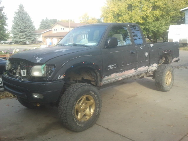

    making progress.... its more body work then i expected.

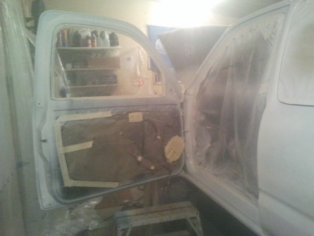

    well will update some pics later this afternoon. Almost done the bondoing!!Just about have the entire truck sanded... have to do the door jams then haul it outside and wash the hell outta it. Then im off to taping... But im going to have to give my garage a once over before any painting happens

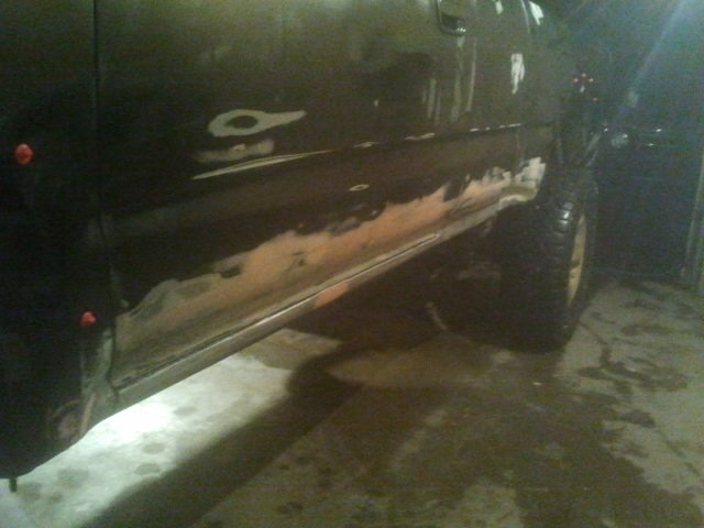

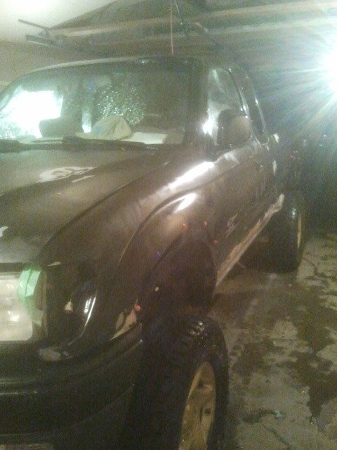

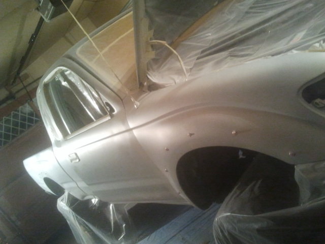

    Well cleaned the garage up... Got all the sanding done, Bondoing is finished, Washed it with dish soap outside in the dark with a spot light ...people driving by must of thought i was nuts..Ready to start taping everything off in the morning when its dry.
    Still looks shiny because its wet...

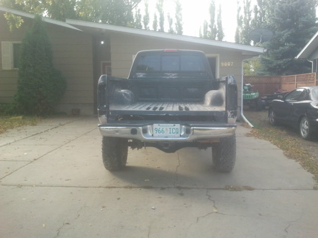

    Drivers side was must worse then the passenger side. Damn bedliner is hard to get off and make smooth again.
    Passenger side bedliner battle
    Dent from the winch fairlead on the quad and the other side had a dent from the ski on my snowmobile
    Believe it or not thats my new tailgate...They start to bend in half i was gonna try to get some angle iron in there.

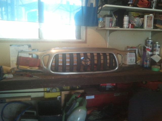

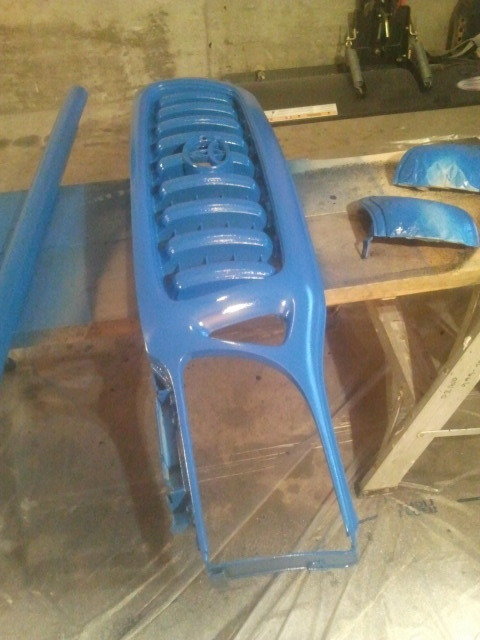

    Prepped the grill and flares for TPO adhesive promoter.
    removed those side fake vent things in the grill.

    AND WE HAVE COLOR!!!!! keep in mind the center of the grill will be black.

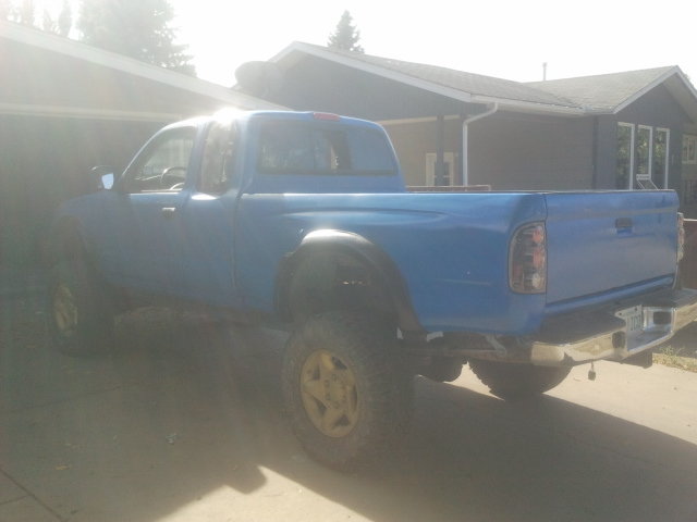

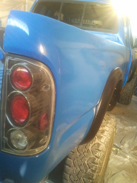

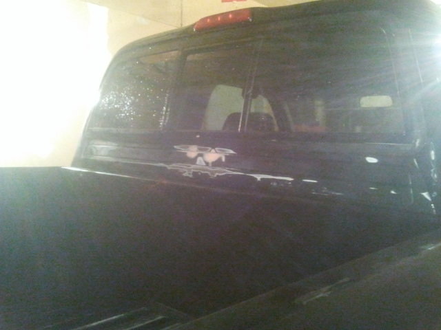

    Me to!!! I have the tailgate Painted to.
    I painted all of the flares with the Bedliner stuff. Its dries to a flat look. So i put a wet coat of Clear on it and its looks awesome!!

    The line in the reflection is where the wall meets the ceiling.

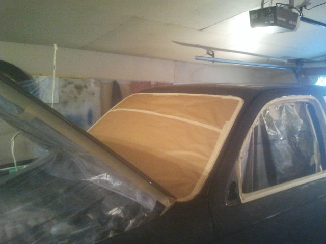

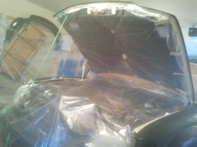

    All taped up and ready for final wipe down
    will proceed to prime tonite!!!

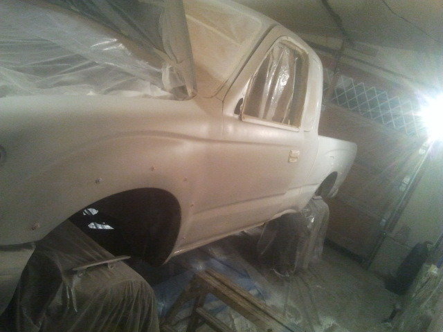

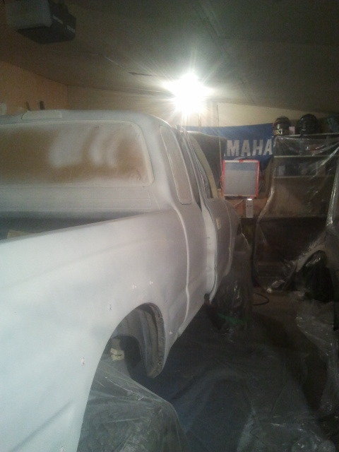

    and one last one of the second coat of primer. Looks kinda cool! flat white FTW!
